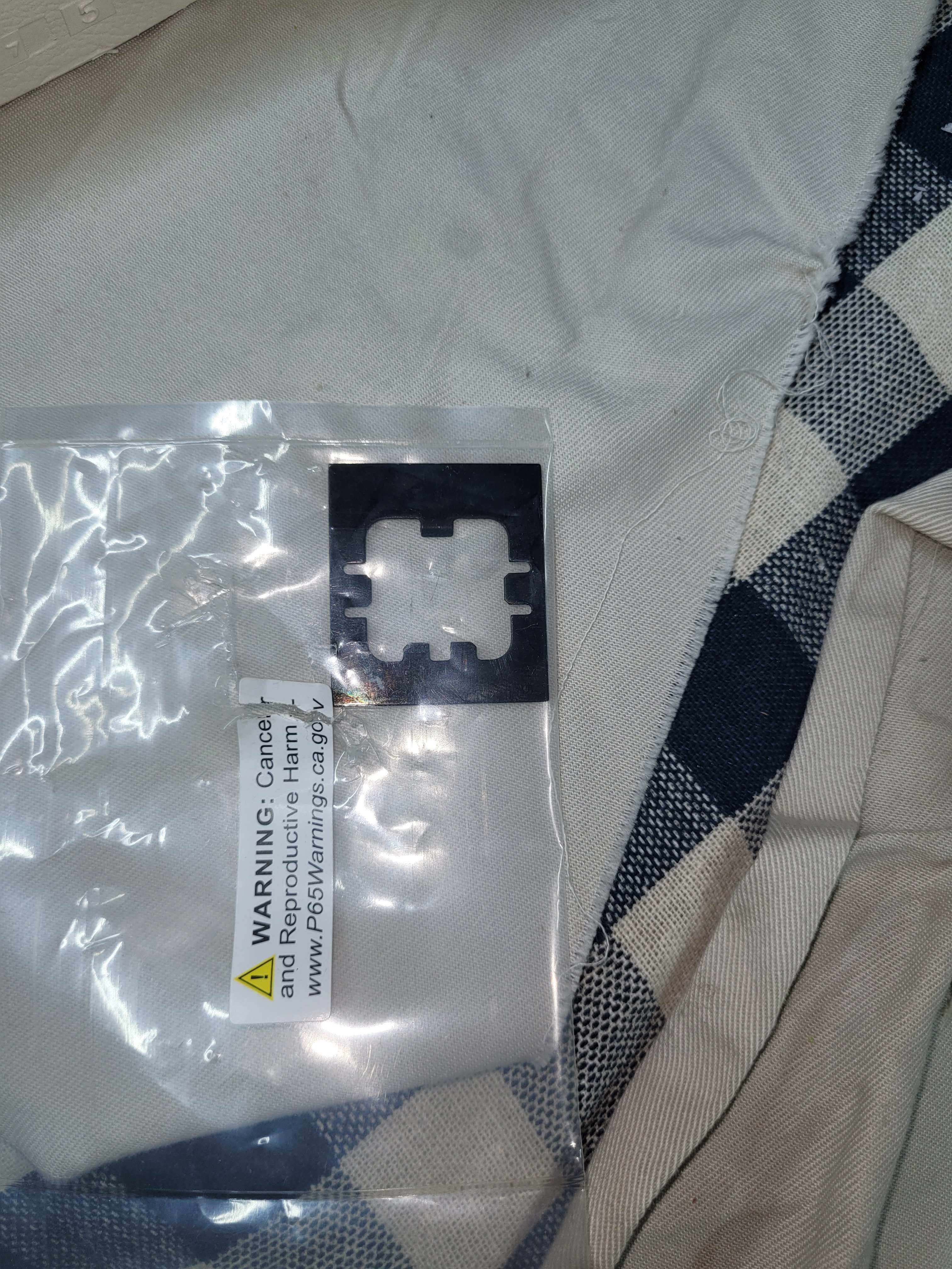

Door panel clip
rs1
Aug 14, 2011
227
9
How does this mount?
Thanks

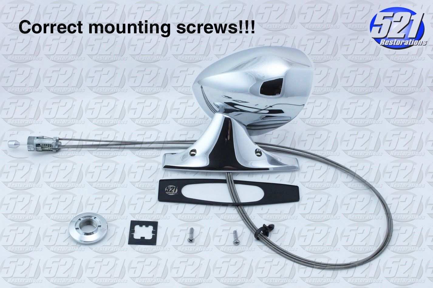

To me it looks like the loose retainer that goes behind the left mirror adjusting joystick assembly on the inside of the door panel. It’s suppose to keep it from spinning when the outer decorative nut is tightened to the door panel.

Thanks,so it slides onto the joystick the put it through the panel and tighten the lick nut
