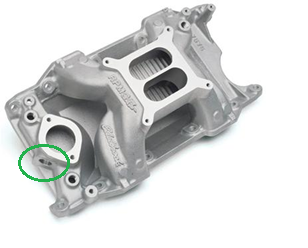

The Chinese knockoffs on eBay look the part of an Edelbrock Performer RPM Air Gap 7576 intake manifold but do not expect the knockoffs to be milled correctly. Also, the knockoffs are milled to fit both Magnum and LA small blocks (vertical intake bolt holes AND angled intake bolt holes) so you have to install cheesy aluminum drive-in plugs (provided) in the holes that go unused. Also, some of these knockoffs are either missing the water pump bypass hose connection threaded hole or have made it straight vs angled. See photo, circled in green for the correct angled version on the real 7576.
And the knockoffs may or may not have your normal accessory locations for the coil bracket, return spring bracket, etc.
Plan on making all of that work on your own. More time wasted.
