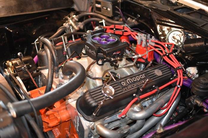

sjd
rogue
May 21, 2013
223
52
unit isn't wired or plumbed yet...
