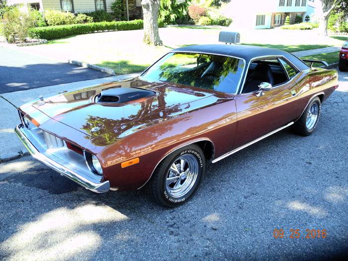

OK, went back to the basics.
Bad battery and loose wire under dash.
Changed out T handle which was worn and neutral safety switch and it started right up.
Thanks to all.

Good deal, glad you got her going again. What was the loose wire under the dash? BTW, very nice Cuda!

Nearly identical to my first car. I would love to get another one.
