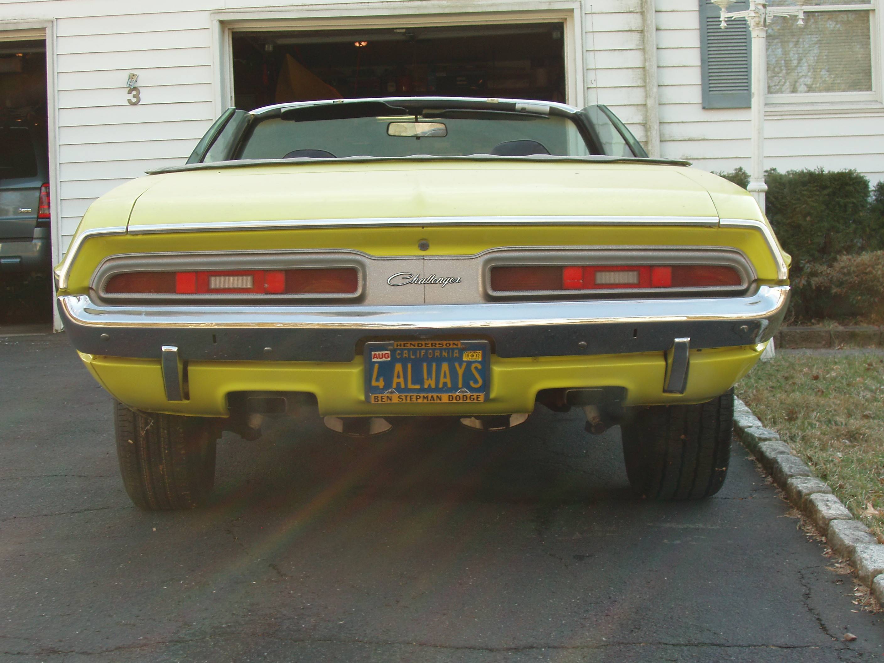

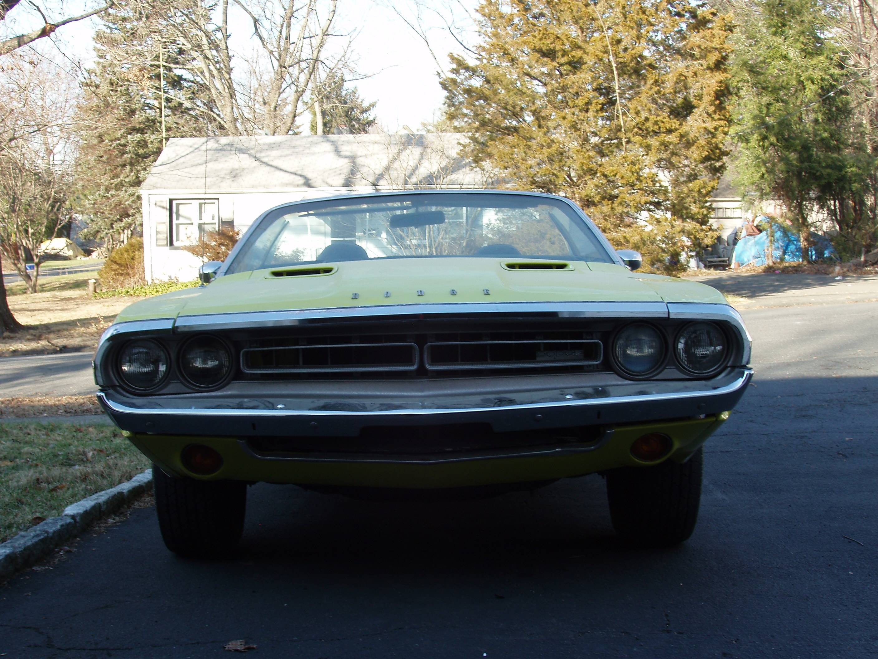

On the other hand, I think it is a perfect example of a really beautiful car! Glad you found the problem and got it repaired.
