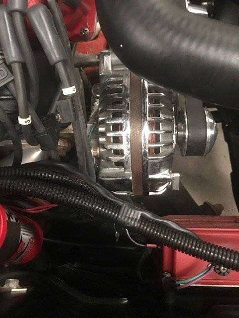

..so I have a few electrical issues on my '74 Challenger - before I chase around to much I just wanted to check if my alternator is a big enough capacity. (I posted this on another forum and one of the suggestions was that the alternator may have been to small)
-All my gauges and lights are dimming / going brighter at idle. - I haven't been over everything to check for bad connections / bad grounds yet (that will be my first thing to do) - just wanted to check first if my alternator is big enough.
-I have had the alternator and regulator looked at and it checked out fine.

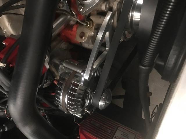

-Can you tell from these photos what the alternator is??? Thankyou!

Other than pretty I can not tell. I would get a colt meter and put on the terminal then see what the true amp output is. I would think the auto parts store is just a go or no go gauge. Remember everything is powered by the battery then your alt charges that sucker. So it does seem your alt is not keeping up with the demand or your battery is about to take poop
