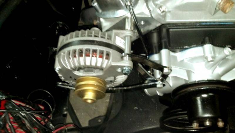

They won't work. If you are not running a serp belt conversion, you will have to fabricate/alter the old brackets to work.
The head is longer than stock, so you need to cut and reshape the bracket to compensate for the extra width of the heads.

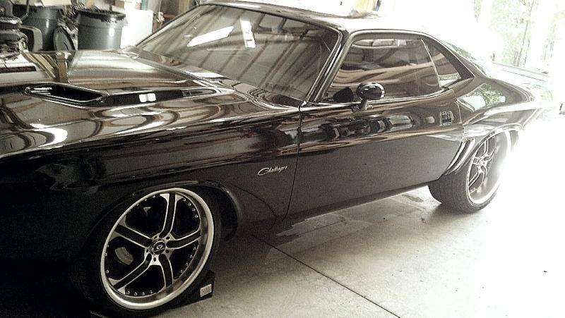

View attachment 16069 ready to hit the road!!!
