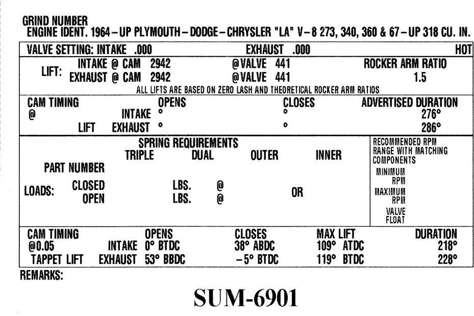

Here's the specs on the cam. Nothing wild. I'm looking to make power from idle to 5,000 rpm's. The oil pump is from Summit and was supposed to be similar to stock. I was told in my racing days that you only need 10 psi of oil pressure per 1,000 rpm's. Since I don't plan to wind it up too much, that will be fine.
