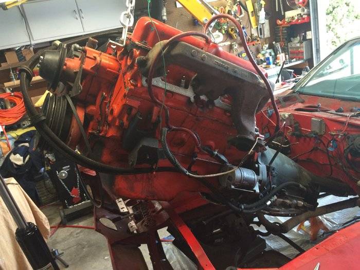

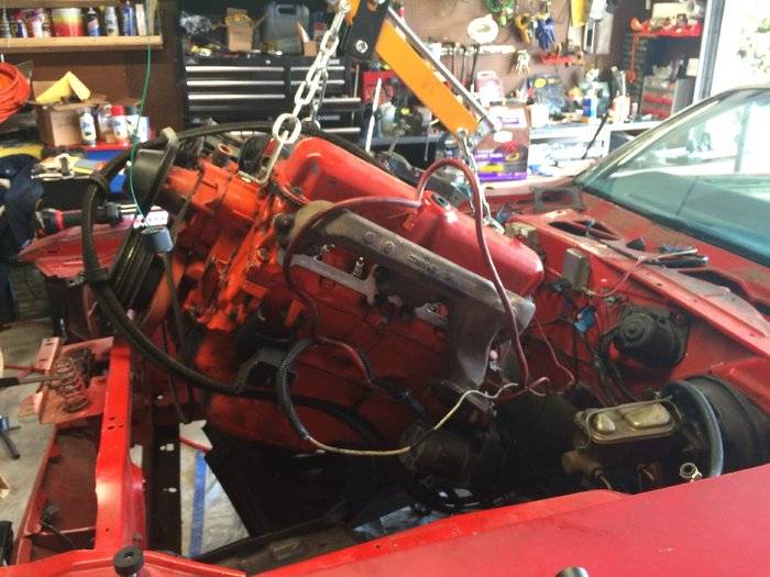

I agree with moparlee, a load leveler helps, also got mine from Harbor Freight. Pulled everything together by myself, in my garage. Also a 340 & 727 trans.
