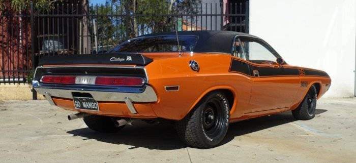

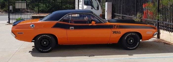

I'm looking to see if anyone here has used ESPOs +1 leaf springs and has some pics? I'm having a hard time visualizing how my 70 Challenger will look with them. Anything helps! Also, anyone had any issues with them?

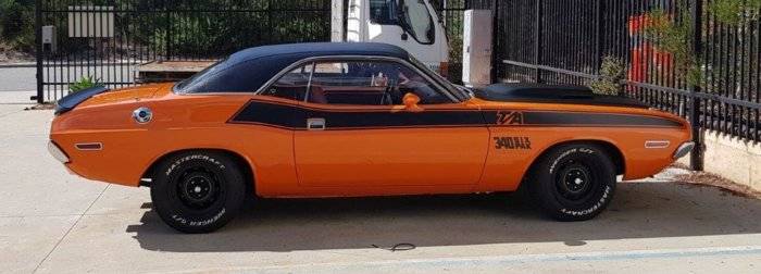

I have ESPO +2 good ride handles the pot holes with ease but that is probably down to the shockies.
From 1/4 tank no spare to full tank with spare Tyre drops the rear about 1 inch
Have not seen a height change in 12 months running 275/50/r15 rear front is set to about 24" Hooker 5115 clear by around 4 1/2" quite important as we have some nasty speed humps here or traffic calming devices as the council calls them
The only issue was i had to repaint they were delivered with that patchy full gloss look.

Wow, I would have never guessed you had +2 leaf springs on her! The car looks amazing! What kind of shocks you running? The photos really help, thank you!!

Thanks,
I am running Gabriel gas the base model around $70 cant remember the P/N
