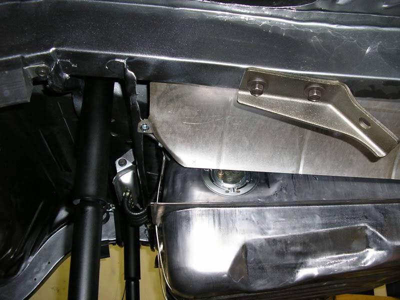

Sep 19, 2013 #1 moparmaniac10 Well-Known Member Joined Apr 16, 2011 Messages 179 Reaction score 4 Location illinois I bought a set of exhaust heat shields and M wondering how they bolt up. Any pics would be great.
Sep 20, 2013 #2 burdar Well-Known Member Joined Jul 10, 2009 Messages 521 Reaction score 30 Location IOWA One fastener screws into the shock x-member. There are two or three screws that attach to the inside of the frame. Finally, the rear of the shield gets sandwiched between the trunk floor and the muffler hanger. Last edited: Sep 20, 2013

Sep 22, 2013 #4 moparmaniac10 Well-Known Member Joined Apr 16, 2011 Messages 179 Reaction score 4 Location illinois Thank you. that helps me a ton. I had to order the exhaust hangers so I can finish it and get it off to the exhaust shop in 2 weeks.
