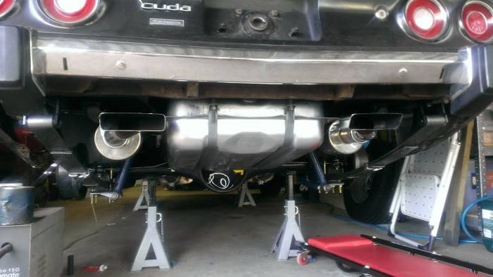

I have a 2 1/2" Magnaflow system with a pair of 6x6 magnaflow mufflers either side of the gas tank, it is kind of quiet but barks a little when stood on.
