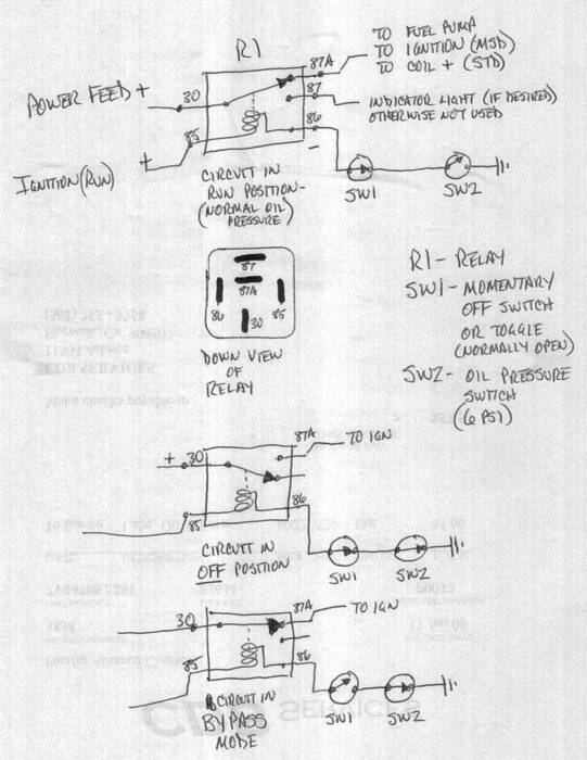

I designed a shutdown system that works off of the oil pressure idiot light switch to kill the car's ignition and, more importantly in the case of a wreck or roll over, the electric fuel pump. Bad enough to wreck the car don't want to wake up in the burn unit too. (see pic)
Lost an engine to a backed off rocker shaft bolt that dropped the push rod and ejected a lifter. End result; no oil pressure making 7000 RPM shifts, poor thing developed a rod knock.
