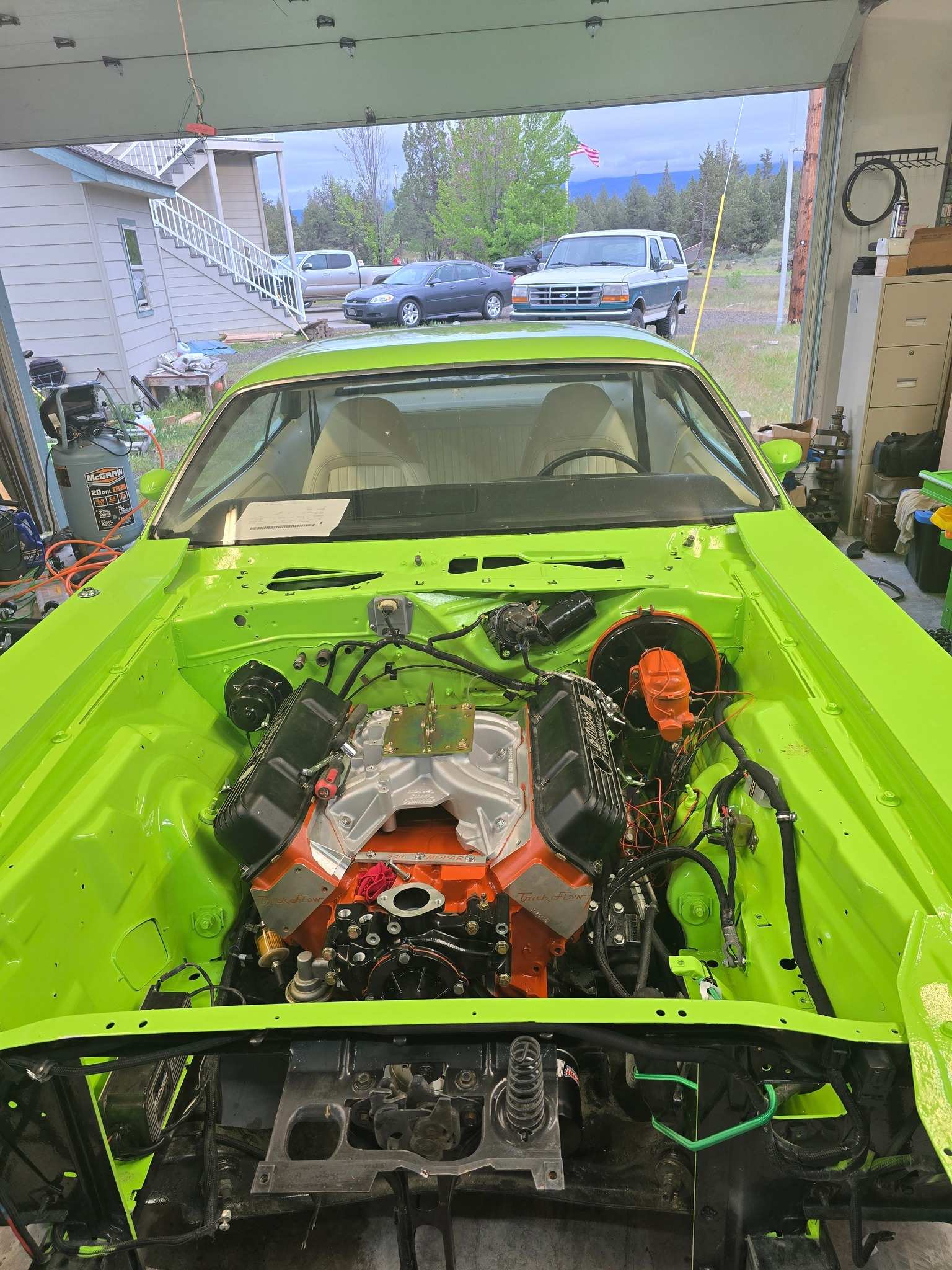

Getting a little closer every time I get some time off work. The wrist pin got shipped out the same day I called about it, but USPS lost it and it took 2 weeks to get here. Used that time to do some other prep work, built an 8x24 multi-bay chicken coop (www.therustedroostfarm.com if anyone's looking for hatching eggs!), and covered a bunch of shifts at work. Hanging out with the dog drinking coffee right now, and hoping to get the heads on and valvetrain set up today!

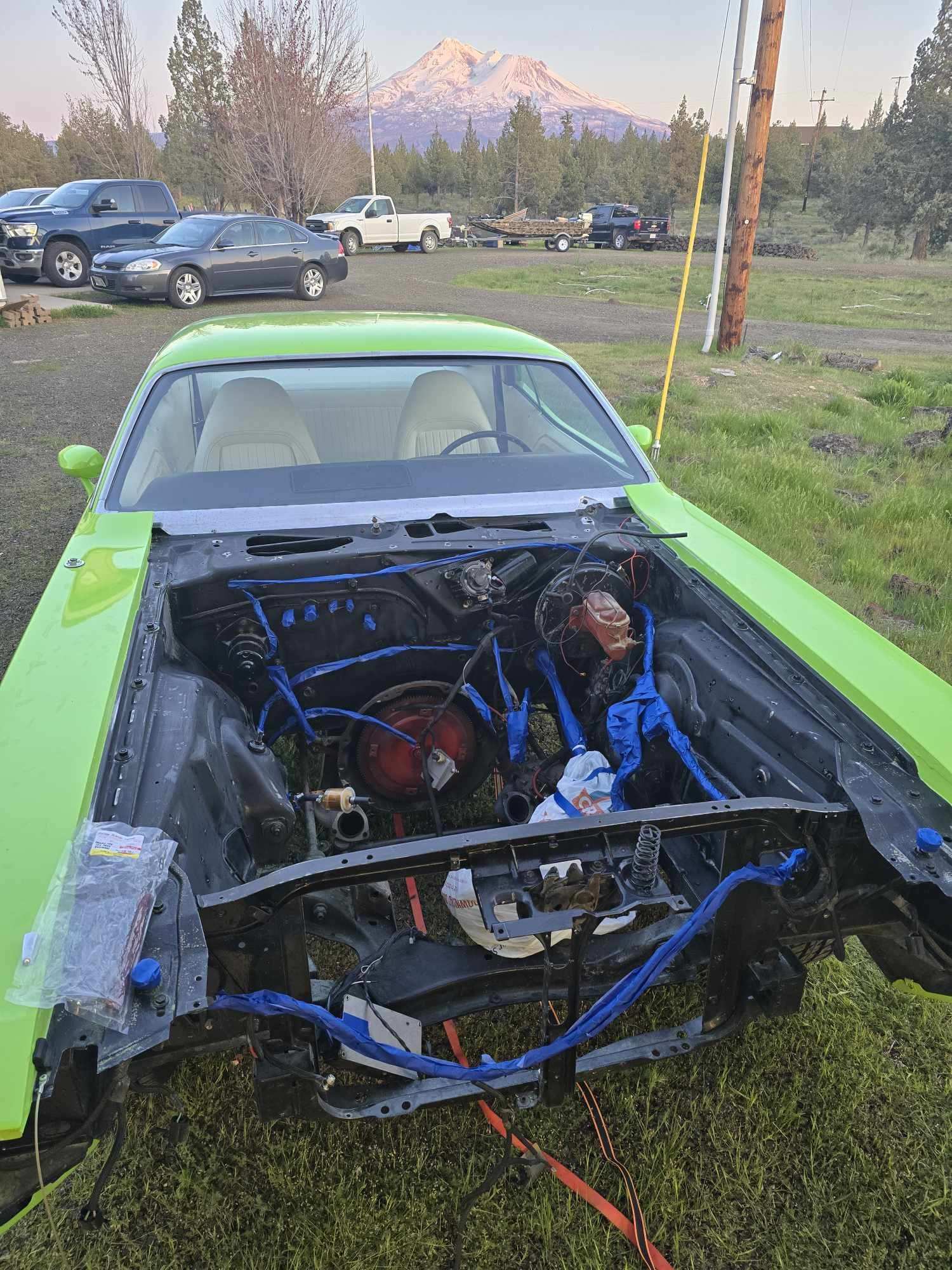

Corrected the paint under the hood last weekend.

New paint under the hood always makes it look better. Especially High Impact paint. Always money well spent.

Hard part's done, now to put the torque converter in and hook up all the accessories. I am REALLY REALLY REALLY glad I decided to take the time to paint the engine bay. I almost didn't, because there was a big show and cruise last weekend I wanted to go to, but it came out freaking great. Very happy with it so far. Now, if it'll only run and without leaks, and without eating itself, when I get to finish it up and fire. :D

Yup, doing everything in the engine bay ahead of time is way easier now than later. Looks good :thumbsup:

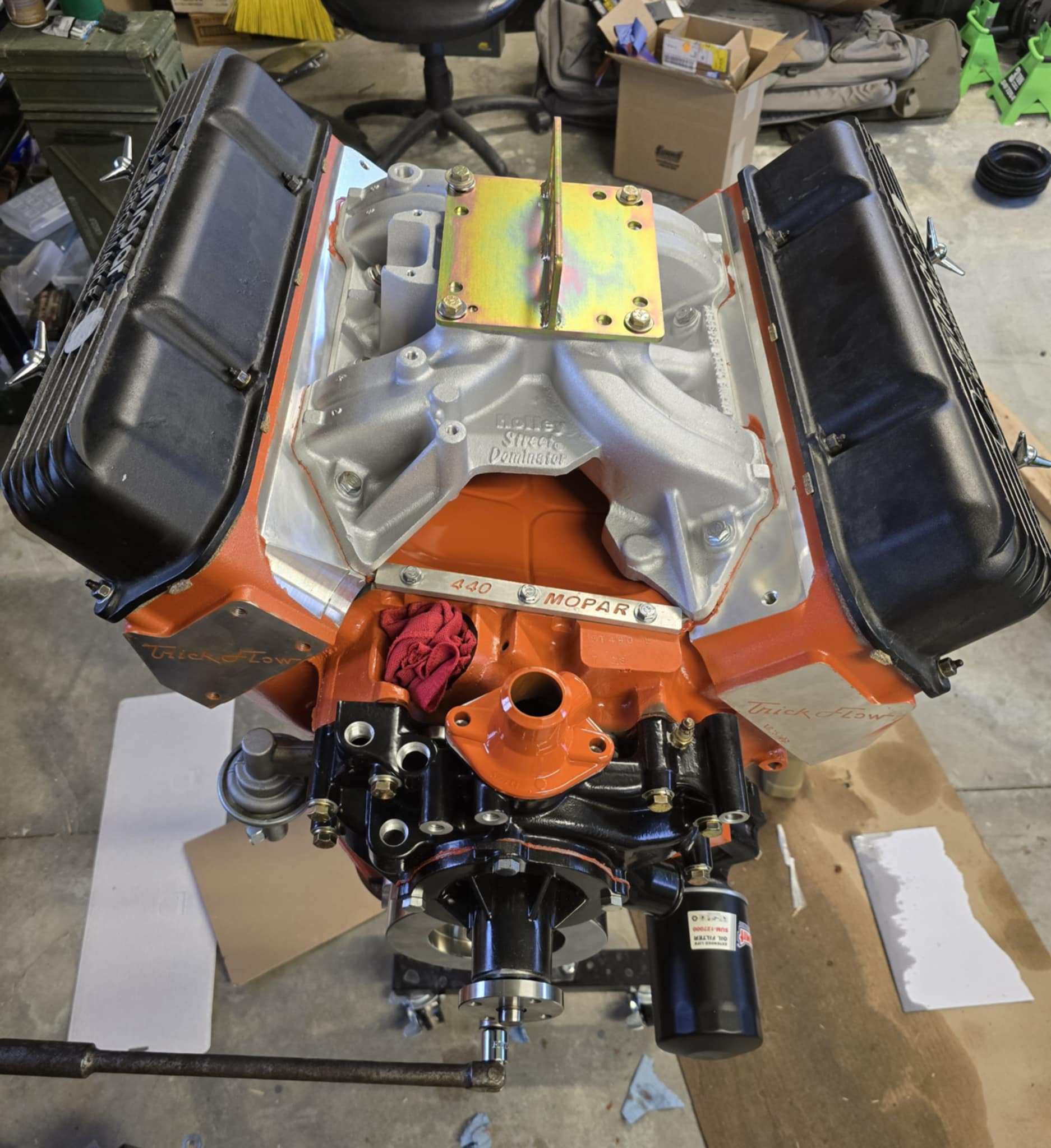

I love that intake! It gets my vote as the ugliest and most effective intake for the RB Mopar! I own three of them! 😁

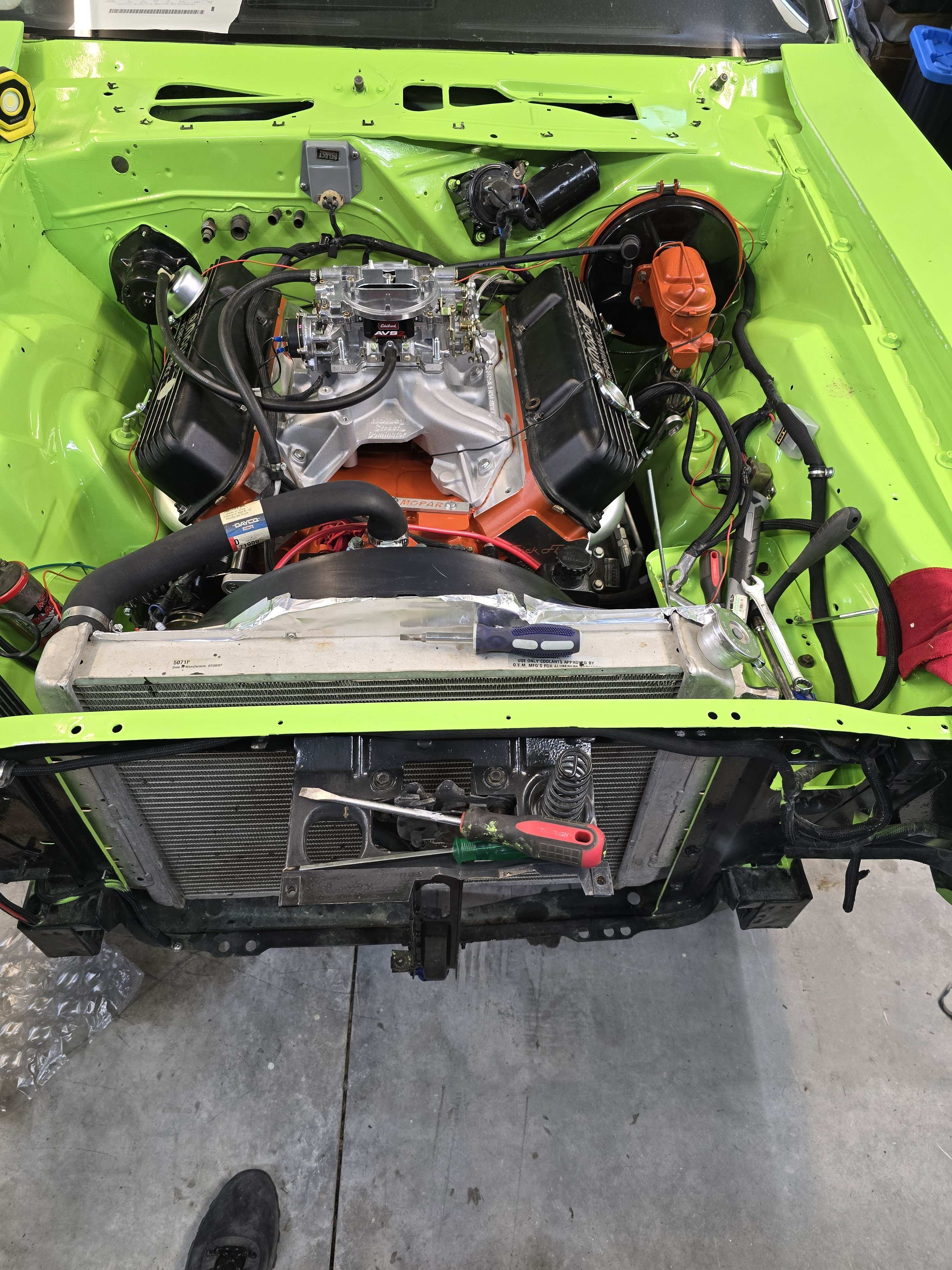

Almost there. Ran into dumb things today (couldn't find fuel line clamps. Went and stole some off the Barracuda. Found them immediately after. 🙄🤣) and had some household stuff come up so didn't finish, but... VERY close.

Is the top radiator hose kinked just above the thermostat?
Yep, good eye. It's coming back off, that's one of the dumb little things I came across. It's off the old motor and wasn't kinked then (or maybe it was and I didn't notice). The t-stat housing is also smooth, no flange for the clamp to lock into which I feel is weird and likely to come off so I'll be replacing it as well. Once I get it up and going, I'll clean up the wiring, upgrade all the fuel lines, and get rid of the aluminum tape around the radiator as well. That's from when I was messing with the old setup to see if I could cool it down some and shroud to radiator fitment isn't the best.

Primed oil, 25lbs of pressure with drill. Filled carb bowls and lines, double checked wiring, stuck distributor in, wouldn't seat... 🙄
With the Trick Flow heads the valve covers are touching the distributor body so I'll have to do some grinding to fit. Worked fine on the old engine with 915 heads.

That AVS2 will work very well for you. I also see you're using the Lokar throttle & kickdown cable system. I've used that setup on 3 of my Mopars and has been great. So much better than trying to find OE style brackets & rods and making them work with aftermarket intakes. I see the carb studs are quite long which would be great if you ever need to put on a spacer to keep heat away from the carb body. The fan/shroud you have should work great for highway cooling. Hope you have enough cooling for low speed or stuck in traffic. I had to go to electric fans to deal with the low speed cooling. With my mechanical fan & shroud I would stay around 185 (180 thermostat) while at 70/75 on the highway. With electric fans the temp runs much higher due to the shroud the fans are mounted on actually impeding airflow at higher speeds. Wish there was another solution, but it is what it is.

I liked the 650 AVS2 on the 440, this 800 should work out well. Long studs are for a spacer, I'll sort that once I have the hood on. I used a half inch spacer on the 440 and will use as tall as I can fit with this intake. The offenhauser was a little taller than this Holley. (It will also be available for sale if anyone needs one). Been using the Lokar cables on everything forever, way better than stock stuff.
The fan and shroud setup worked fine on the 440, it stayed under 205 while idling in the shop on hundred degree days last summer...Will see how it works on this setup.
