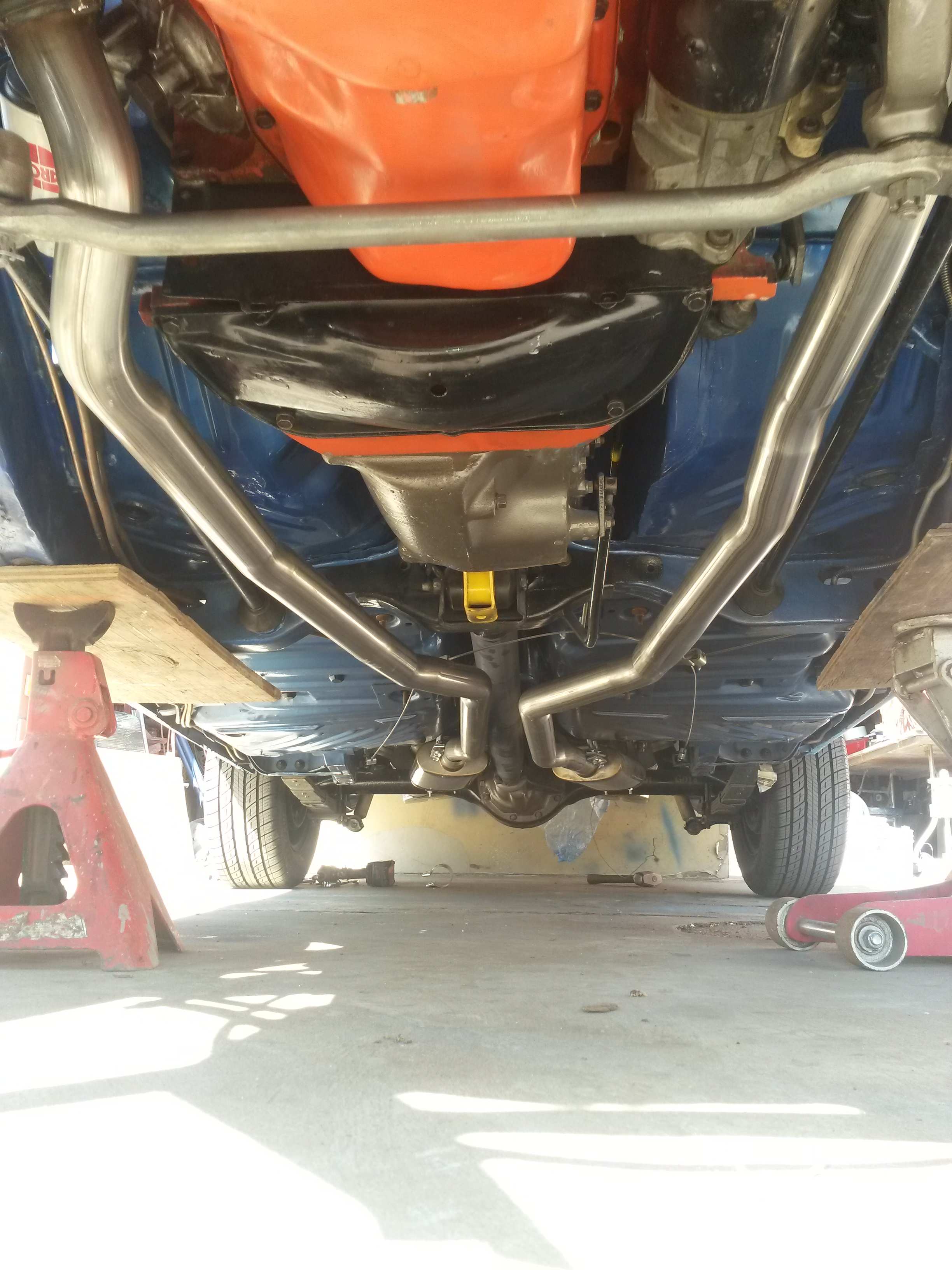

Thank you. I actually just bought one of those Harbor Freight digital micrometers for $20. That will be a good exercise for me. I don't have the engine in but it also looks like the idler and pitman arms are pretty much parallel.

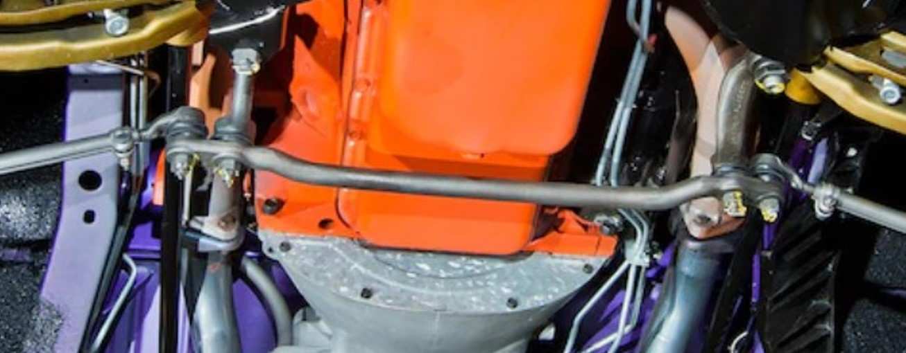

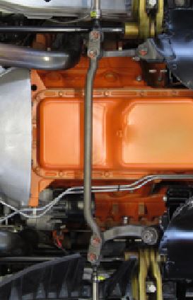

A few more pics of the draglink a.k.a. centerlink orientation.

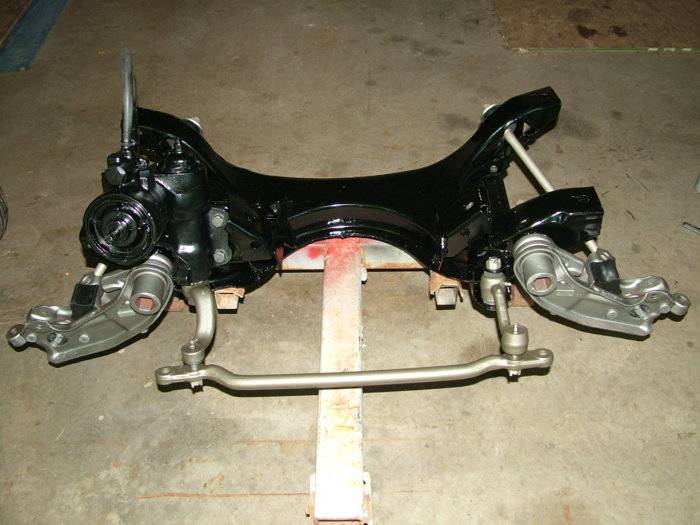

Thank you, I think I blundered into the correct installation but I want to try my micrometer to see the taper. My alignment guy talked about the taper but I though it was just the threaded part and not the hole. What is that natural finish you put on your parts? It looks great. Thanks again.
Cast-Iron Gray for the draglink (centerlink).
You can glass bead it and spray satin clear to protect it or spray it with Cast-Iron Gray.

You can always powdercoat your suspension pieces. Almost all of my suspension pieces are powdercoated in gray or satin-black. I had everything done back in 1999 by Performance Coatings in Jonesboro, GA. At that time, it was $200 total to do the entire K-frame, upper/lower control arms, strut rods, sway bars, brake spindles, brake backing plates, entire rear 8-3/4" axle housing, and all of the bolt hardware. The owner had corporate contracts to pay the bills and catered to hot rodders/car guys at ridiculously low prices. Full blasting/beading, coating, and baking at today's prices would be extremely expensive.
