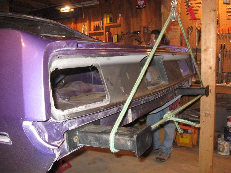

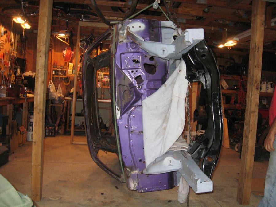

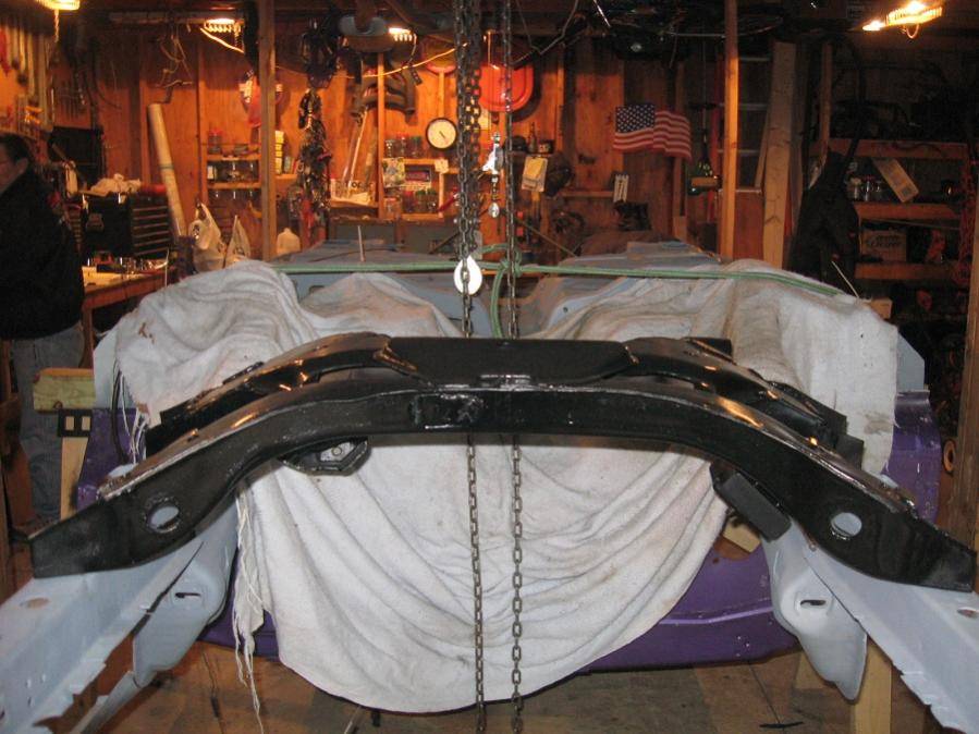

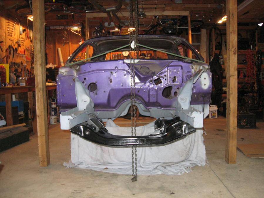

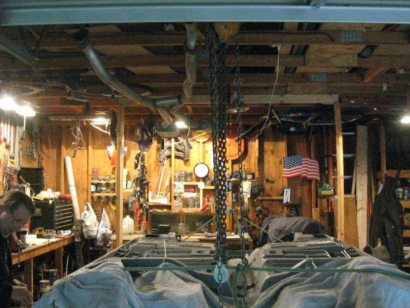

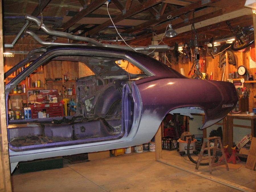

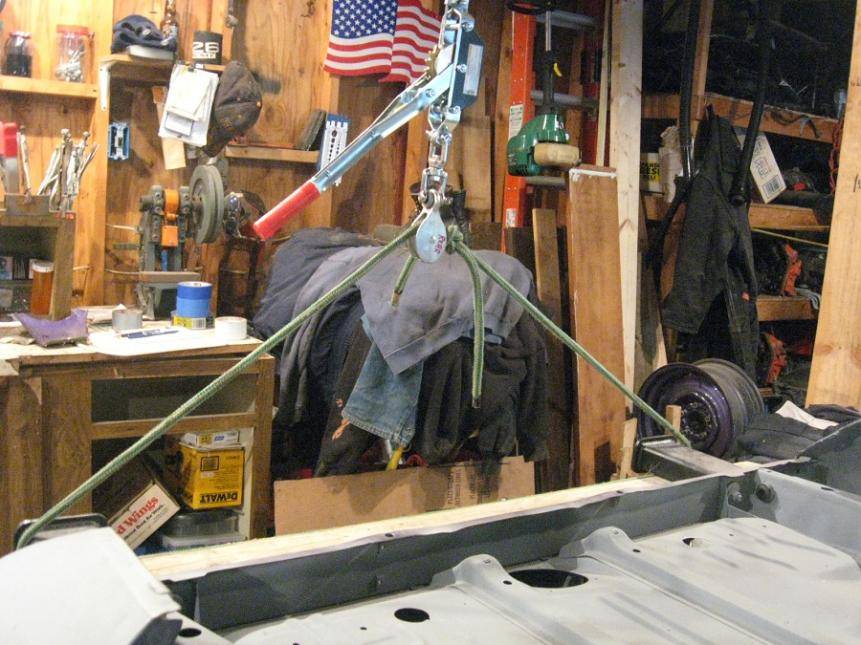

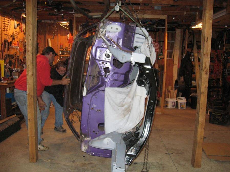

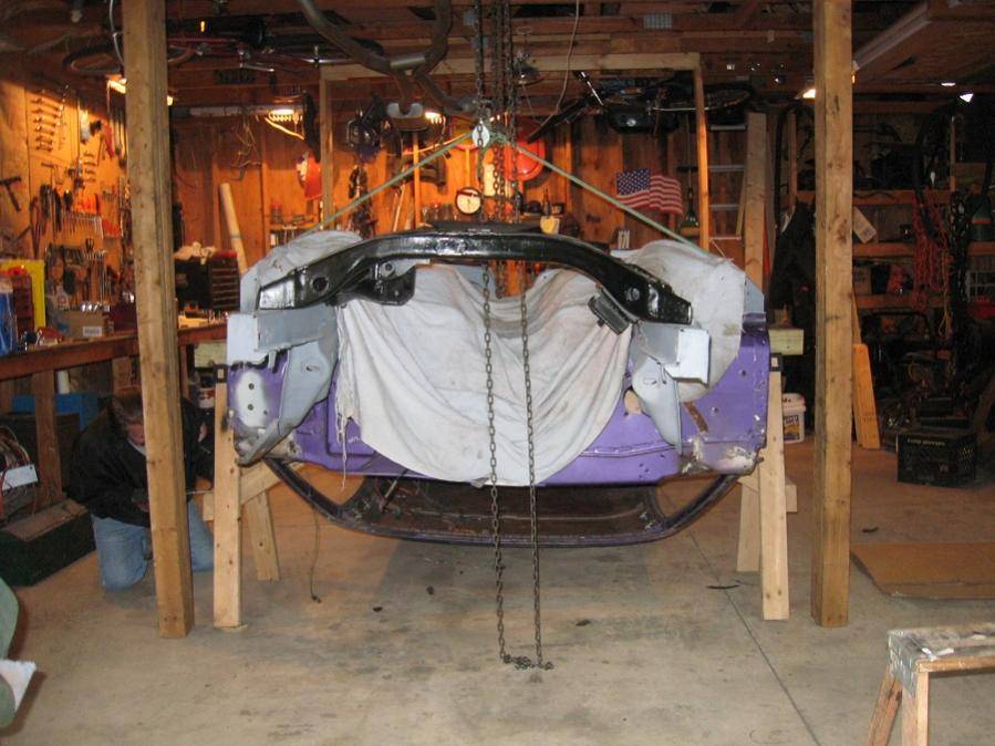

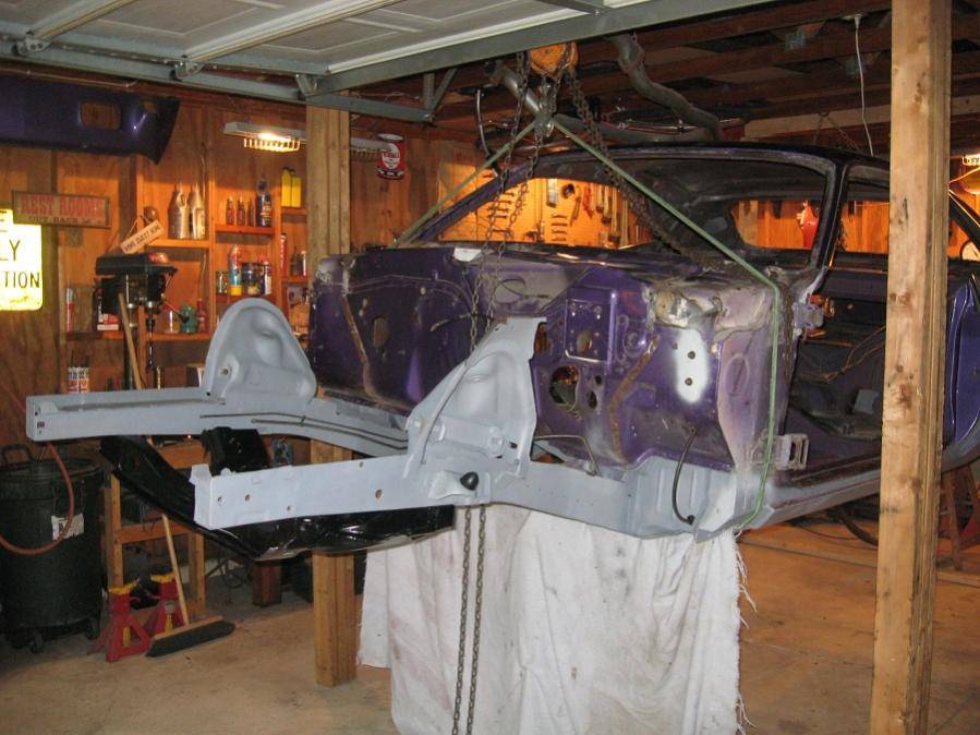

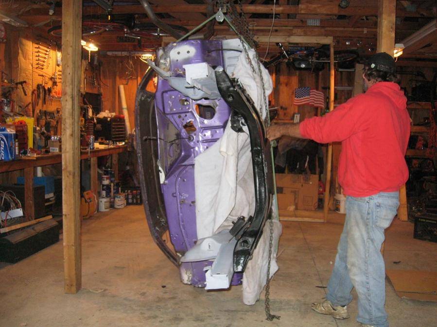

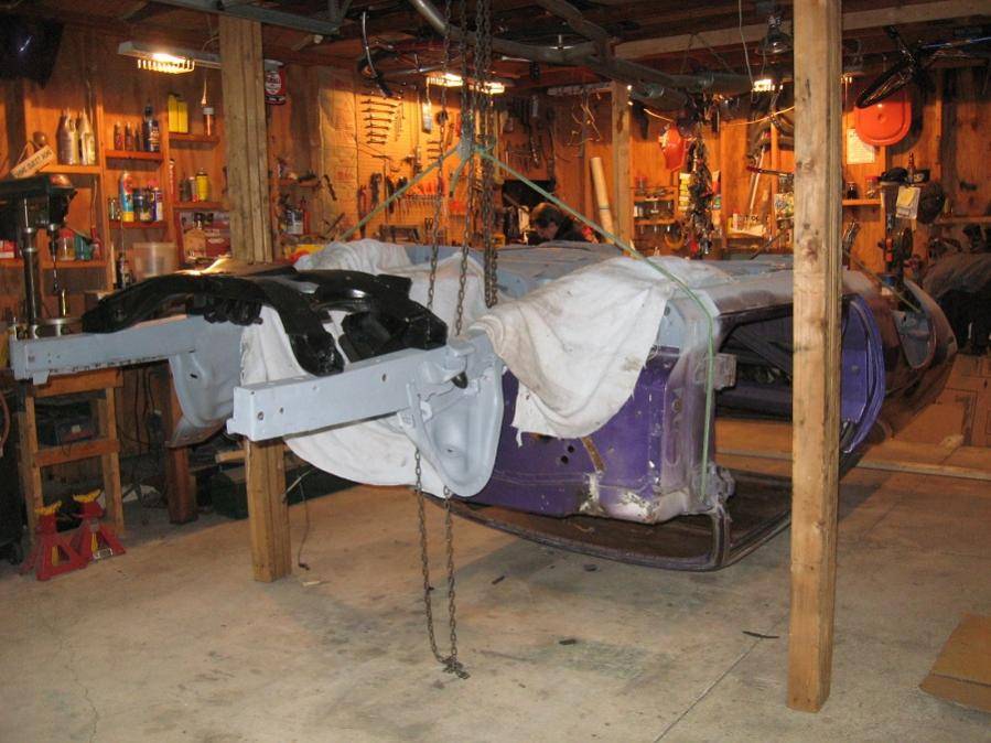

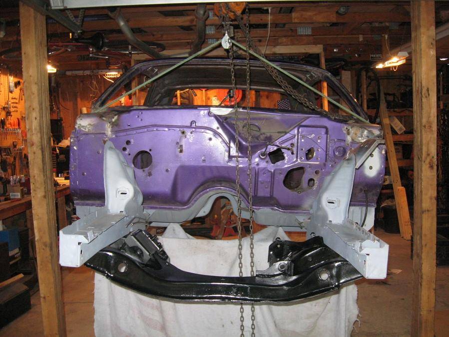

Oct 1, 2011 #22 heybird426 Well-Known Member Joined Aug 16, 2010 Messages 45 Reaction score 0 Location cleveland ohio Ok the the car is flipped back over and Im ready to start working on the fenders and then the motor (HEMI), here's how I flipped it........
Nov 26, 2011 #23 B Benji Guest So from what I can determine you used two chain hoists one fore and one aft that were attached to two rope pulleys and the ropes slipped through the pulleys as the body was turned, correct? Benji
Nov 26, 2011 #24 DetMatt1 Well-Known Member Joined May 13, 2009 Messages 8,124 Reaction score 2,239 Location Metro Detroit That is awesome, good job!
