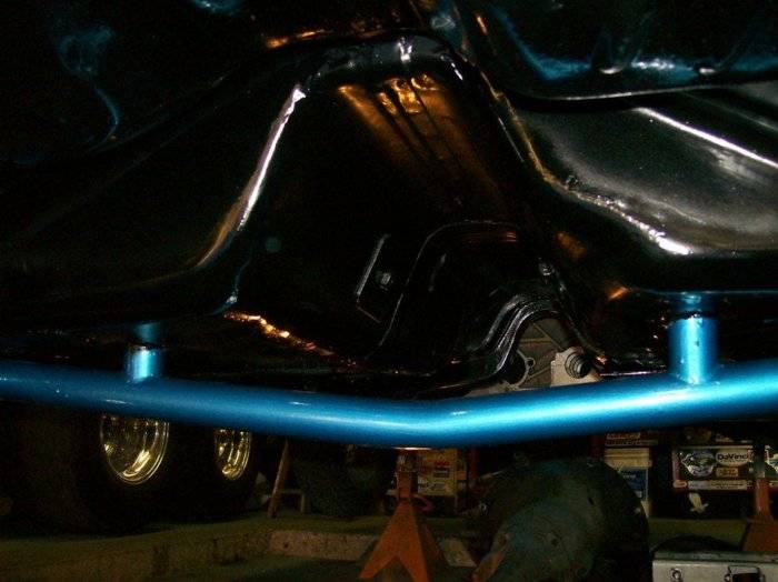

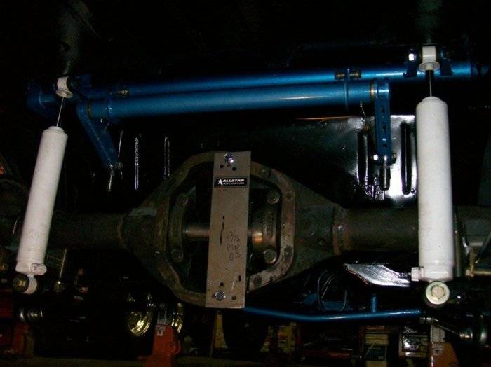

6PKRTSE
Feb 3, 2010
982
567
We made all custom tubular frame connectors and under car bars to tie in the cage on my car. Also relocated and mini tubbed.
