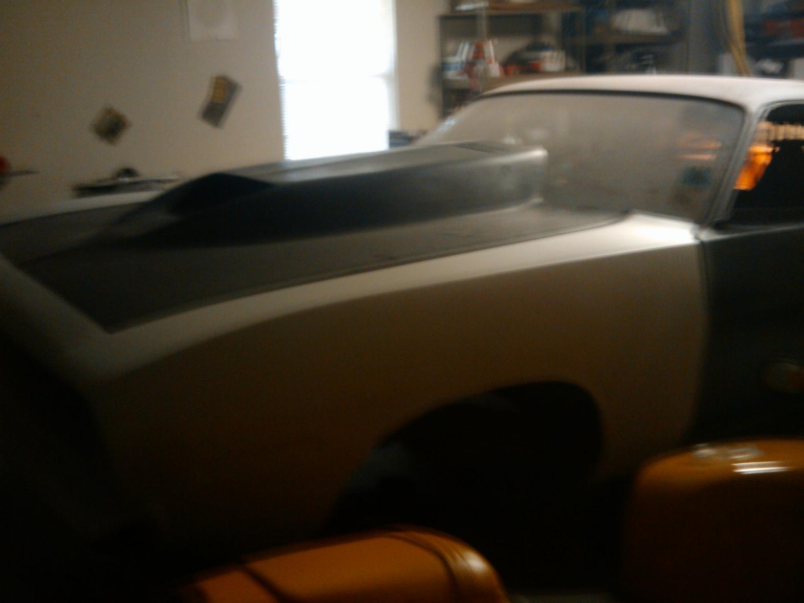

Plugging right along on the Cuda Project and ran into a snag. Does any one know what the correct Height for front frame rails on a 1972 Cuda should be? I am replacing the radiator support's, (upper & lower) and noticed that the drivers side frame looking at it from the front dead on is 7/16ths lower than the passenger side, when the upper support bracket is set in place, its noticeable lower on the drivers side.
Any help would be appreciated.

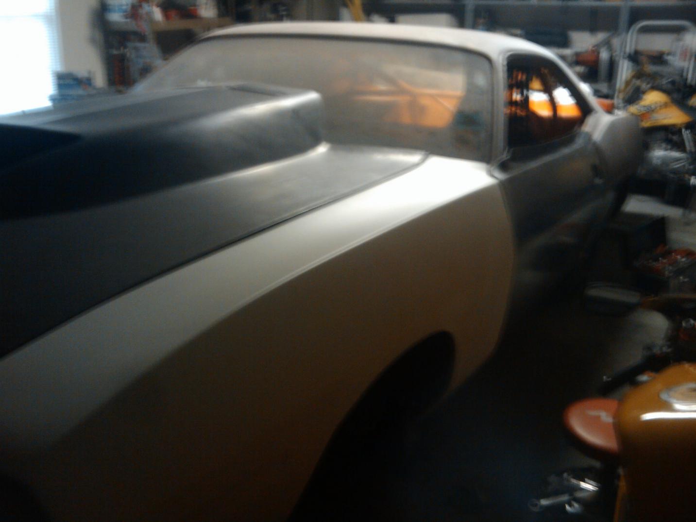

Robert thanks for replying. To be honest, I haven’t touched the car since I posted this. I received my front clip from Canada, "Show Cars" (which I don’t recommend any one purchase any thing from this place, that’s another bad experience for another topic some day), any who, to confirm my measurements, with the front clip sitting on the radiator support bracket and the door in place, the drivers side by the head light is lower, as well as a giant seam at the top of the fender / Door area, almost an inch.
Any measurement you can send me would be of good use when I get start on it again. I have attached a few cell phone pics of what it looks like now. I have the front end propped up under the front almost an inch off the radiator support to see what it should look like.

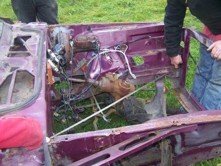

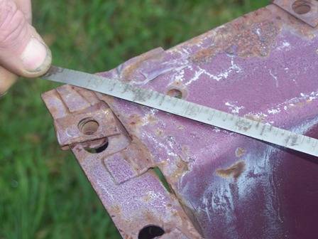

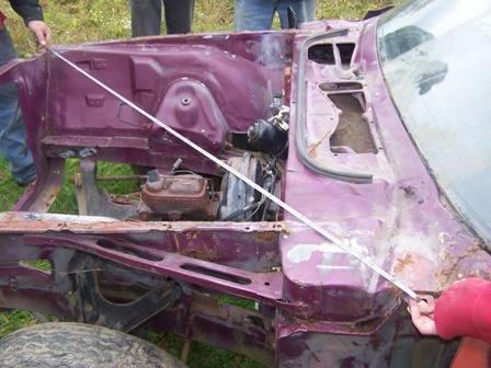

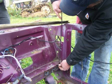

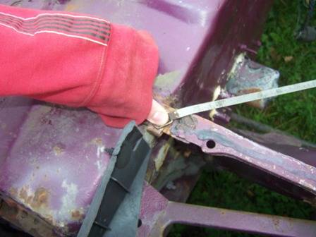

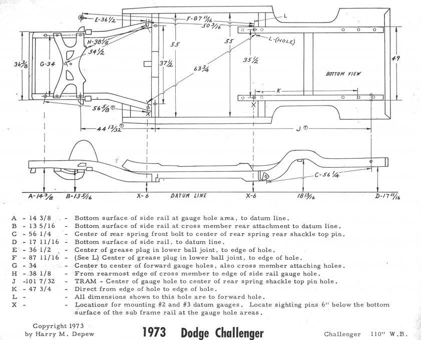

Was finally able to get up and get some measurements. Took some squares and some measurements. I can get you more, if you want but here's some baselines:
the first two photos show going from the very rear fender mount to the control hole on the inner fender: this was 6 feet 3 1/2 inches square.
the next two show going from the rear fender mounting hole on the inner fender to the furtherest corner of the inner fender/front frame rail/core support. This was 5 feet 1 inch square
The last one shows a flat edge laid across the top of the cowl to the topmost part of the core support. Measuring down to the frame rail on both sides this measured at 1 foot 3 1/2 inches.
I'll be going back up this week with the jack to get under the car and do some tinkering before it gets covered for the winter, so if you want I can take some square measurements from under the car, too. It'll be harder to get pics, but I can do it.
