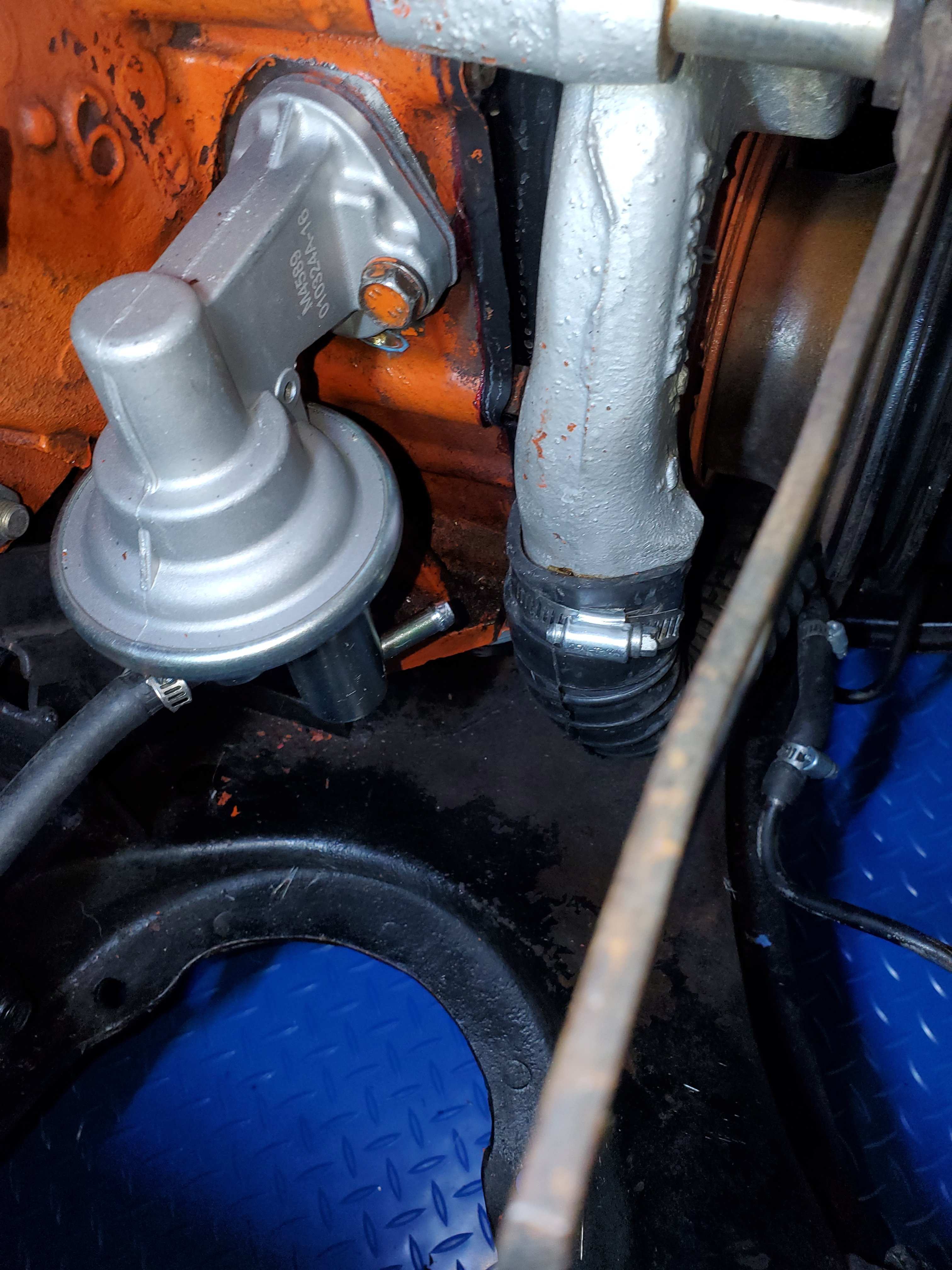

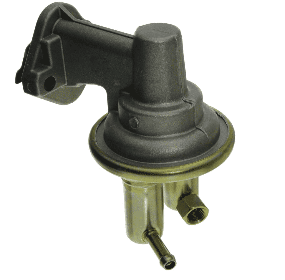

I have the Carter 383 fuel pump , the 5/16 outlet points right at my radiator hose , do they make a push on 90 degree adapter for these so I can direct it the opposite way .

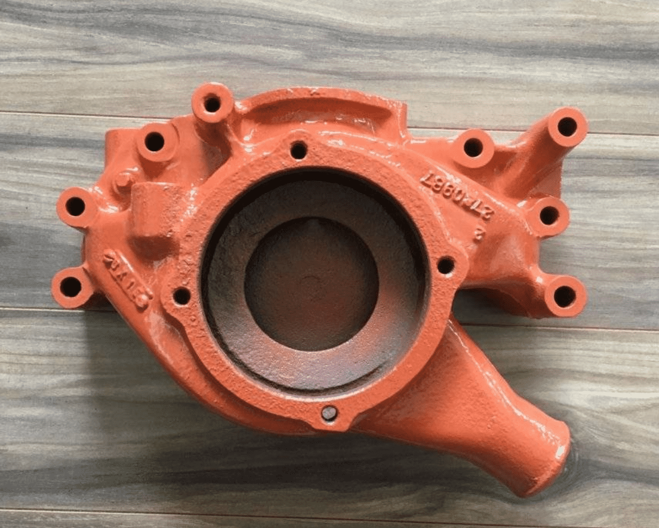

The Carter M4589 on your 383 is the correct style for a 1969-1971 383. However, your engine has the 1974-1978 water pump housing which has the inlet on the passenger side that interferes with that fuel pump outlet line routing. A 383 originally had the water pump housing with the driver side inlet, used on 1958-1973 big blocks, such as the one in the following image:

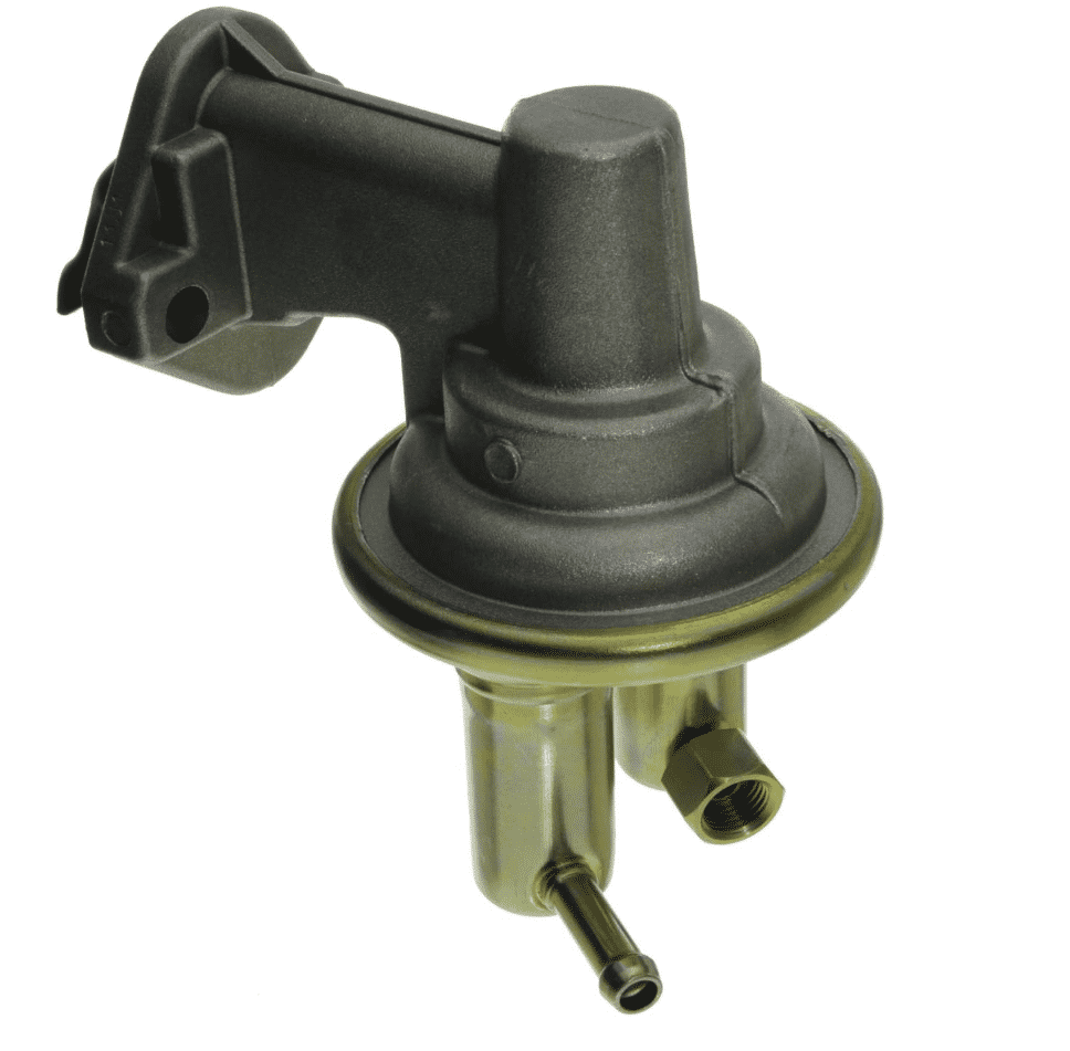

To keep the housing without fuel line interference and without using adapters, use a pump from a 1974-1978 400 application and matching outlet line, such as the Carter M6935 shown in the following image:

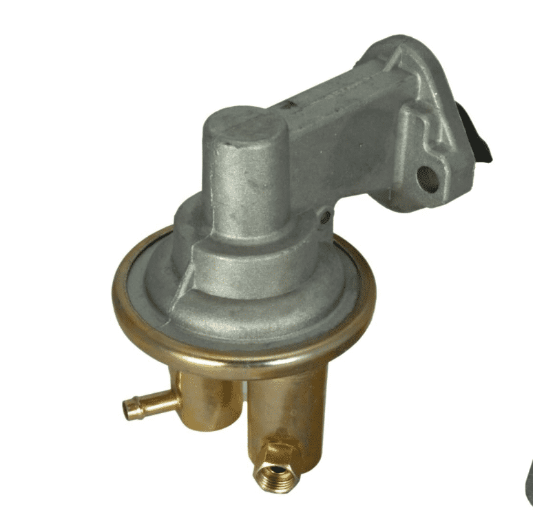

Alternatively, use a pump for a 1968 and earlier 383 application such as the Carter M3672 shown in the following image, although there is a little less clearance with this one than the M6935:

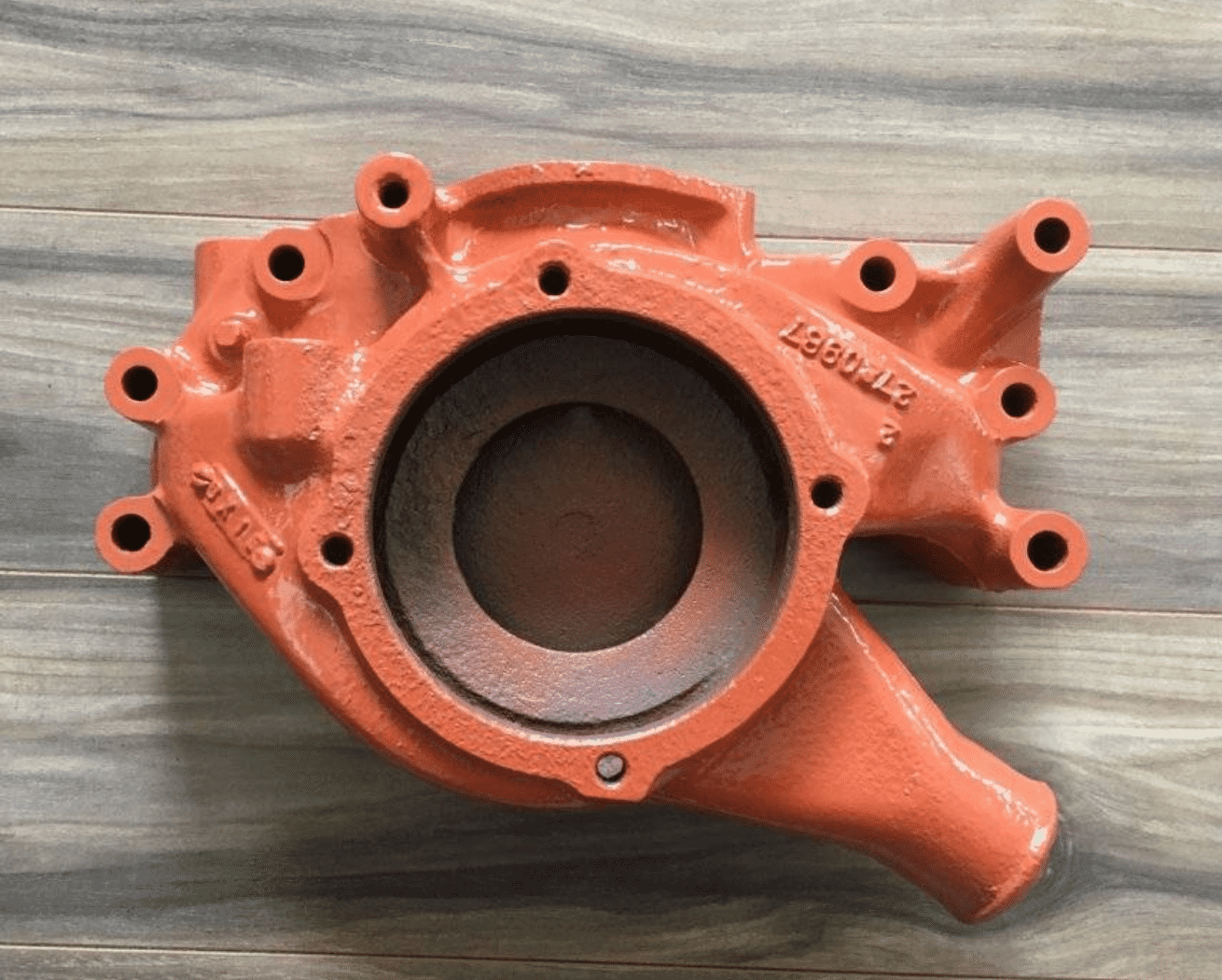

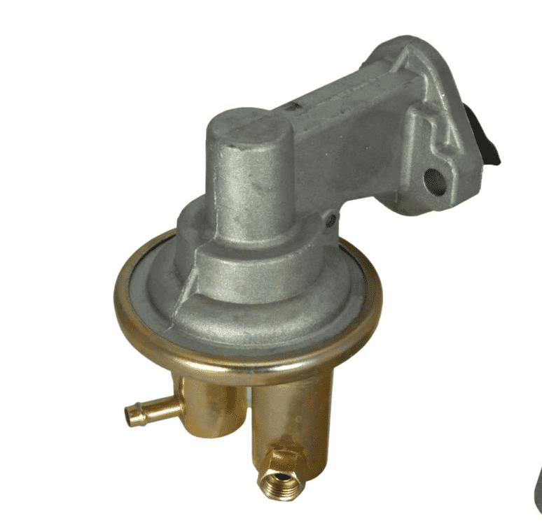

I have heard about those but does the psi matter , I think the one I have is 6 psi and the others at 8 psi , if I'm wrong let me know , I'm still learning .
PSI does matter, but the range of these pumps is within stock specifications for stock type carburetors.
Carter specifies the fuel pumps as follows:
- M6935 at 4 - 7.5psi ( Carter M6935 ).
- M3672 at 4 - 5.5psi ( Carter M3672 ).
- M4589 at 4 - 5.5psi ( Carter M4589 ).
The earlier pump is the same pressure as what you have. The later pump is a little higher, but unless your needle and seat is weak, it will work okay. It's specified as a stock replacement for the later 400s with stock carburetors. For an aftermarket high performance carburetor, the pumps will work okay as well. Other brands of replacement fuel pumps may vary a little, but should be close to the Carter numbers.

The Carter 3672 should be good for my 383 then .

You don't really want the fuel hose resting against the coolant hose heating the fuel !
