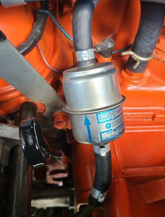

I want to change out my fuel filter. What is the best way to remove these clips from the hoses? TIA.
I just purchased a kit that includes the filter, KW hoses and clamps and I also purchased the correct tool to install these clamps, just not 100% sure how to remove them.I'd be interested as to the "correct way" to do this too. As a backyard mechanic, I use a dykes style pliers and cut them off at the more exposed part that sticks out. Then I install a new clamp. My understanding is you will need the correct crimping tool to reinstall this type of clamp. I was told Harbor Freight has them. Since my car is not all numbers matching and I do not have this special tool, I use standard style clamps.
