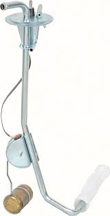

fuel pump pulls" vacuum. pulled pickup tube from tank. the in tank filter is a bag containing filter material. this may be the problem. pump is unable to suck through the material'. memory serves me that the oem filter was a small can like device. solution----remove in tank filter and put an inline filter before pump-------have 5gal. of fuel in tank
