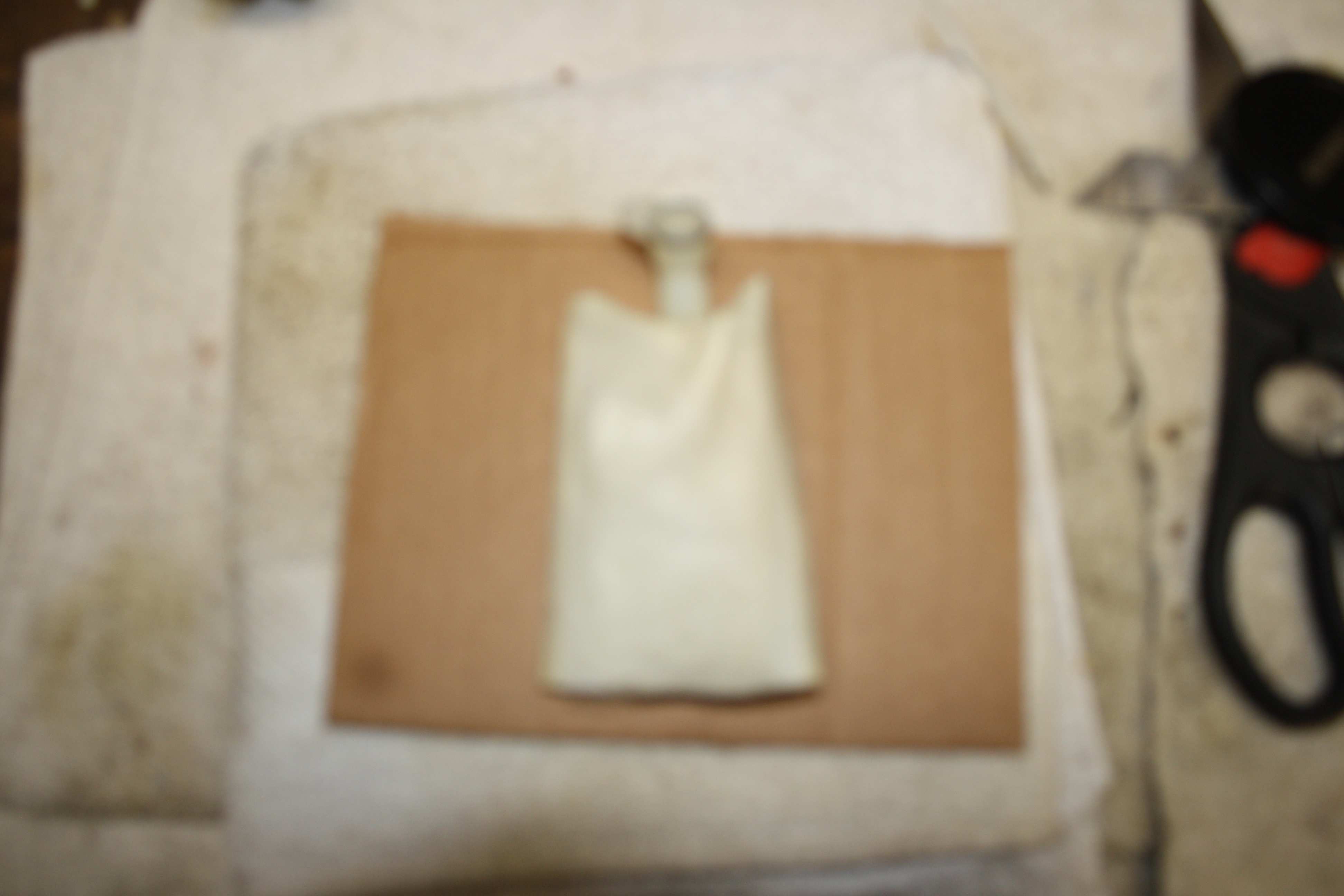

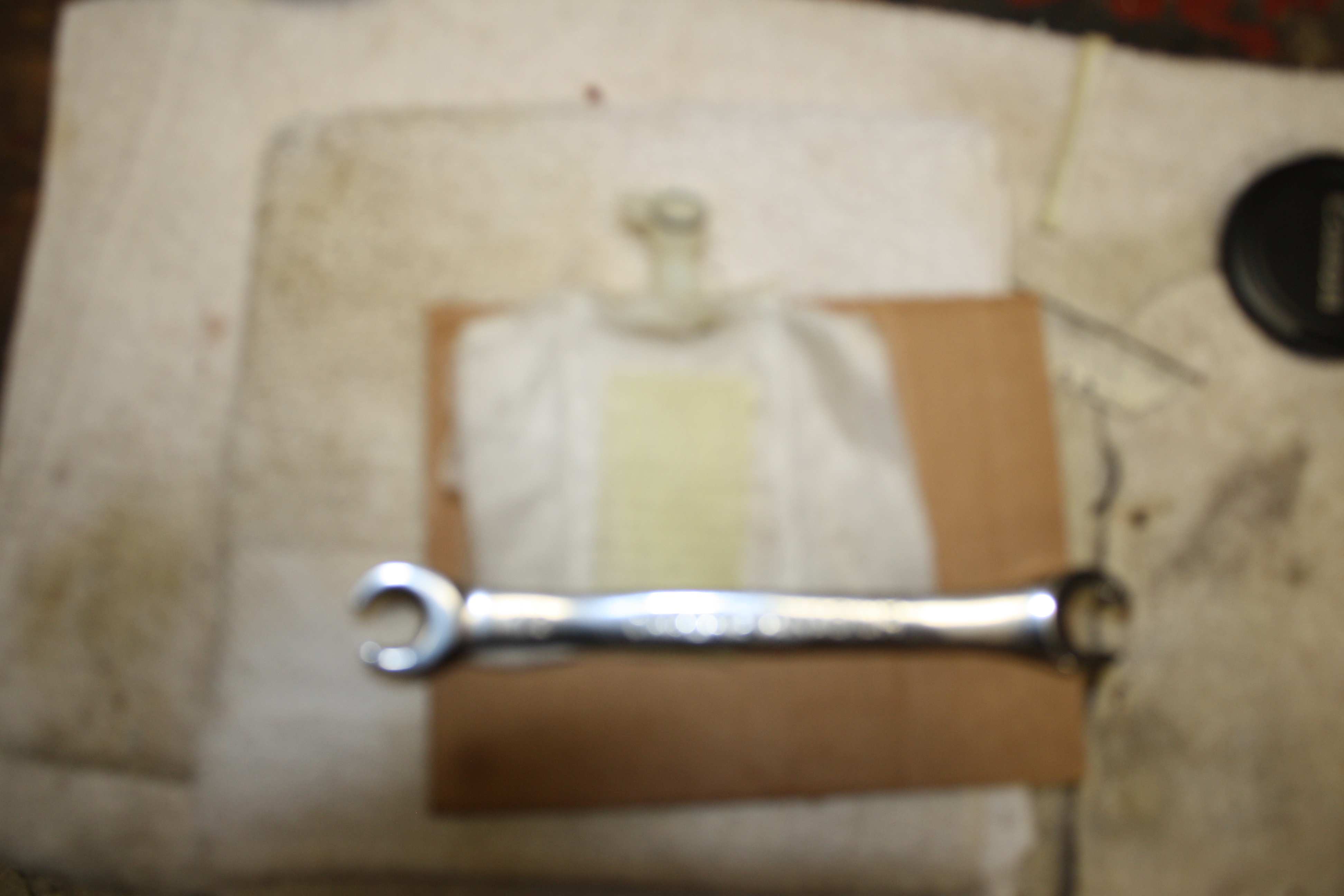

fuel pump pulls" vacuum. pulled pickup tube from tank. the in tank filter is a bag containing filter material. this may be the problem. pump is unable to suck through the material'. memory serves me that the oem filter was a small can like device. solution----remove in tank filter and put an inline filter before pump-------have 5gal. of fuel in tank
this is the reason that there was no gas being pumped to the carb. material is sponge like and it was swollen twice the size when removed out of tank photo on right shows the sponge inside the "filter"

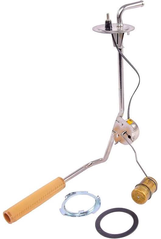

Pumps are designed to push liquid and don't pull very well. So putting a filter downstream will effect it's ability to suck fuel. That's why there's usually a metal fuel filter right above the mechanical pump. The filter on the pickup tube in the tank is really just a metal screen. Some of the cheaper after market pickup tubes use a plastic screen which aren't as good.
I'm not familiar with the filter you're showing that was in the tank. I'm used to seeing something like this.

The copper looking one is made out of metal mesh (brass?). The white one is made out of some kind of plastic similar to more modern submerged in the tank pumps.
