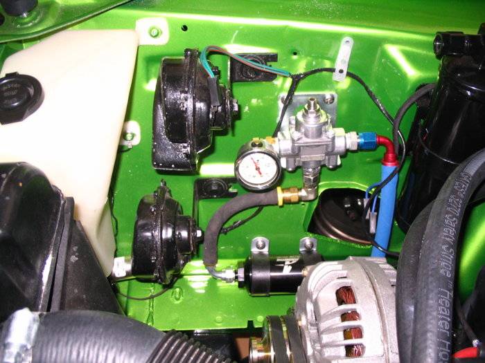

Trying to figure out where to run my regulator for my newly installed fitech kit. Anyone have a pic or three showing where they’ve mounted theirs? Thanks in advance

I think most people mount them on the passenger side firewall or inner fender. I mounted mine on the inner fender. You want it in an area where you can read the gauge with easy routing. With AC, mine was pretty congested in that area but I managed to fit it in.
