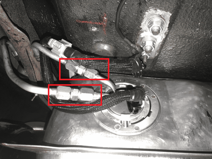

@Cudakiller70 I'm looking to put the same spectra EFI tank/fuel pump in a 74 Cuda. How has it worked out for you?
Also - what are the fittings called in this picture that allowed you to connect the solid line with a the fitting to the fuel pump inlet/outlets? Where did you get your fuel lines from?
