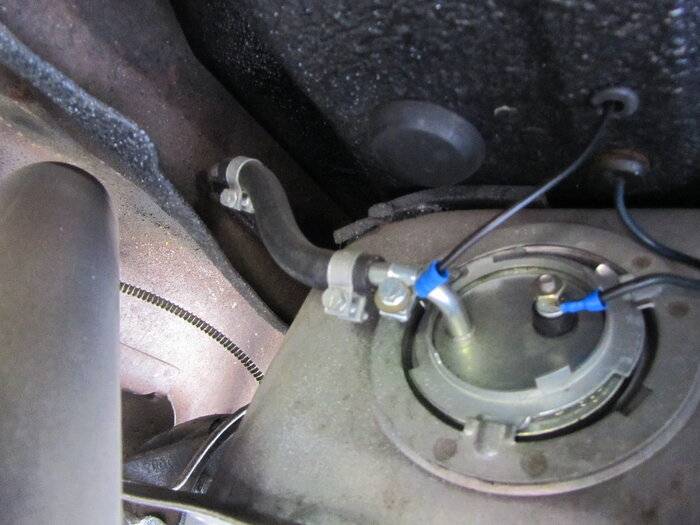

You may try what I did. I took a small hose clamp and attached it to the outlet of the sending unit. From the hose clamp I attached a wire and grounded it directly to the battery. I don't seem to have any problems now. I will try to send you a picture. Year One, sells a grounding strap for the sending unit. I think its about ten bucks.
that did not help. tried it last week .I don.t understand why the old one works fine and the new ones don't? ?? driving me nuts!!

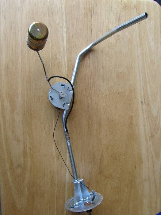

Do you remember what voltages you were seeing when you checked the voltage limiter? I think you should see a pulsating voltage of about 5.4 volts if I remember correctly. The second pic is an internal ground I found on one of the websites. Good luck.

it pulses but I cannot read it that fast :) I ran the ground to the frame cross member
