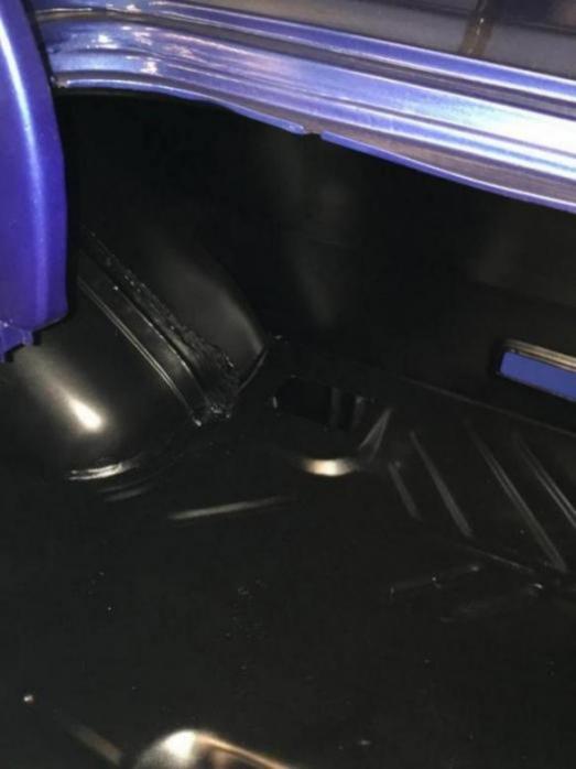

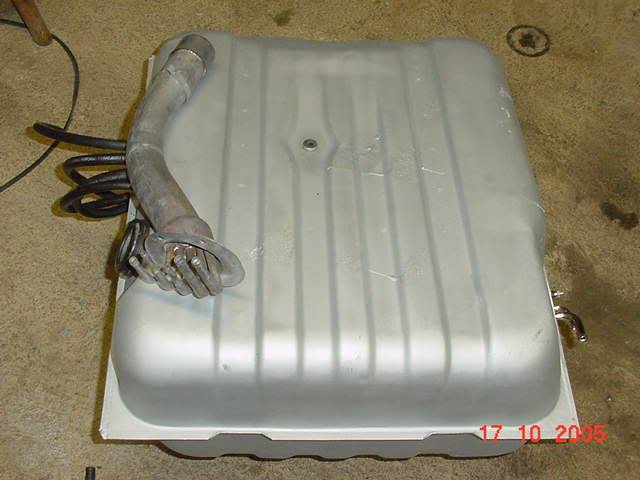

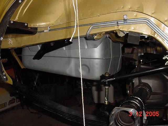

Here are some pics of our trunk and a vent tube similar to ours:
moparleo
Oct 17, 2011
7,237
2,021
The best way to go is with preformed fuel lines. Here is some info on the vent lines.
http://www.allpar.com/fix/fuel/evaporation-control.html Several companies sell pre-bent lines for fuel, vapor, pump to carb , return lines ,brake lines etc... These lines come shipped with a large, gradual bend in the middle for shipping and only require carefully straightening the bend. They are pretty self explanatory as far as installing since the lines are bent to follow the original route from the rear to the front. These companies will need to know the engine size, carb brand and model, etc... Also the trunk looks very nicely detailed. It should be painted the body color though if you are interested in doing a factory correct finish. Keep up the great work and keep us posted on your restoration progress.

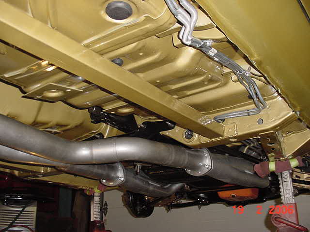

1. Looking at completed or even 'work in progress' cars that others have can be very helpful when trying to restore your own vehicle. If you go to this website which is the 'Sold' area at RK Motors down in Charlotte, NC you'll find about a dozen 1971 Cuda's that they have sold, and RK takes dozens of pics of every car they offer for sale. Access to the this site is free, and you can then 'pick and choose' what to duplicate in your car depending on the type of restoration you wish to do. http://www.rkmotorscharlotte.com/sales/inventory/sold#!/?utf8=✓&search[year_text_range]=1971+-+1971&search[make_id_eq]=516

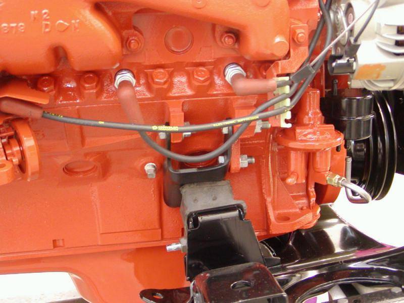

3. The fuel return line is connected to the Fuel Vapor Seperator which attatches near your fuel pump at the front of the engine block. The pic I've attatched here is of a very correctly detailed 440 that has just been painted. You can see the fuel pump (which was painted engine color at the factory) and just in front of it is the black vapor seperator. Fuel to the carb(s) comes from the line on the top of the vapor seperator while the 2 connections on the bottom of the seperator are where your fuel pump line connects and where your fuel return line back to the gas tank connects. 6329392-70440-6fuelpumpandrouting.jpg

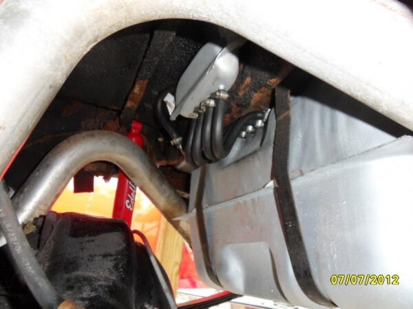

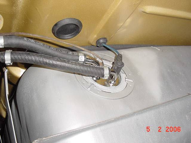

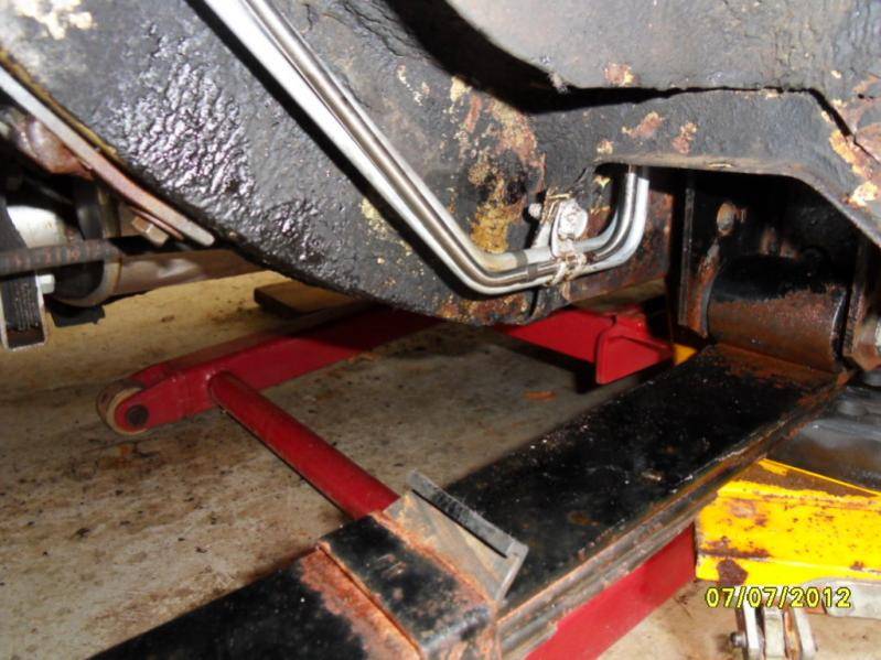

Here's some pics I found on another site that might help.....
