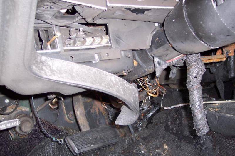

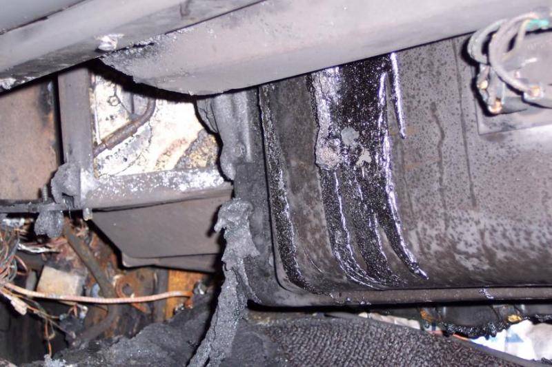

challenger6pak
Feb 27, 2011
4,086
923
This is what your dash could look like without a fusible link. 036.jpg043.jpg
