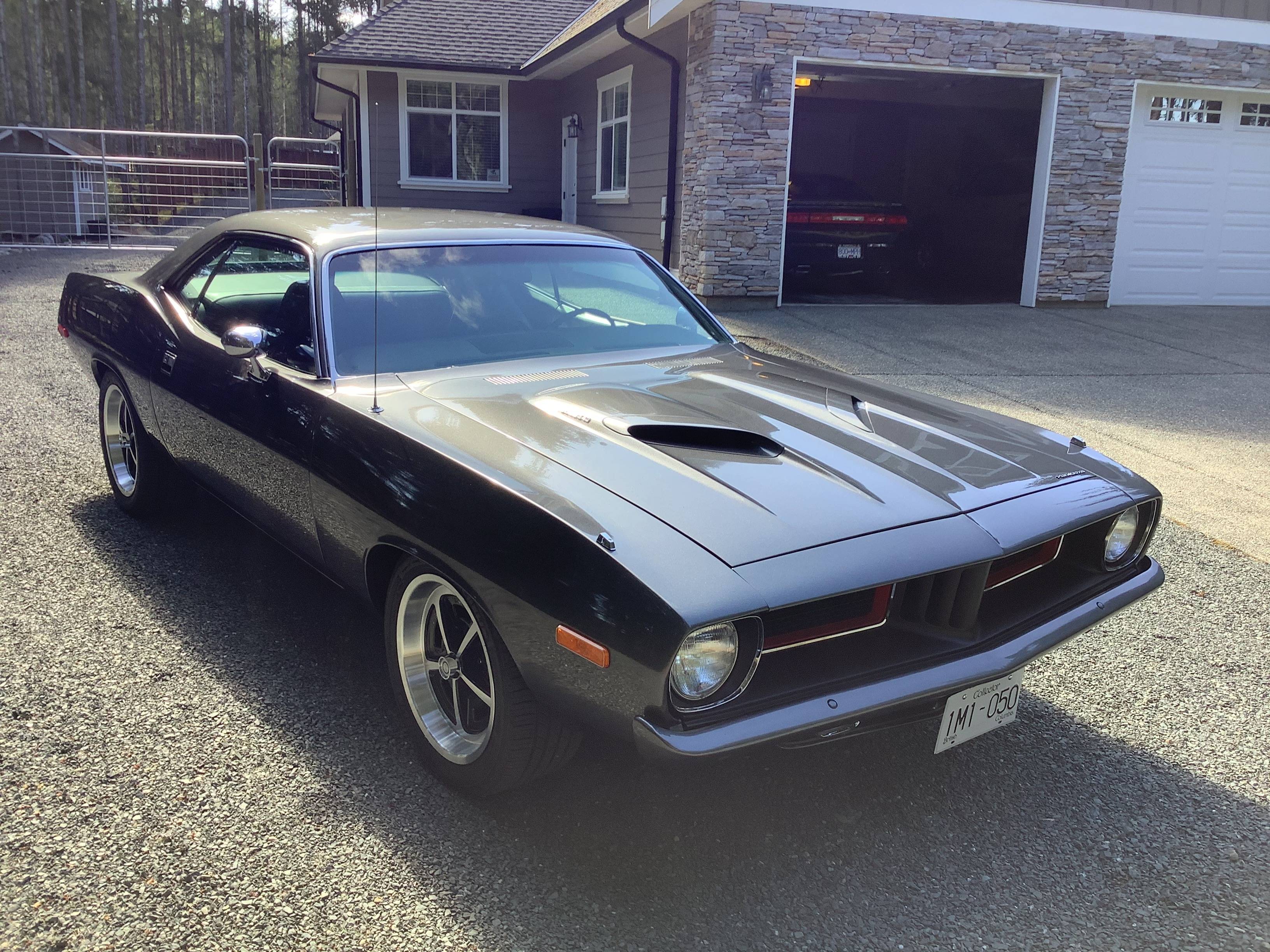

Hi all, I have a restored 1973 Cuda 340 4 speed, with an Edelbrock 650 AVS 2 carb and while it runs good, during operation, we are getting a burn't gas/exhaust smell inside the car. Appreciate your help. Jim
