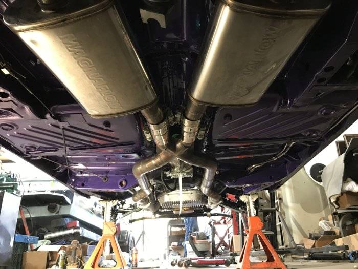

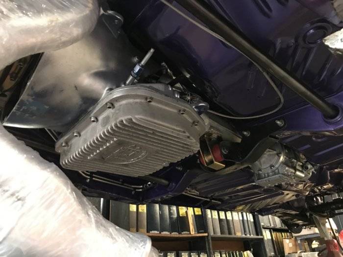

Fishgutz
Jun 6, 2017
151
223
Northern California
We bolted a G/V to my 727, running a 3:91 rear gear on a 26” tire. It went from 3600-3700 rpm @70 mph to 2700-2800 rpm @ 70. Plan on doing some exhaust mods and some trans tunnel massaging. 2 switches and some wiring, not a difficult install. Lots of fun to split gears.
