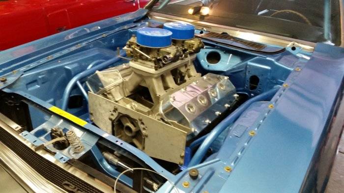

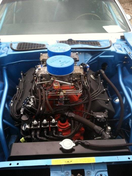

I have also used the old Hemispherical K frame and their motor mounts with no issues in my last Hemi Challenger build. The current Hemi Challenget build I went with a front and mid plate mounts only due to the power levels I am at now. First picture is mock up. Second picture is the finished shot.
