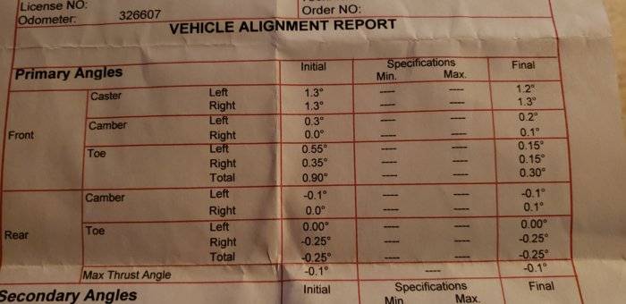

Here is a picture of the print out from the alignment shop. Looks like it's a bit off from what you suggest. All they set was the toe when I took it in. Do you think the adjustments you suggest will make stop hunting when I get on uneven roads?? Even with 17x8 rims on the front?

Sorry but I didn't receive a picture. Just type out the settings so I can compare.
Caster- front right 1.3 degrees
front left 1.2 degrees
Camber- front right 0.1 degrees
front left 0.2 degrees
Toe- left and right both are 0.15 degrees
Total toe- 0.30 degrees
Ok. The key to stopping the hunting is to get more positive caster. Think of how a bicycle fork curves and angles the wheel out in front of a straight line drawn down from where the upper fork goes into the frame. If there was no curve and it was on this line you would find it impossible to steer the bike. This positioning of the wheel axle forward is positive caster and allows you to ride the bike without hands. Positive caster is what keeps the car in a straight line. It is also what returns the steering to straight ahead after a turn. Radial tires roll completely different from bias ply tires. Try pushing your car with bias tires and it will take 3 of 4 guys to do it. With radials only 1 or 2 can roll it easily. The specs you have on your car won't work with radials. Not enough caster so it will hunt all over the road. 1.75 is the minimum you need. It should be equal on both sides. The .25 degree higher camber on the left is to compensate for road crown. You could go with 0 on the right and only .25 on the left. It is not your 8 inch wheels causing a problem. I had 8x15 with G60R15 BF Radial TA all around with these settings and steered and handled like a damn.

I doubt the alignment is the problem.
It actually looks pretty good. Higher caster won’t hurt anything.
You do have a slight thrust angle and it’s on the edge of dog tracking, normally I can see a .25 of a degree.
Tear down the outer tie rods and check for a binding in the ball joints. If it takes more than a slight amount of pressure with one hand, on either side there’s the problem.
If nothing you’ll have to check the idler arm, and if moves freely I would be looking at the gearbox.
