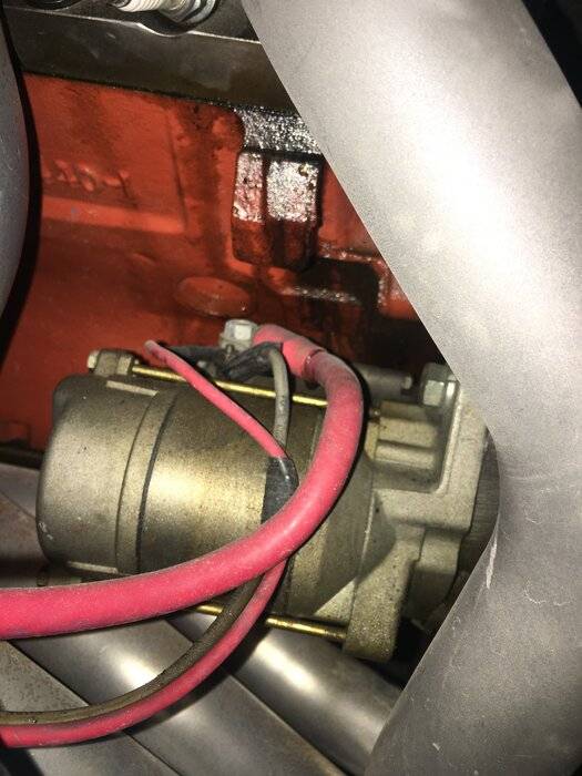

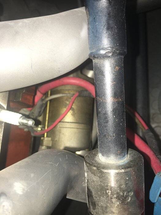

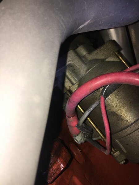

Go TTI like Moparleo sent. These are the best I’ve ever used on a big block
They are pricey but, you get what you pay for with these. Good stuff. Running a 5 speed Tremec.
can you use the stock starter or do you still have to dump 300 for the small one ?
I’m running a smaller gear ruduction on my 440. I’ve never tried the factory starter since this build in 2009-10. TTI should be able to let you know. I happen to have a few pics on my phone. I don’t know if it will help but, here they are.

thanks for the photos you would think spending 1000.00 for a set you should not have to spend 300.00 for a starter as well.
