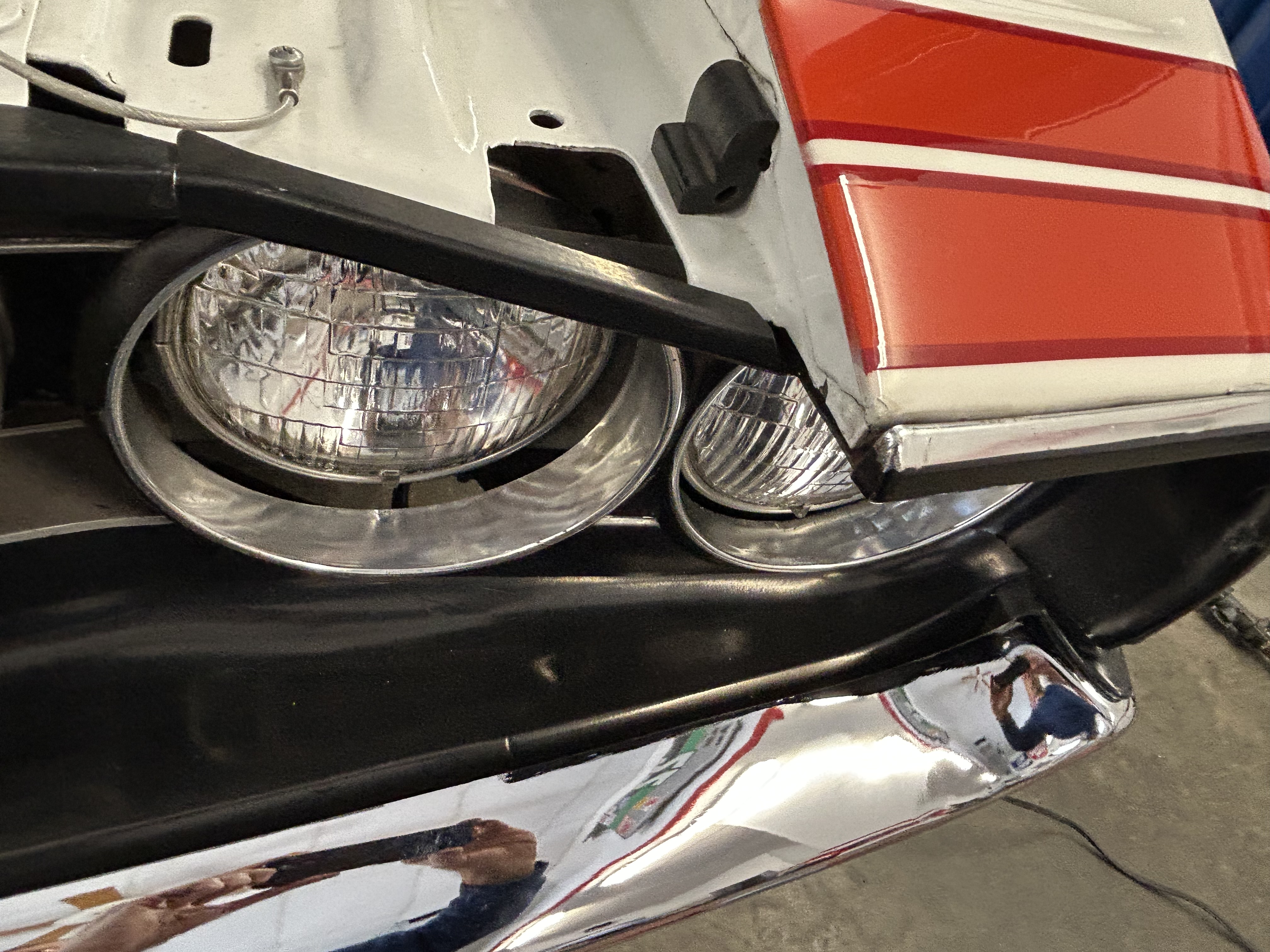

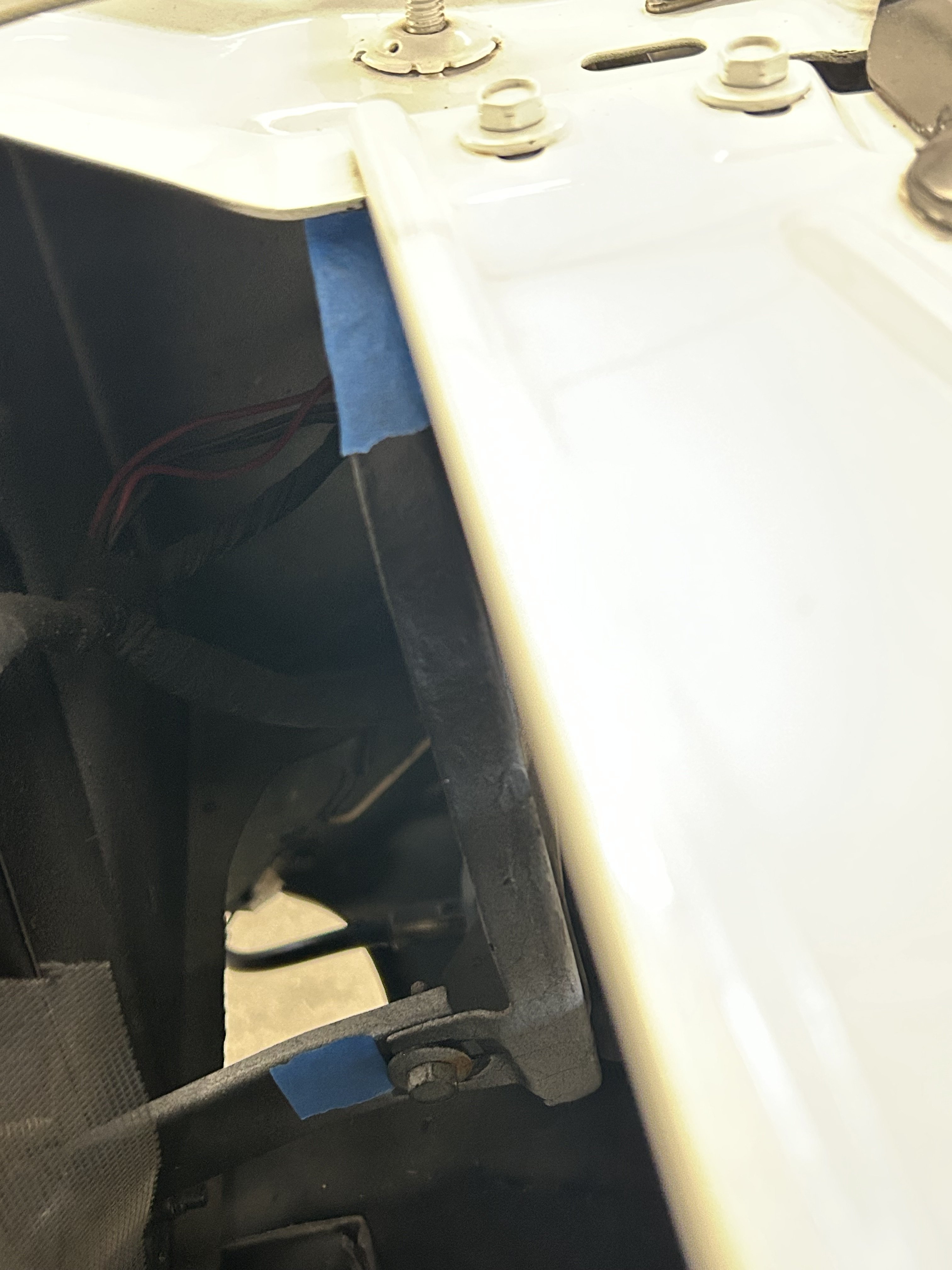

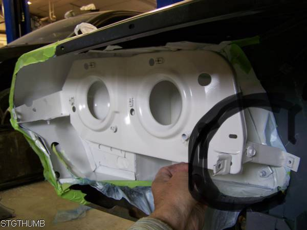

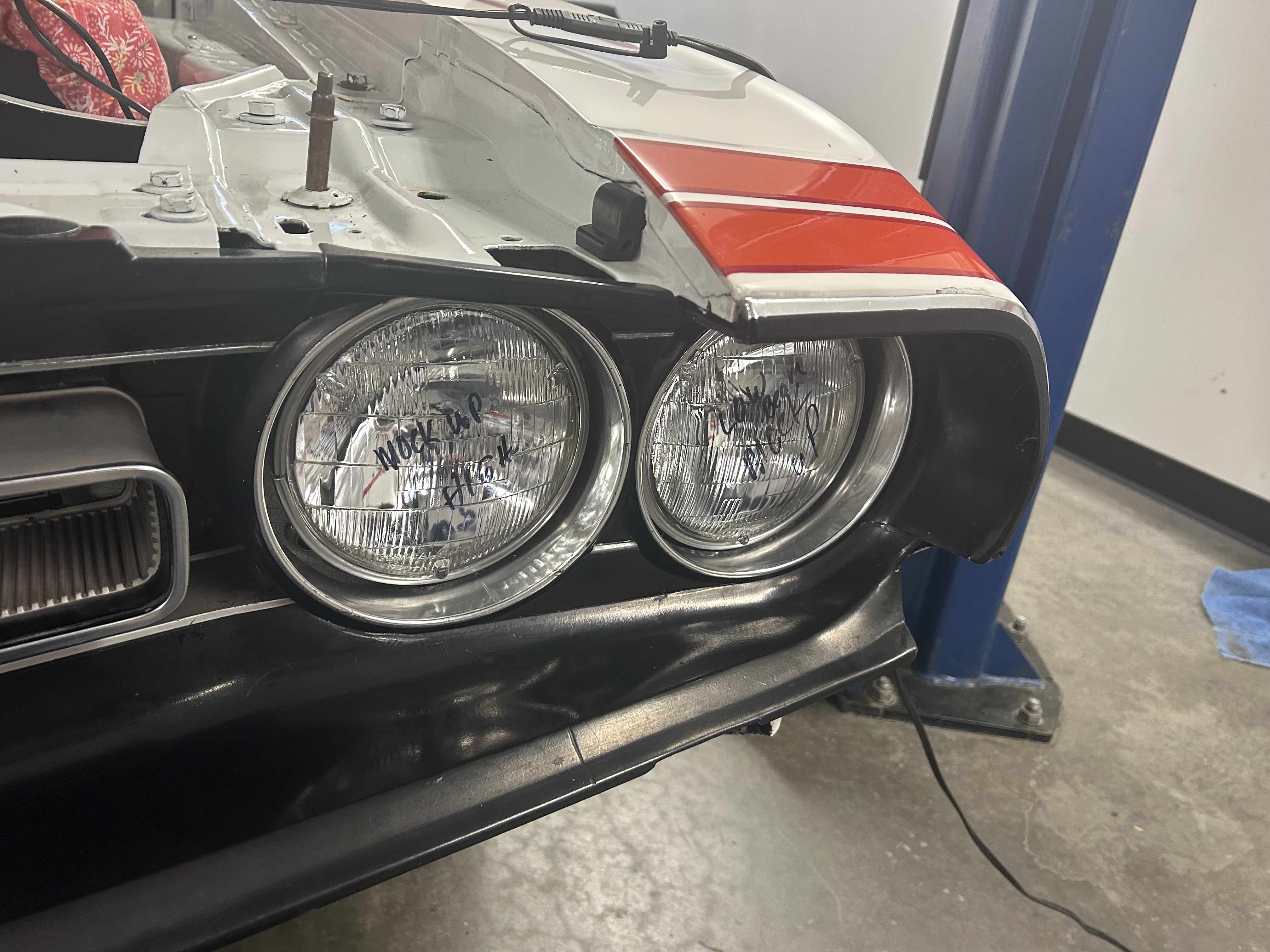

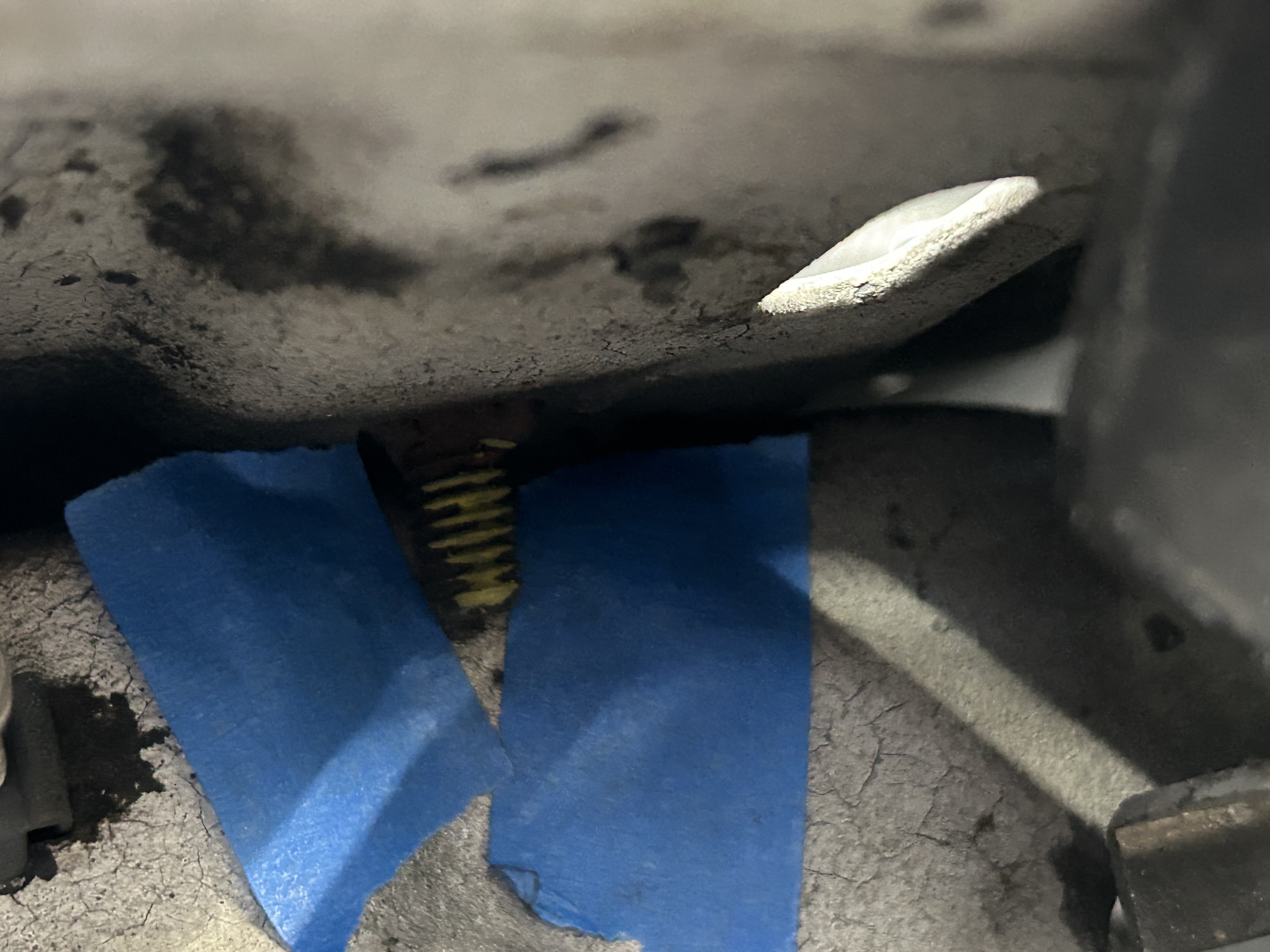

71 Challenger, I have a big gap between the headlights and the bezels on both sides. The fenders are OE Mopar replacements installed in the early 80s. The grill to bumper reveal looks about right and I checked the numbers on the buckets the lights mount to they seem to be correct, (all 4 for 1971 have different numbers as per the parts book) Is it possible the part welded in the fenders are too far back? Using the hood rubber bumpers for reference, the welded part in question is right behind the hood bumper stud (see pics), maybe it should be in front of the stud? In my photos you can see the part in question just behind the hood latch tray. Anyone have a 71 complete or just a fender for comparison? Also note in the last pic I am out of adjustment at the the bottom Thanks Charlie
The brace is all the way out, it is seen in my 2nd pic. One of the bezels is original to the car ‘71 and the other I purchased from Dodge dealership in mid to late 70s. Thanks I appreciate you taking time to show interest and reply.
