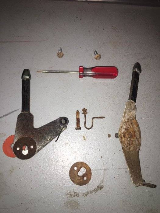

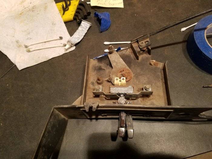

Hey guys, I am replacing my heater control bezel because the original has holes drilled in it for a switch and an oil pressure gauge. I'm struggling with removing the knobs from the levers so I can pull the levers out. How do the knobs come off of the levers?

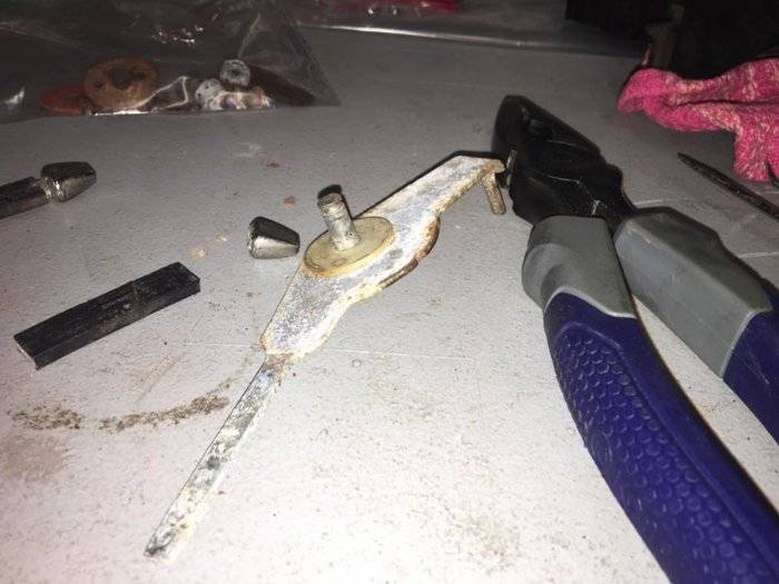

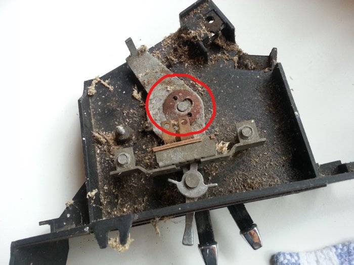

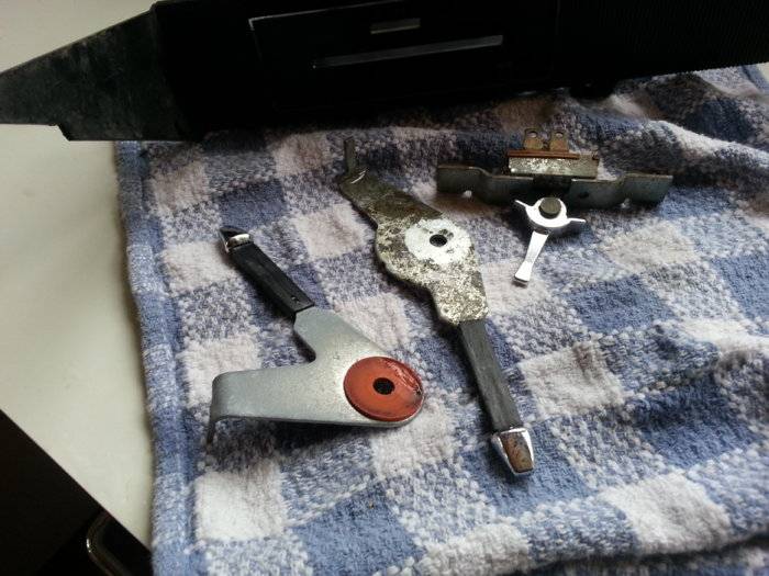

Heater control knobs are held onto the ends of the levers with a small, black spring type clip. I don't believe that I took a picture of the clip when I had mine apart. You can take them apart if you are careful and patient.
