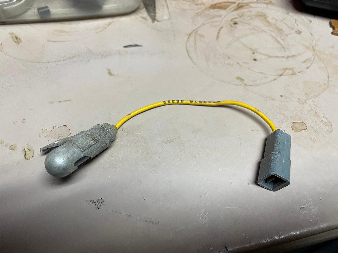

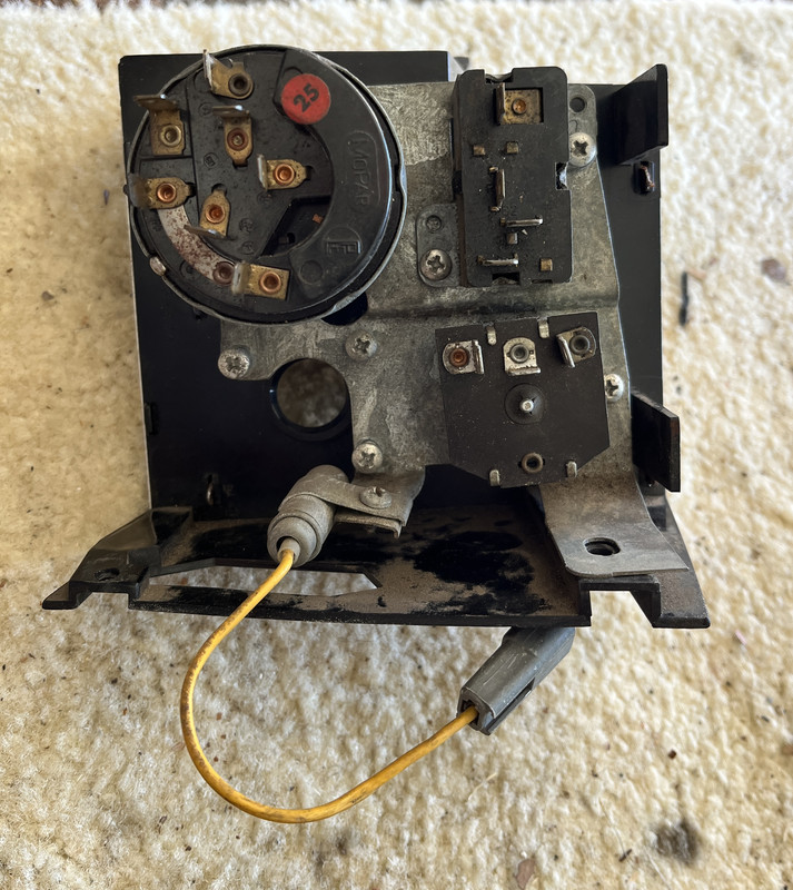

Is there a way to test the heater control light (yellow wire)?

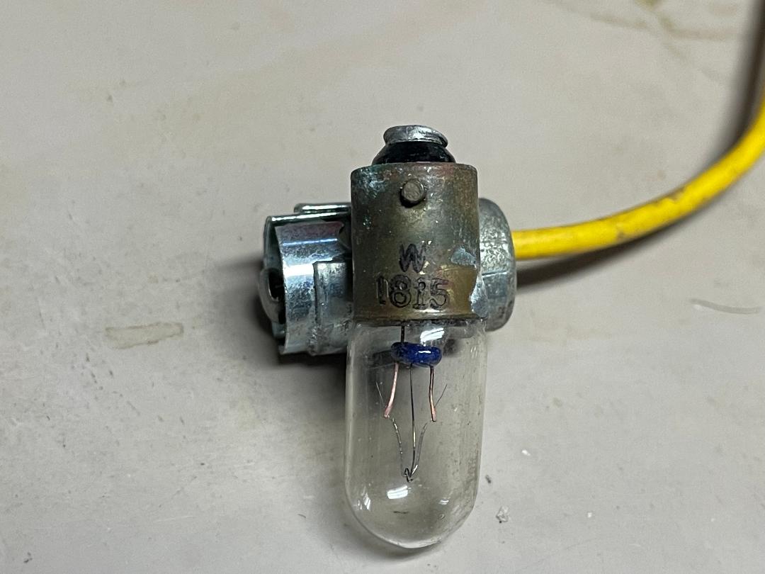

Can the bulb be changed or does the entire part has to be replaced?
Has anyone sourced them anywhere?
Thanks!
Easy test. With the fixture mounted, unplug the wire and send 12 volts down the male spade. If the bulb is burned out, disassemble and replace with a 1815 bulb.
