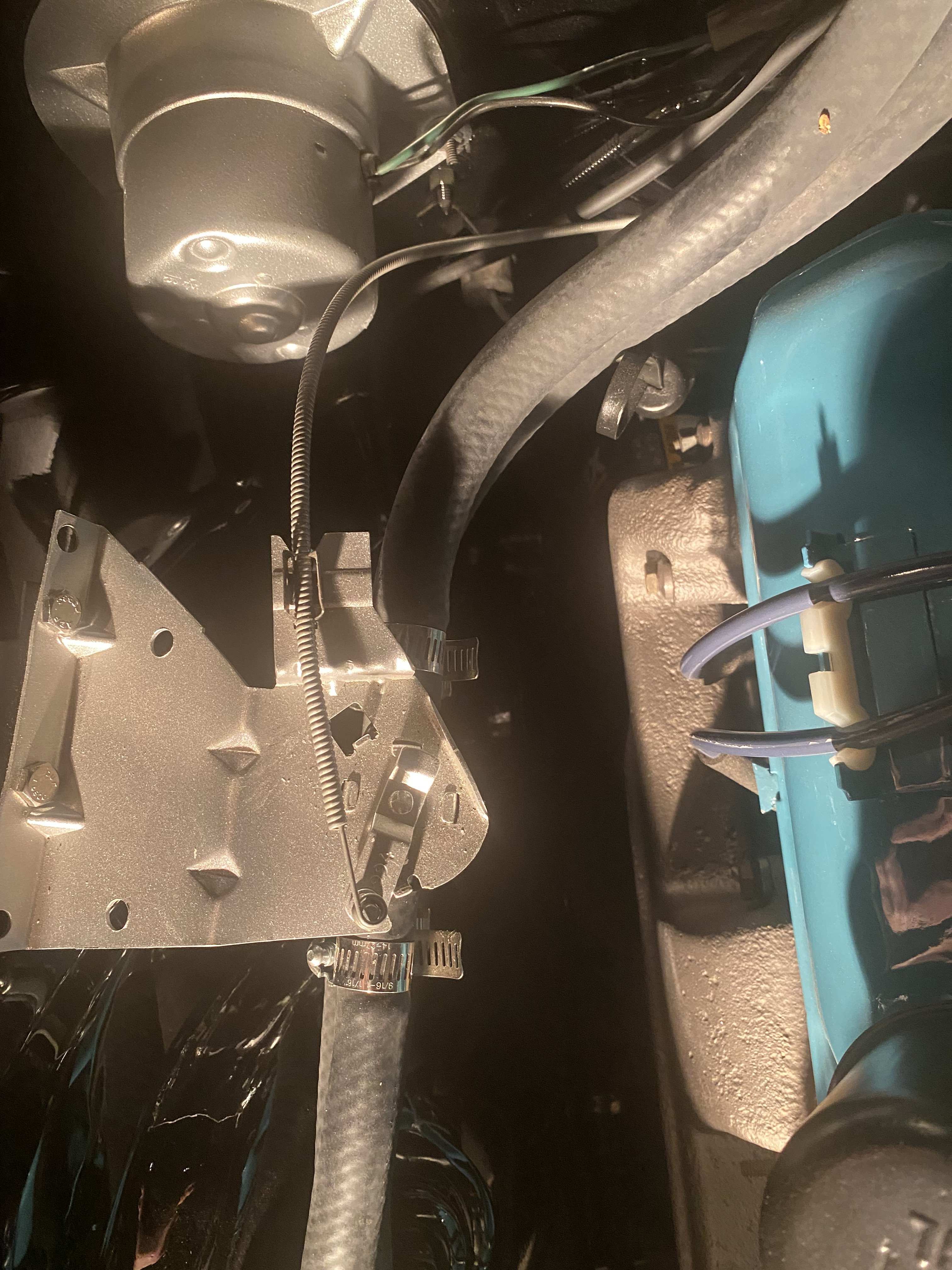

Sep 3, 2025 #1 ChallengerGreg Well-Known Member Joined Dec 3, 2022 Messages 51 Reaction score 16 Location illinois Is the heater control valve in the bypass position?
Sep 3, 2025 #2 moparleo Well-Known Member Joined Oct 17, 2011 Messages 7,248 Reaction score 2,035 Location So. Cal. Riverside area Moreno Valley What position is the heater control lever inside the car ?
Sep 3, 2025 #3 ChallengerGreg Well-Known Member Joined Dec 3, 2022 Messages 51 Reaction score 16 Location illinois The lever in the car is not functioning correctly. I can forcefully move the inside lever but the cable end at the valve does not. The cable might be kinked. Anyways for now I have a leaking core and need to put it into bypass position.
Sep 3, 2025 #4 Lunchbox Well-Known Member Joined Mar 28, 2023 Messages 85 Reaction score 25 Location USA Lever torwards front of car = Open Lever towards back of car = Bypassed/Closed Last edited: Sep 3, 2025
Sep 3, 2025 #5 ChallengerGreg Well-Known Member Joined Dec 3, 2022 Messages 51 Reaction score 16 Location illinois Thank you!
Sep 3, 2025 #6 Lunchbox Well-Known Member Joined Mar 28, 2023 Messages 85 Reaction score 25 Location USA ChallengerGreg said: Thank you! Click to expand... Have that exact one sitting on my bench now, made it easy.
