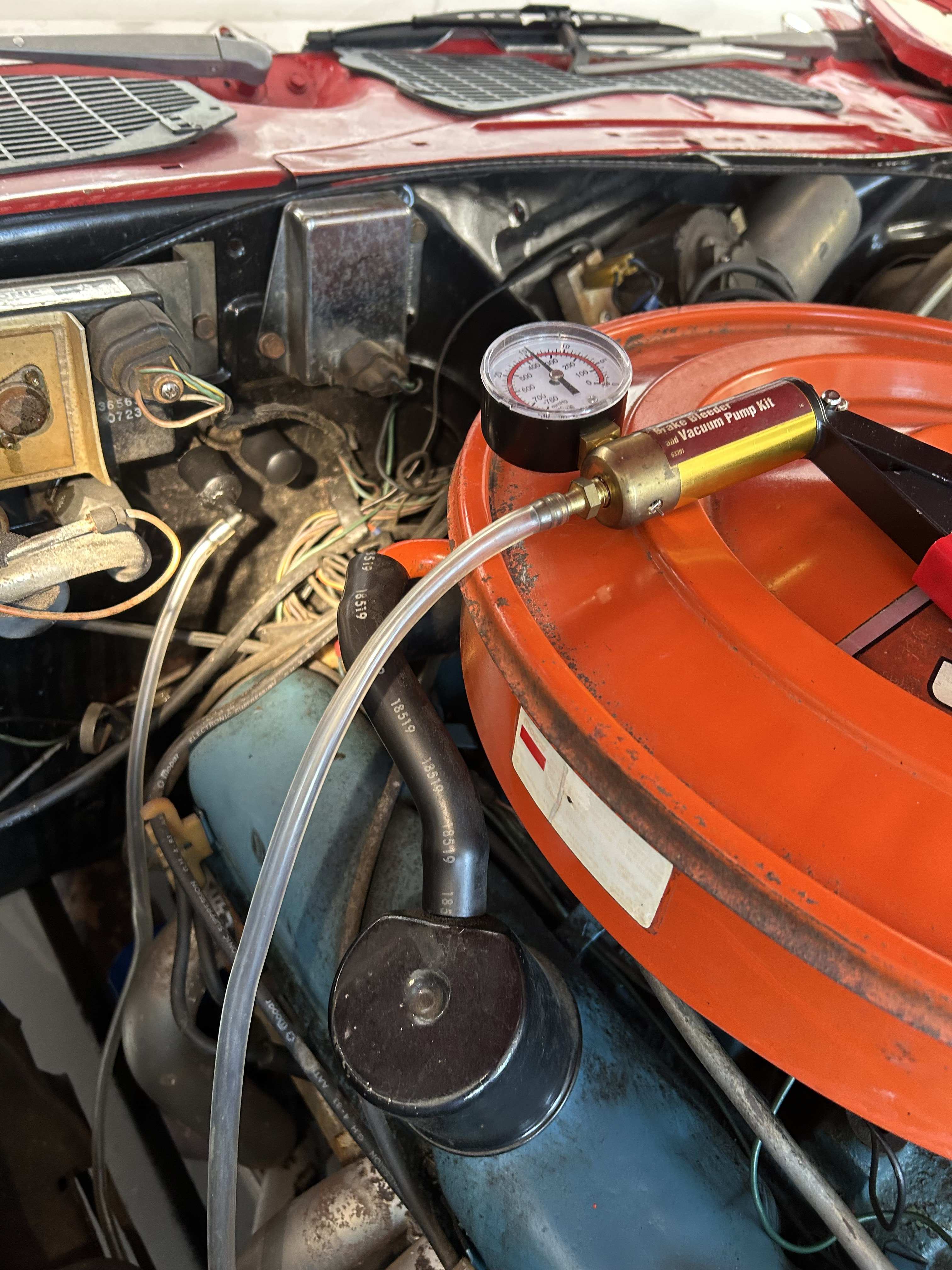

My car has a heater core bypass when I bought it and the guy I bought it from said it hadn't been hooked up since he bought it in 2008. That worried me a bit, thinking there may be a bad heater core, Well this little feat of garage engineering has held a steady 15" of vacuum for the last 20 minutes. Would you say it is safe to say it likely won't leak when I run the system with coolant or is there a possibility of a leak once the core heats up?

Now try the same thing with 16 lbs of pressure.
Will do. I know my pump will eventually start leaking down about a pound after an hour, How long should a measure for a steady value? 30 minutes?

Something to consider. If the heater core was bypassed because of a leak, the sediments in the core can be acting as a temporary seal with your vacuum test. It could be the person changed the core and decided they weren't going to use the heater anymore, but... If in doubt, I'd change it out. Just be aware the heater box may need a rebuild to replace all the foam seals. Just my opinion.

If it held the vacuum you should be OK - or it is blocked.
Run it with just water in the cooling system and a few old bath towels in the footwell for a few days.
But they are old and do fail - so maybe just replace the core with a new/tested one as a previous poster suggested.
This should eliminate a failure anytime in the near future.
Excellent idea! Thanks for the tip. There are a few things I'm doing over the winter, but just getting it together for the fall.

My non-air conditioning heater box was out of the car since I'm doing a full restoration on my '70 Cuda. Before I went to Carlisle I took the heater core out of it to ask Bob at Glen Ray radiators to test it. Took it to him and he said, oh we don't test them.. I'm like WTF. He says we just recore them. Mine is an original numbers matching date coded. Not that anyone will see it. Anyhow. He says $200 to recore it. Ummm no I will take it home and test it myself. Blocked off the big hose with a cap and used a hose with the tire valve on the other one. Filled my slop sink up with water and put it under water with 35 PSI on it. I saw no bubbles. I'm calling it good.
