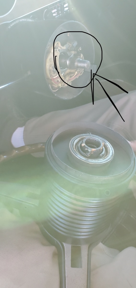

Does anyone know the nut size of the steering shaft? The one to connect the crush can to the steering shaft?
I have the car being shipped and am really in a bind as the shipper rejected the car because the steering wheel was loose. I’m flying up there to try and fix it but if you know the thread as I’m searching but coming up with nothing. I can find GM but the seller was a real piece of work and his mechanic didn’t secure the nut. It looks damaged so I don’t know if they even installed it.

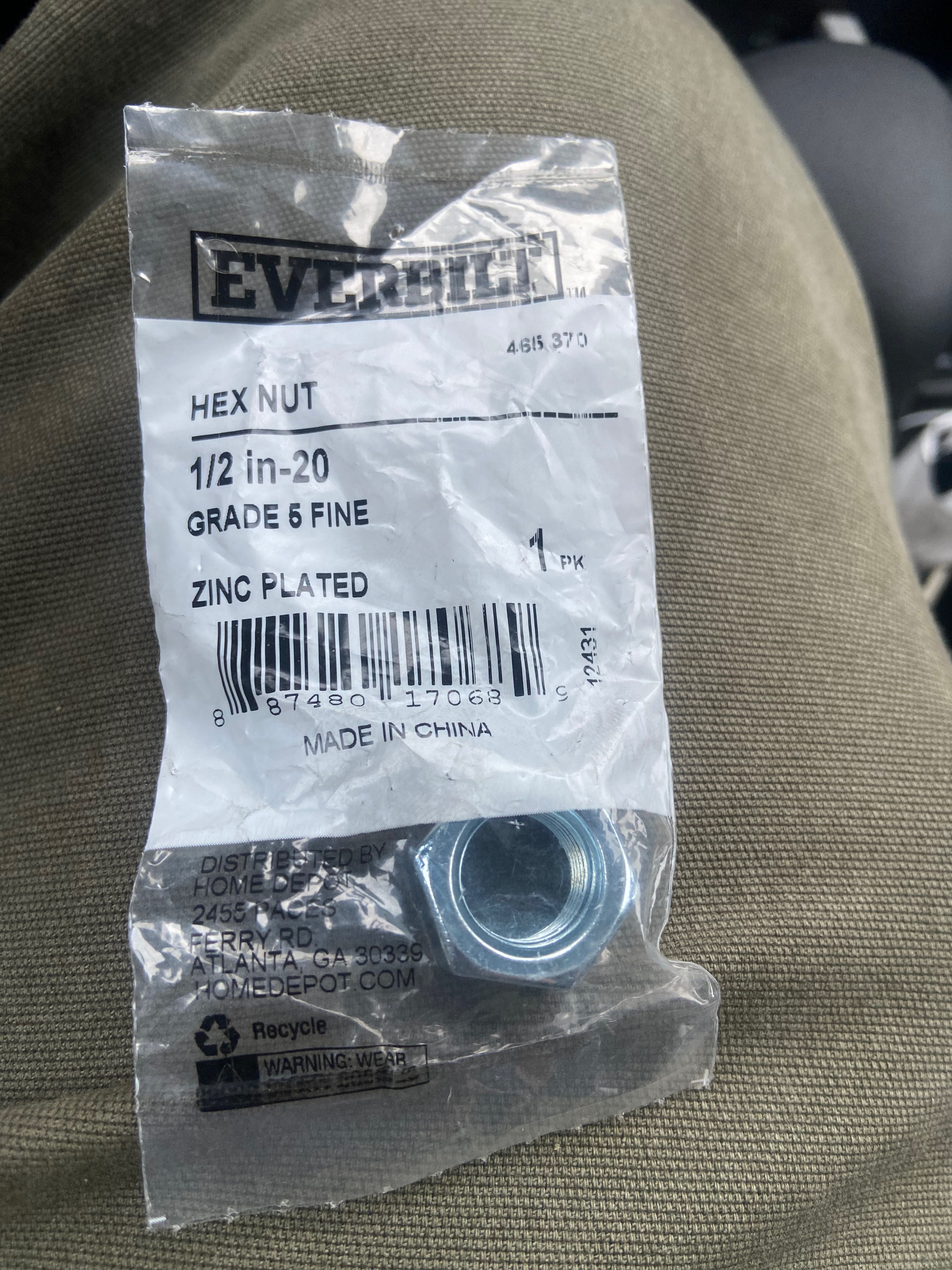

thanks for the info. I searched all night on the red eye over and I couldn’t find anything distinctive enough but I search 1971 Challenger and 1/2-20 pops up right away smh… they don’t have any shallow nuts at Home Depot at the moment so checking Oreilly right now. Brought my tap and die for 1/2-20 so one way or another, it will fit

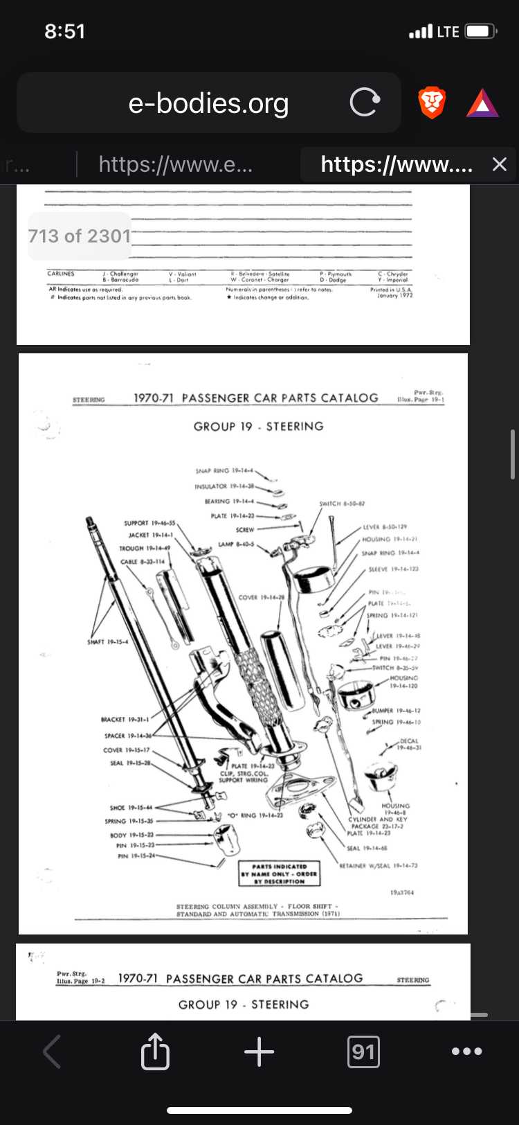

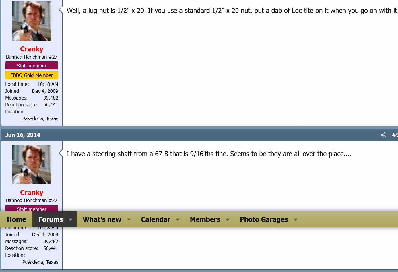

Fond this in Steering shaft thread size in Cuda & Challenger General Discussion (ROSEVILLE MOPARTS)
Yeah I've now taken apart some more 1970 columns since that post on ebodies.org, some had the smaller 1/2" x 20 threads with the 3/4" nut, and some had the 9/16" with 7/8" nut. I think the bigger size may have been out of earlier built cars and at some point they switched to the smaller size, I think then it stayed the same all the way through 1974.
