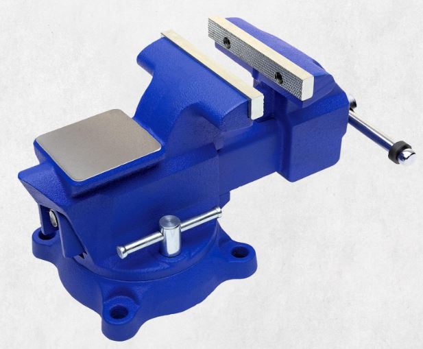

If you can't find the rivets you can always use a hammer and anvil (most bench vise's have this spot, see pic) to "tighten" the rivets. Lay the rivet on the anvil and hit it with the hammer. That will crush the rivet slightly making the pivot point tighter. Just don't smash the hammer down the first time you hit the rivet.
