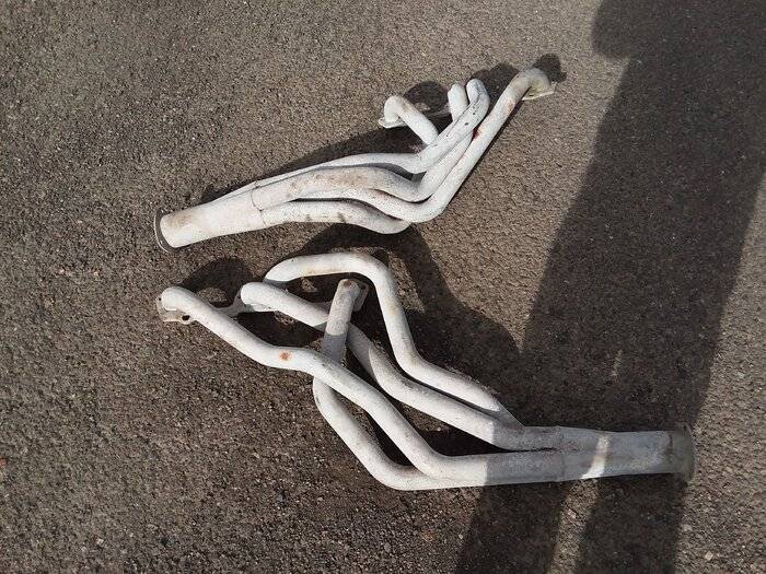

Thanks for that heads up. I received them today from NC. Shipping was a bit stiff but I think the motor is going to like them so it should be worth it. Seller didn't beat on them but I don't know what the person who did it, was thinking. Why there? I should be able to heat and pound out most of the dents from the inside. They won't look too bad and I'll have a lot more clearance than the Hedman that are on there now.

I run the Hooker 5115 (coated).. they clear the Fast Ratio steering pitman arm, and just a small hit/notch required for the aftermarket C-Body longer Idler arm (aka "fast ratio idler arm" by those who don't know that it's simply a C-body idler arm). BUT, the ports don't match the gasket and exhaust castings very well... may need HI-TEMP JBWELD (as I've done) to putty up around the header flange for the gaskets to the head... and flat file them smooth... no more leakage... after past 35plus years of (minor) exhaust leakage from the heads. The ceramic coating still looks good!
Next set may possibly, be TTi... for best fitment.

I noticed that the ports are pretty big on the ones I got. I'm sure they don't fit a J-head very well. Might be closer on the ProMaxx aluminum heads, but if there is an issue, I was going to weld them up where needed to match the gasket or seal. Mine are ugly and uncoated so I can do whatever I need to with them, and then send them out for coating if I get that far.
