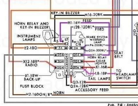

Yesterday at 6:24 AM #2 Challenger RTA Well-Known Member Joined Oct 28, 2018 Messages 5,119 Reaction score 2,912 Location PA Flood city Is the horn relay in the fuse box? On the top of the fuse box. horn relay and key in buzzer.

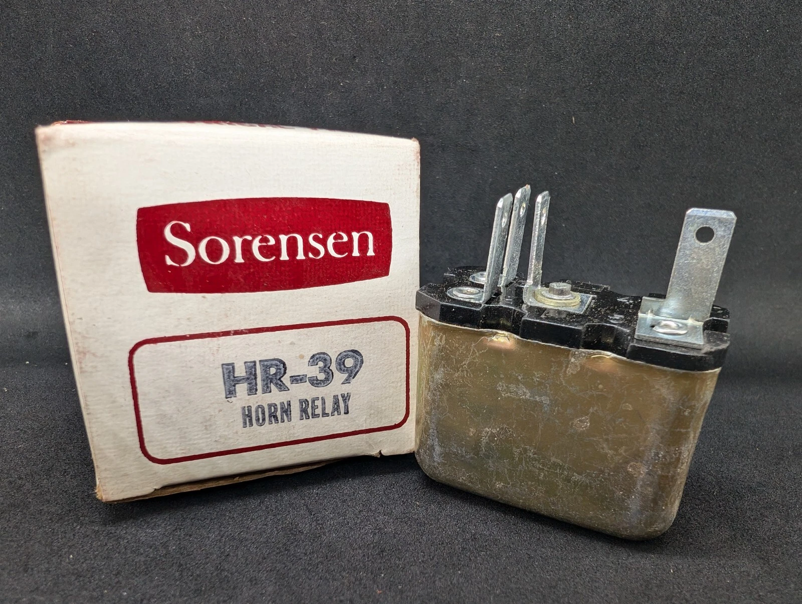

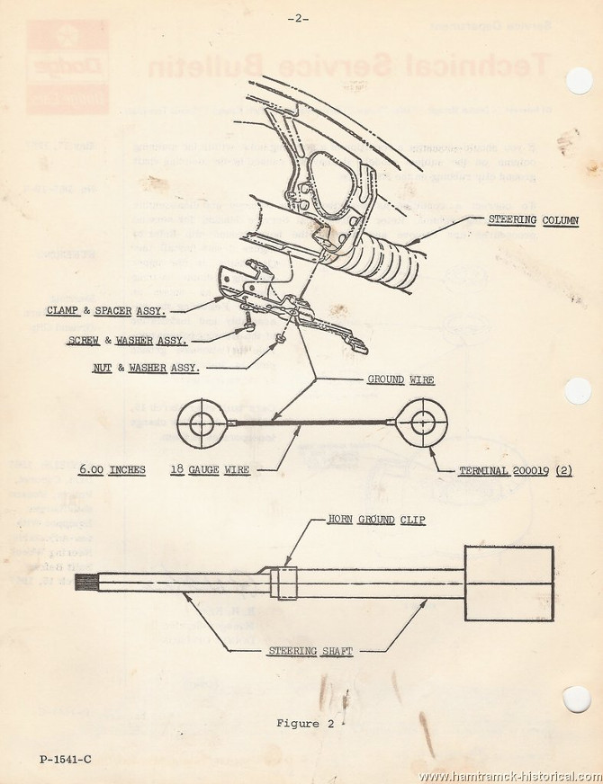

Yesterday at 7:09 AM #3 C Chryco Psycho Well-Known Member Joined Dec 28, 2008 Messages 5,091 Reaction score 2,751 Location Panama The wire in the column is a ground switch , it only provides a ground to close the horn relay so you probably have a problem withe the relay
