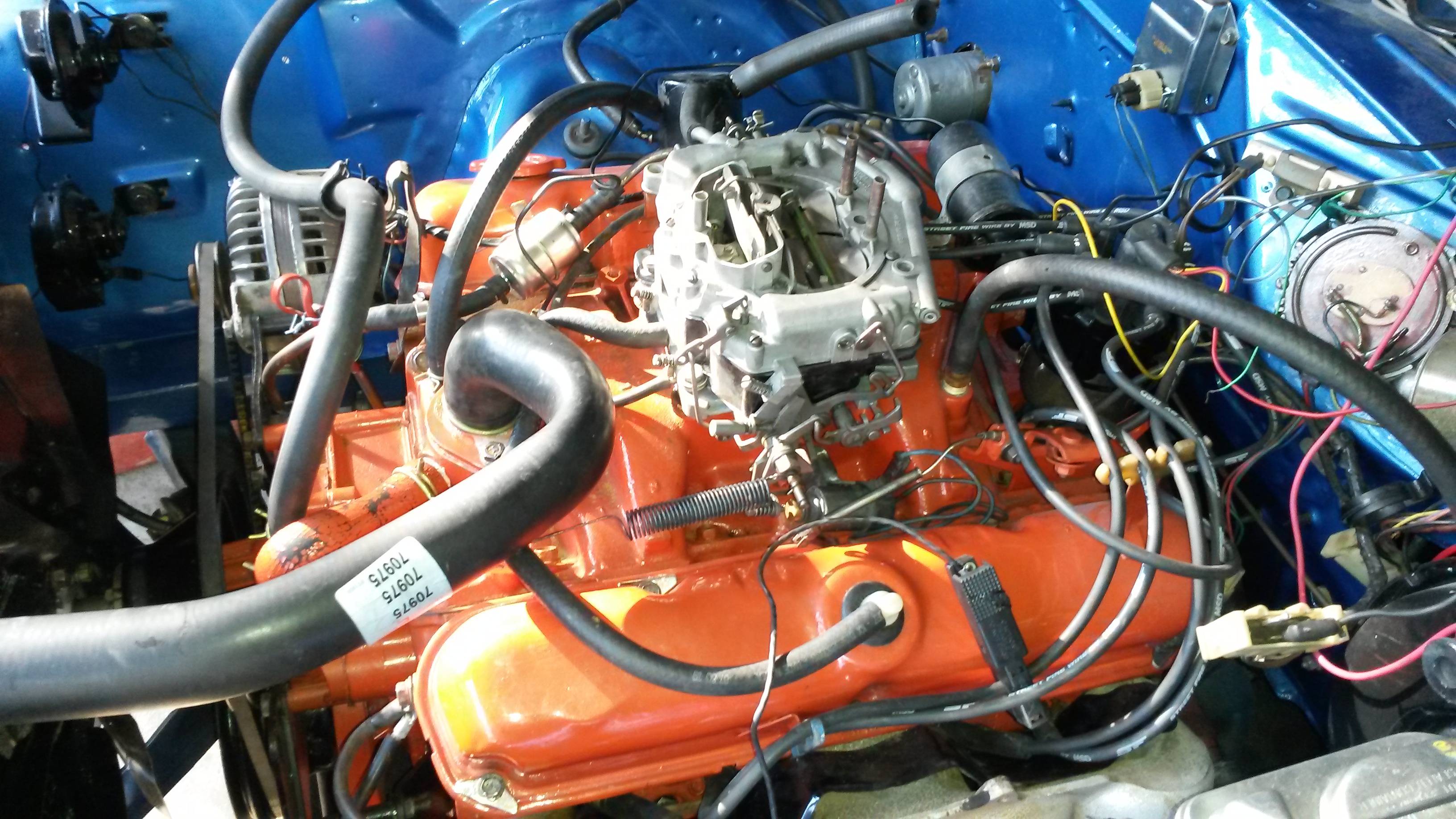

Looking to get some advice on my horn. I bought the car with an aftermarket steering wheel which did not have a horn button...anyways I replaced with a standard woodgrain wheel, connected the horn and no dice. I get some sparks and buzzing under the steering wheel but no sound.

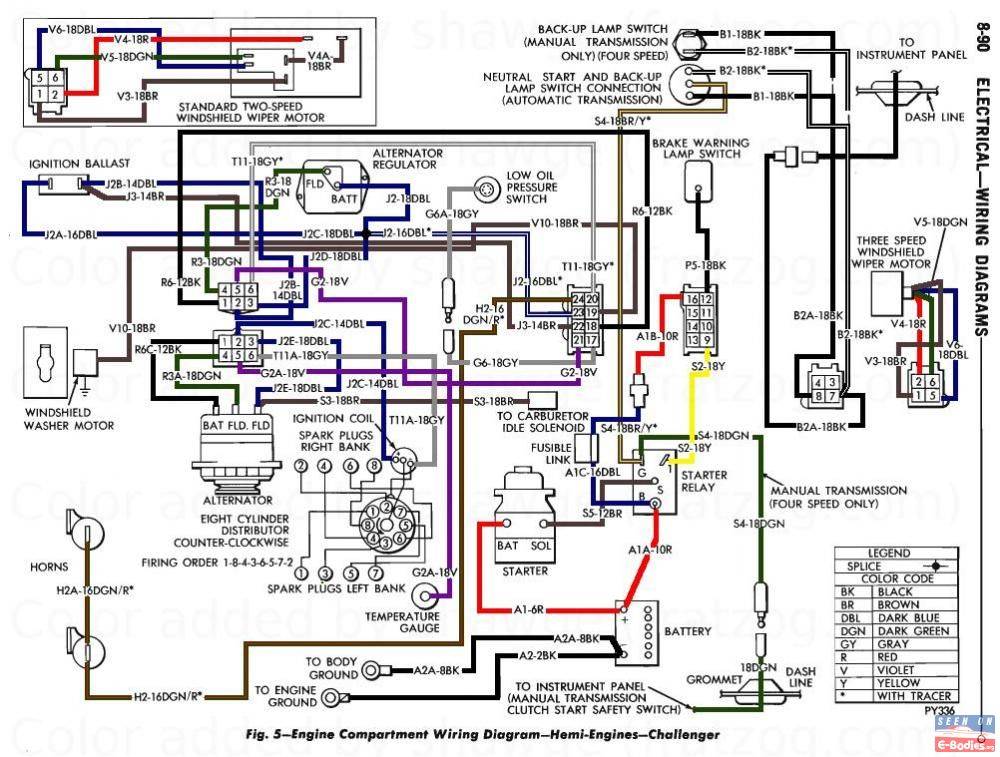

When I go to the horn both the are wired in a series with Horn A before Horn B. Both wires have 12v going to them when I push the steering wheel button in and have 0v when its not depressed. I tested both horns and the surfaces of each have ground. These were painted solid black and the engine bay was repainted with the resto I am wondering if it has a true ground or not.
1970 Challenger with dual horns, two of the small black ones, adjustment knobs are very different on both on Horn A the screw is almost fully out while Horn B has the adjustment screw all the way in. When I apply 12v directly to the horns from an external source I also get no sound from them, is it possible these are bad? Can these short out or rot? To my knowledge these are original and 52 years old.
