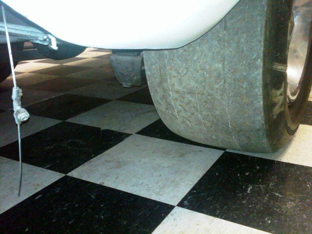

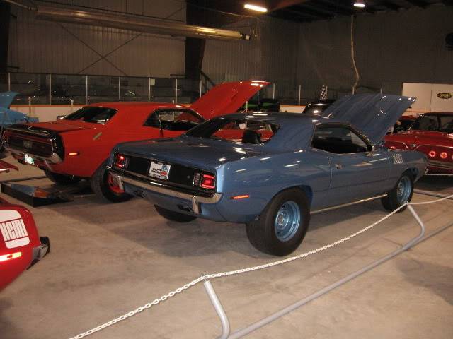

my car has a 28X10.5 on a 10" wheel with room for another 2" safely...
Wheels are 15X10 rallys with a 5X offset... Springs moved in...

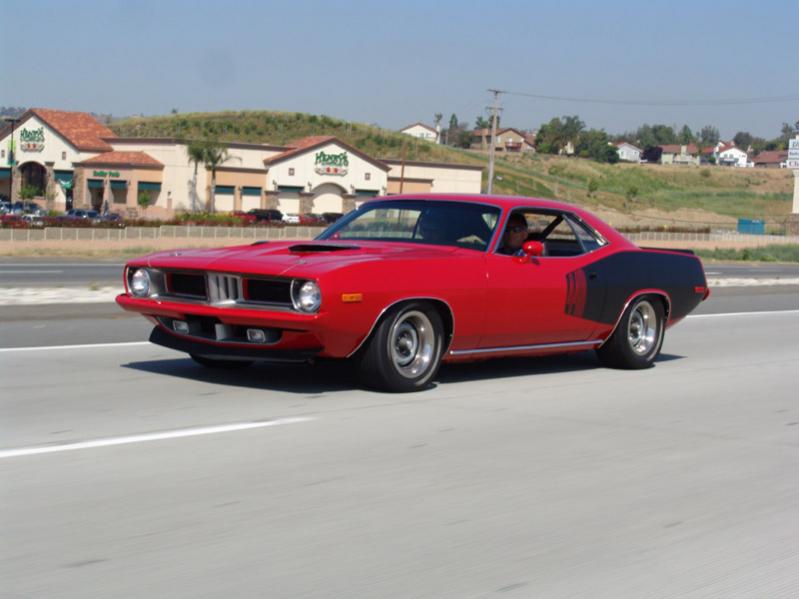

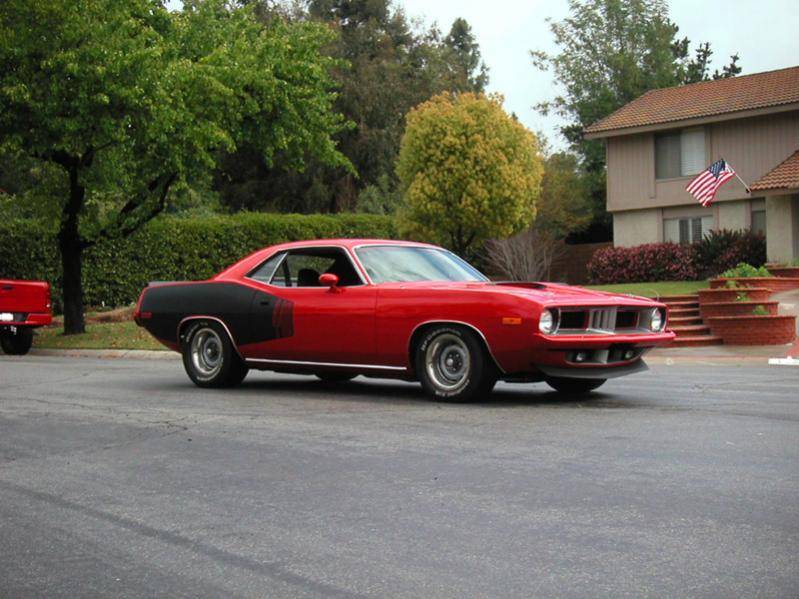

See here photos
This what this guy has under his car. In my view he has nailed it perfectly!
