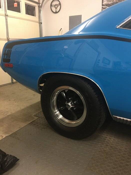

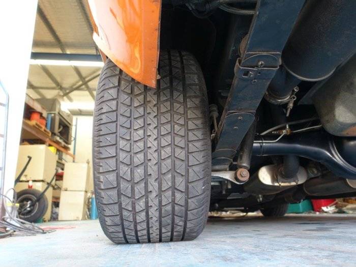

I'm restoring a 1972 Plymouth Cuda and I'm just wondering how fat of a tire will fit in the stock rear wheelwells?

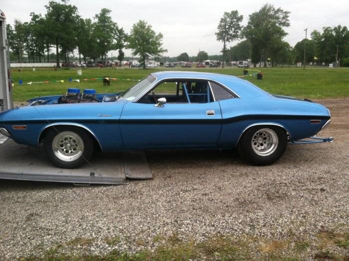

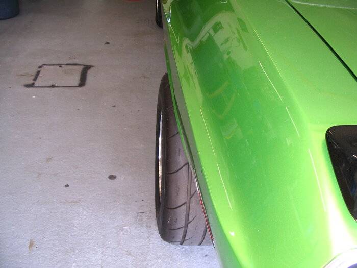

I am pretty sure the Challengers have a little more wheel well than the cuda's - so this makes senseThis is with 6" backspace & 1 " offset spring tyre 295/50/15 on a 10" Rim overall bulge 12" on Challenger
View attachment 64225 View attachment 64224 View attachment 64223

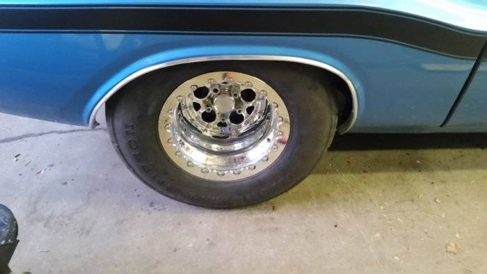

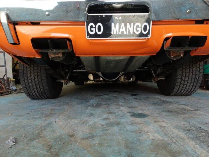

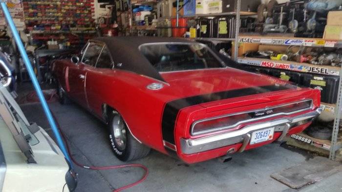

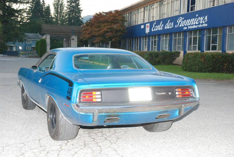

GOT 12.5 X 31 HOOSIER RADIALS ON MY 70I'm restoring a 1972 Plymouth Cuda and I'm just wondering how fat of a tire will fit in the stock rear wheelwells?
See here photos

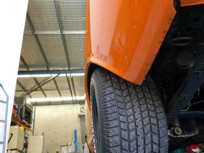

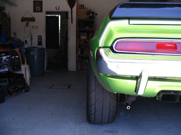

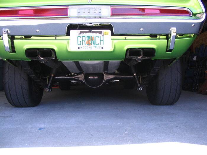

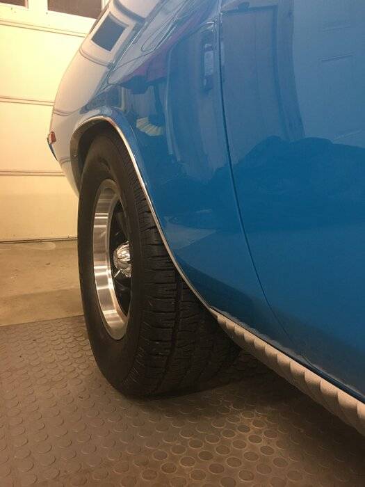

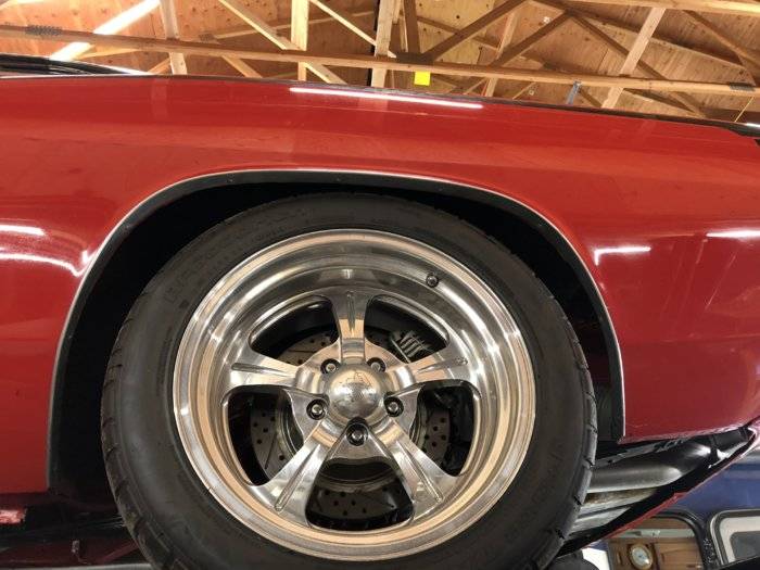

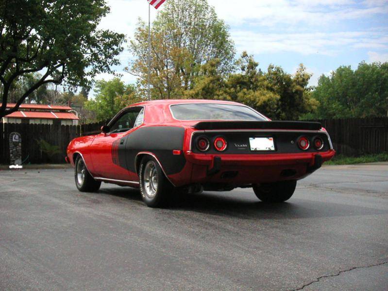

This what this guy has under his car. In my view he has nailed it perfectly!

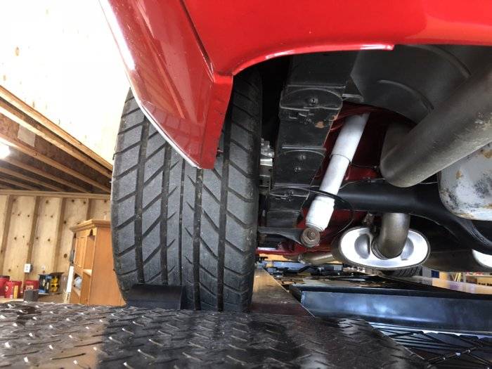

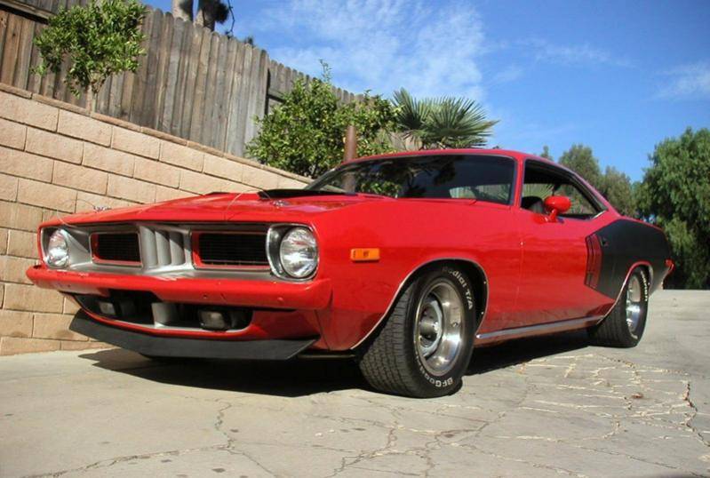

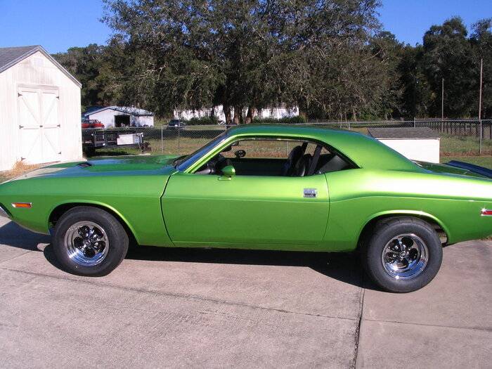

This is my 73 with 275/60/15 on 4.5 back space wheels. Tight on the right quarter but no rub. Stock location.I have a 73 Barracuda and I am interested in the rear spring relocation kit mentioned here. I would like to run a 15x10 wheel with a 275/60/15 in the back and a 15x8 245/60/15 up front. I am new to Bararcuda/ Cuda and need to know where to get the spring relocator kit as well as what back spacing front and rear will be required to make these monster tires fit front and rear.
Thanks!
