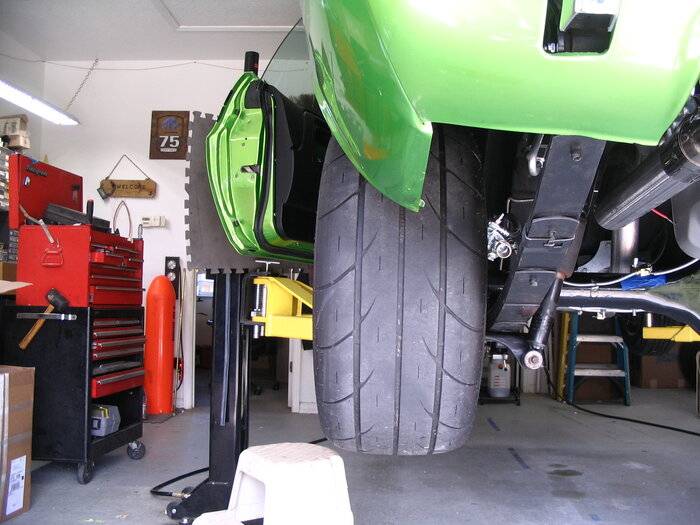

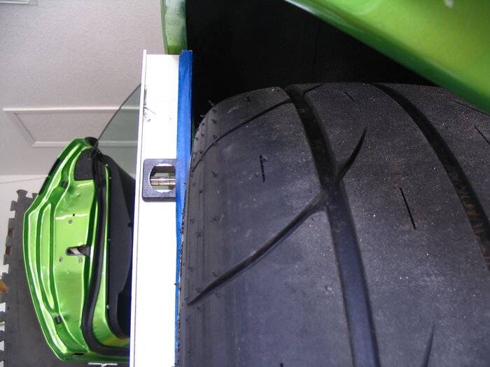

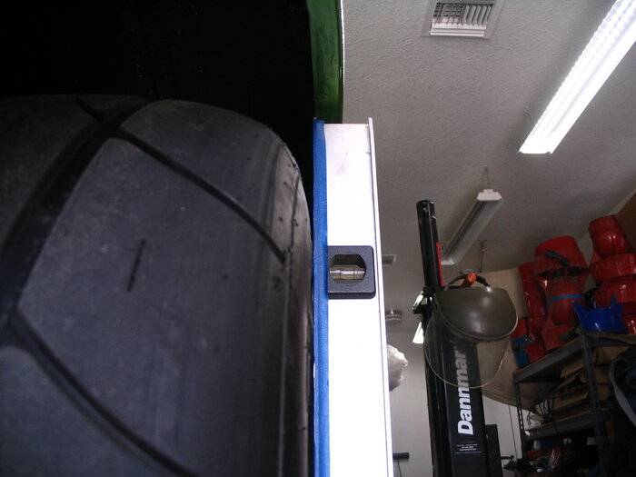

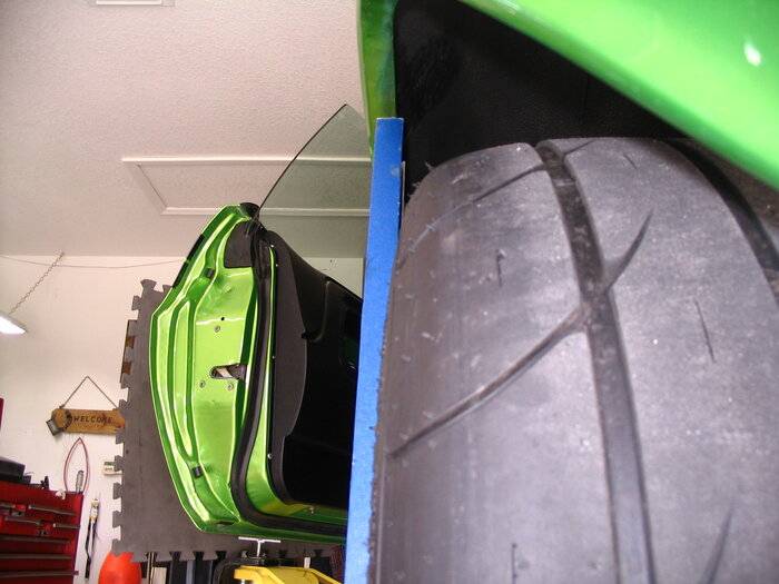

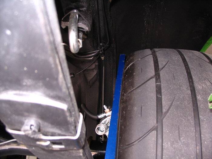

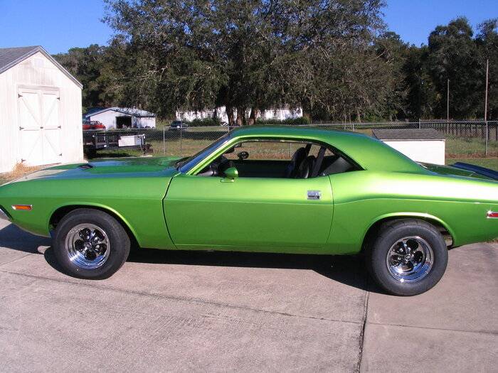

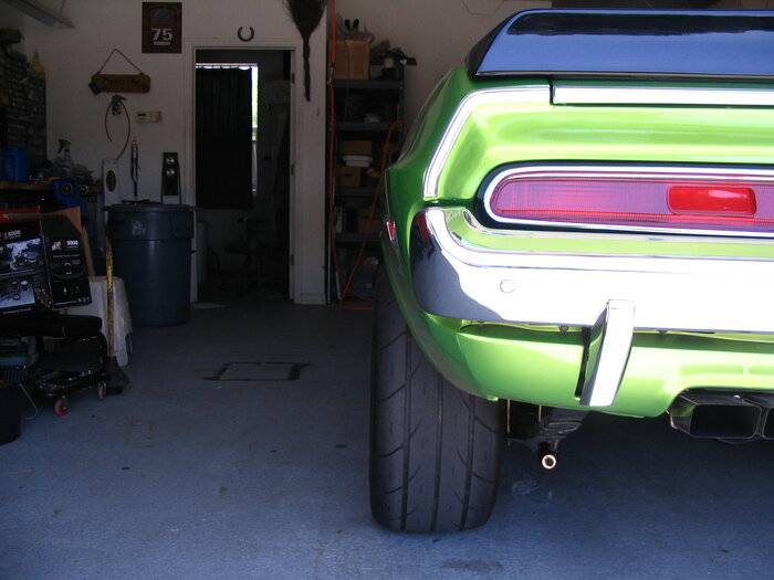

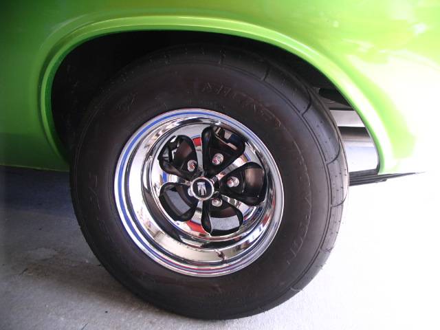

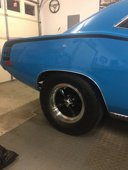

got the A body rear in, with doc diff 1 inch offset hangers & super stock springs spring 15 x 10 keystone klassics with 295-55-15s

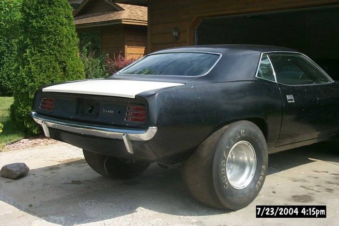

32x15 on 15" Centerline rim.
I suppose you want it all nice and tucked in to stock wheelwells? Well la de da! Lol.

Calm down youngster. If you look at an offset chart you will see that once you know the distance for the inner fender lip to the outer edge of the leaf spring, it is just a matter of the correct "offset" " back space" to locate the rims center. If you had 15" of space, yes you could mount that rim width assuming you have the correct "offset" rim. Not complicated. On an E-body it can be done by relocating the front spring mount to the "frame rail" and offset rear shackles.
That is how it was done back in the seventies on early "Pro-Stock" cars. Look up an E-body spring relocation kit. They have been selling them for 50 years.

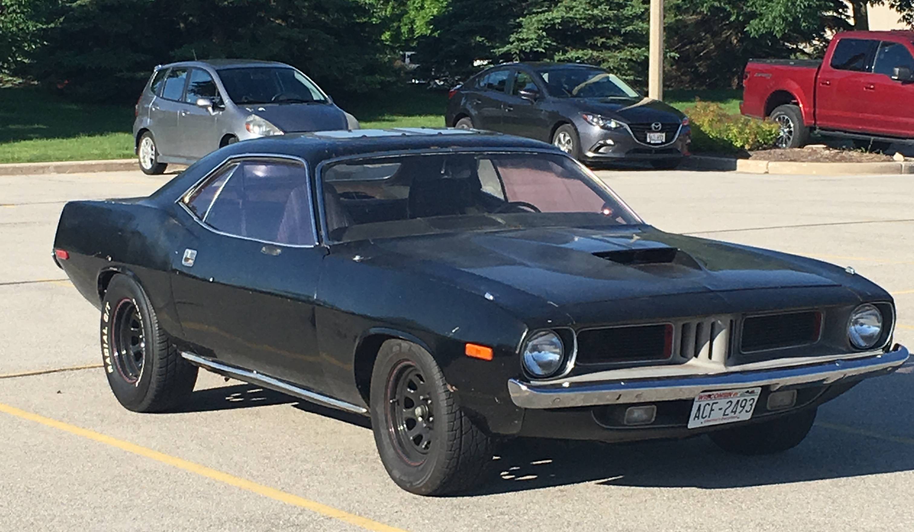

I've got 15x7 on the front. I think they are 3.5" backspace but not positive. I have 255/60-15 on the front and they fit fine. I have the front down a bit but not dragging.

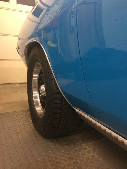

I'm restoring a 1972 Plymouth Cuda and I'm just wondering how fat of a tire will fit in the stock rear wheelwells?
I have a 73 Cuda. I have 7" wheels on the front with 245/60-15 tires. I do not recall the backspace on the 7" wheels. The back wheels are 8" with 4.5" of backspace & 275/60-15 tires. I do not have any clearance issues at all. The rear springs are in the stock location. The springs are Mopar XHD.
295-50-15s

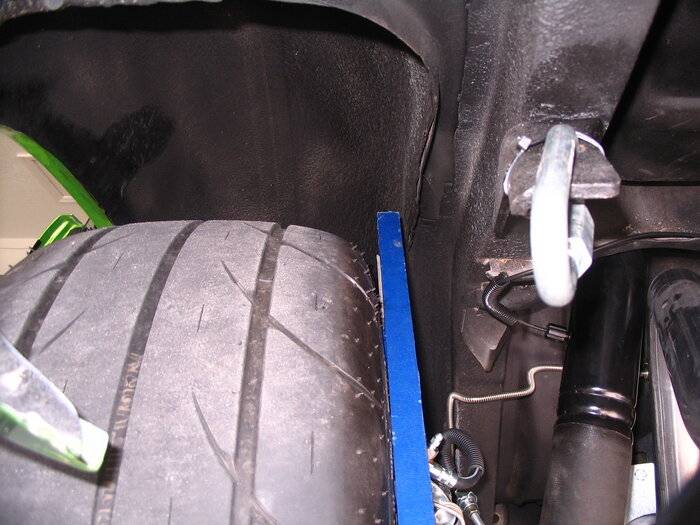

I am going to put an A body rear in ( gain 2 inches on each side ) once I get it back from powder coating this should put the tires where I want them, using doctor did spring relocation kit.
right now the tires rub a bit on the outer fender lip.in less I jack up the air in the shocks ( cant weight to get the airs off it!)
What are the widths on the keystones?
