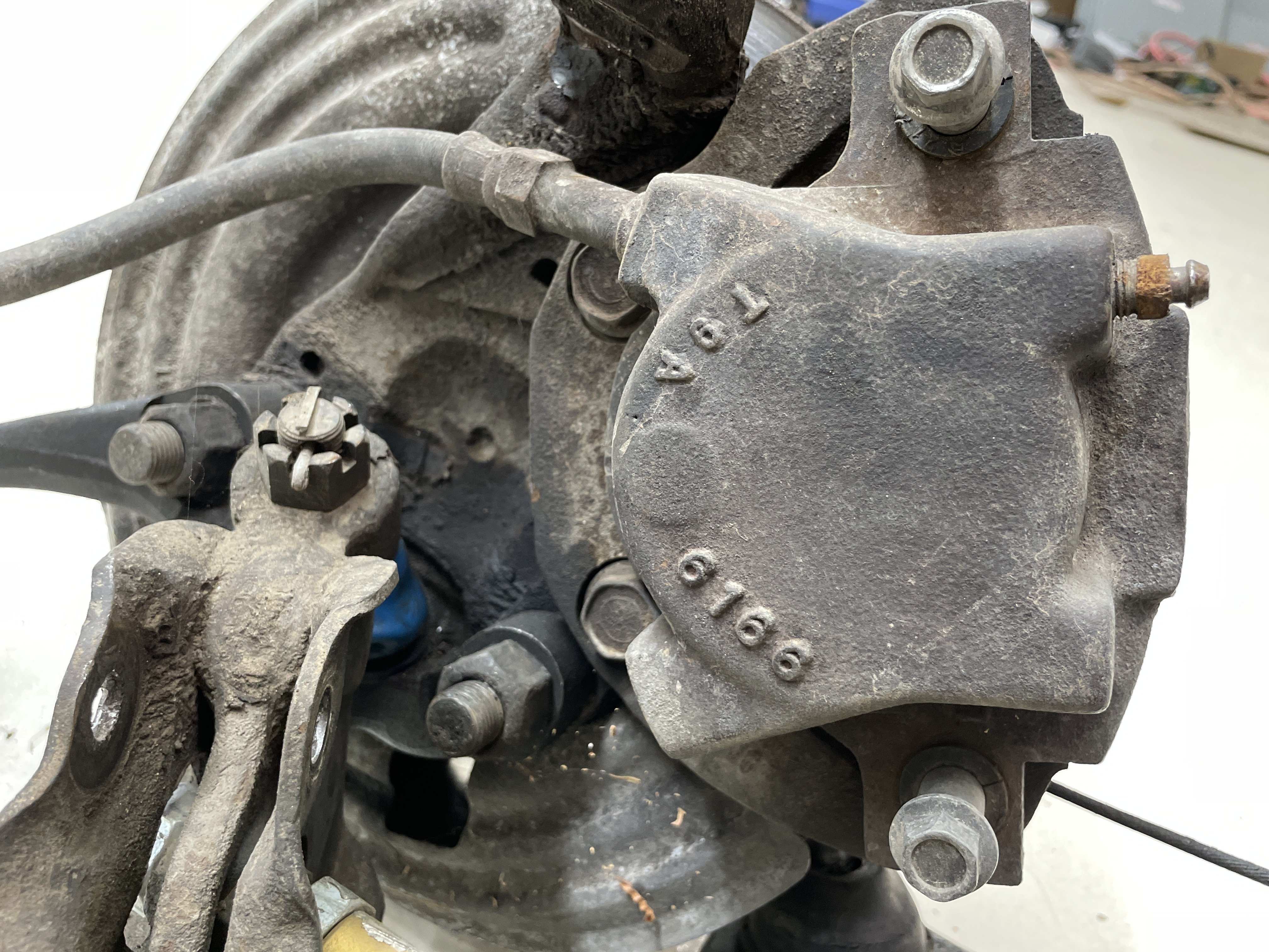

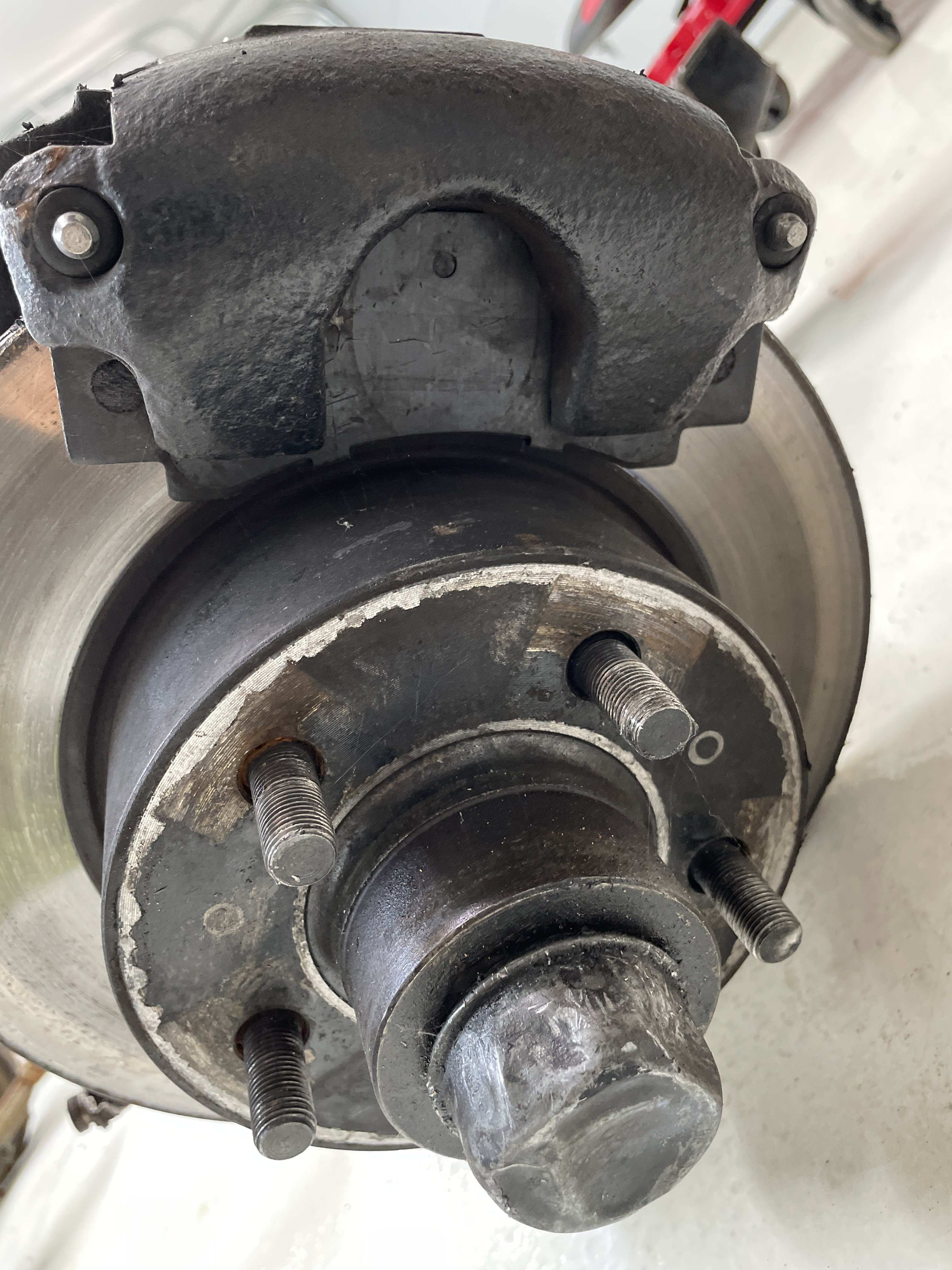

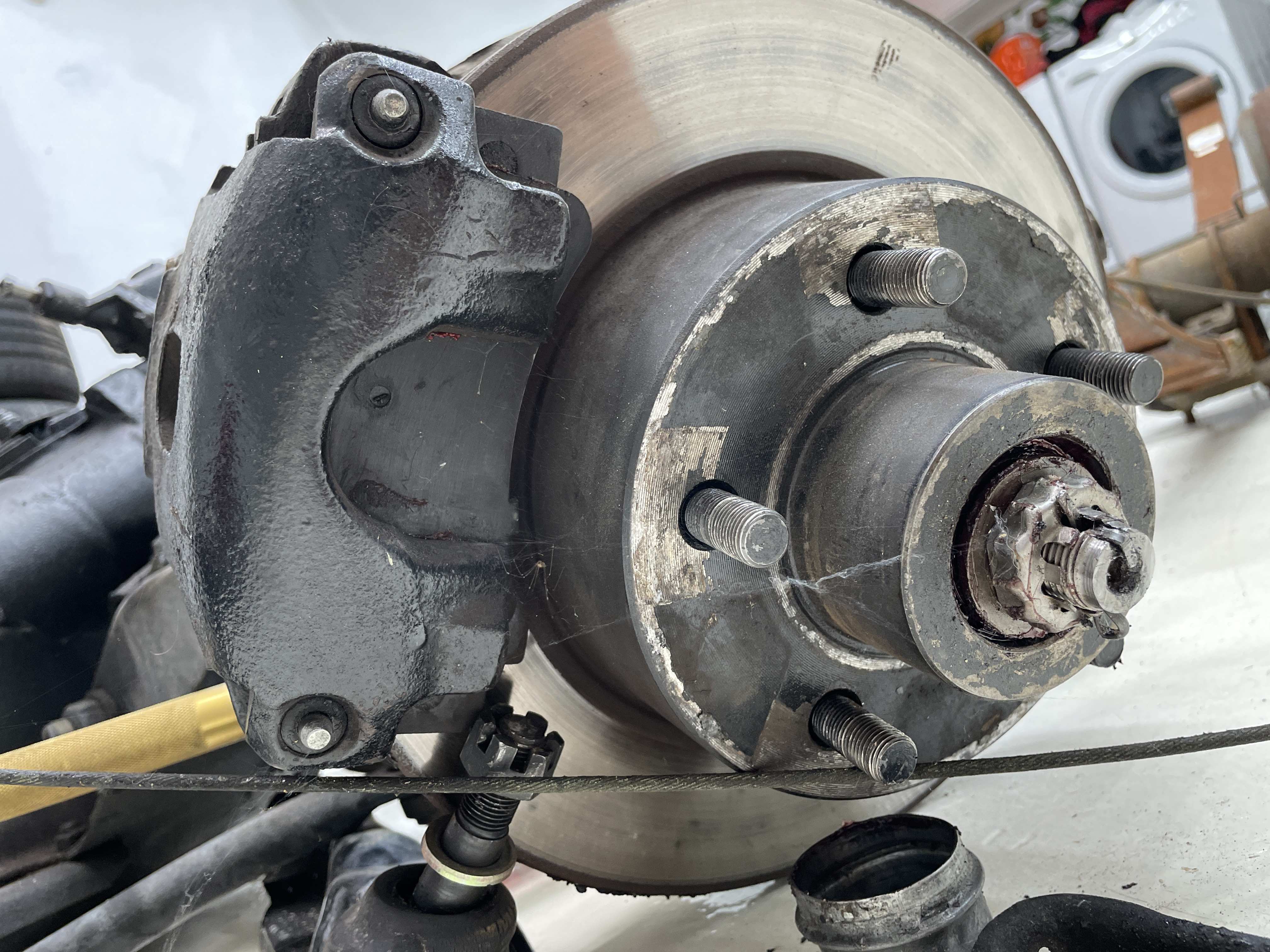

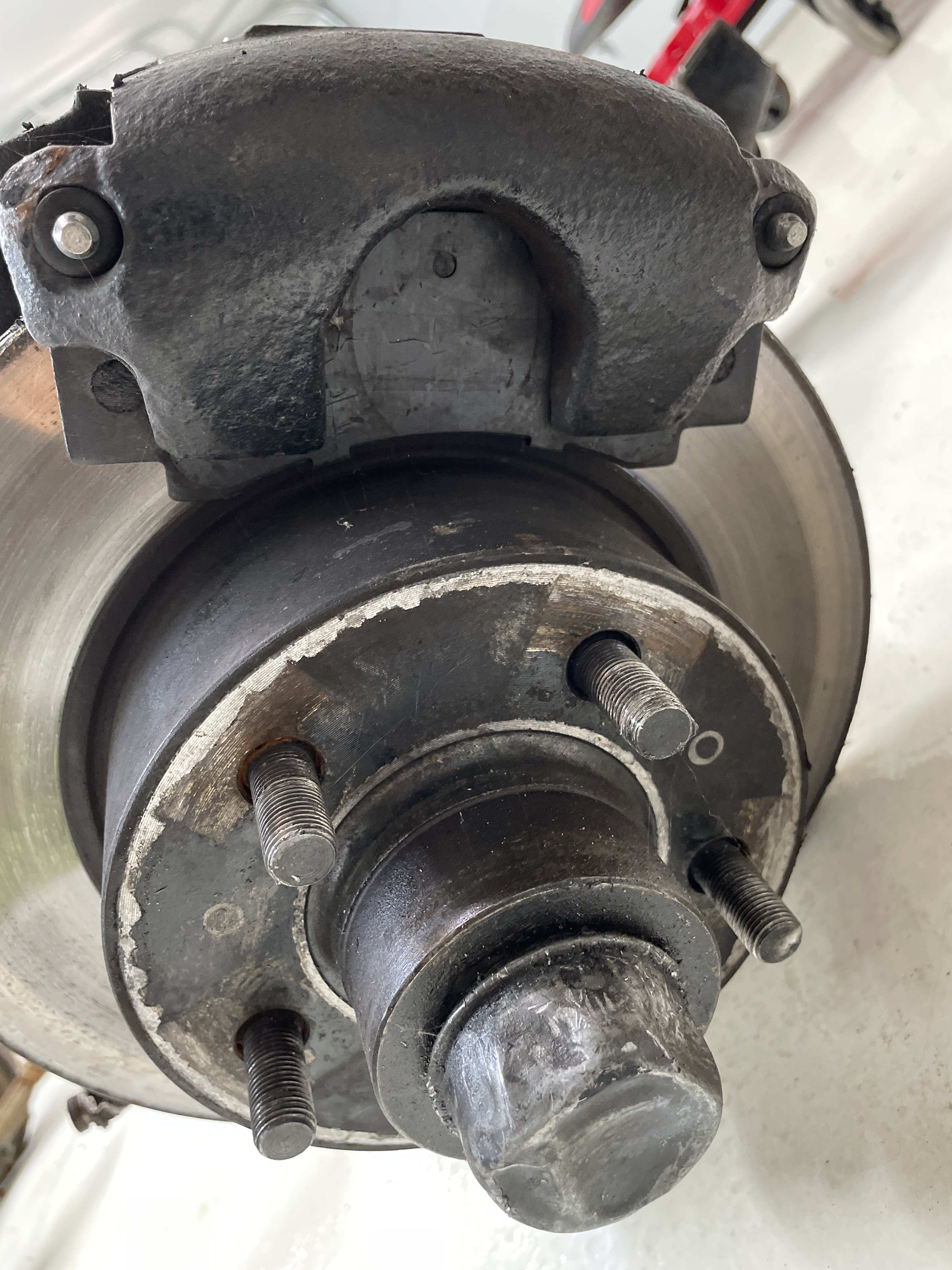

I’m pulling these off of my 1973 Challenger Rallye and I’m trying to get as much information as I can on them before I sell.
^passenger side
^driver side

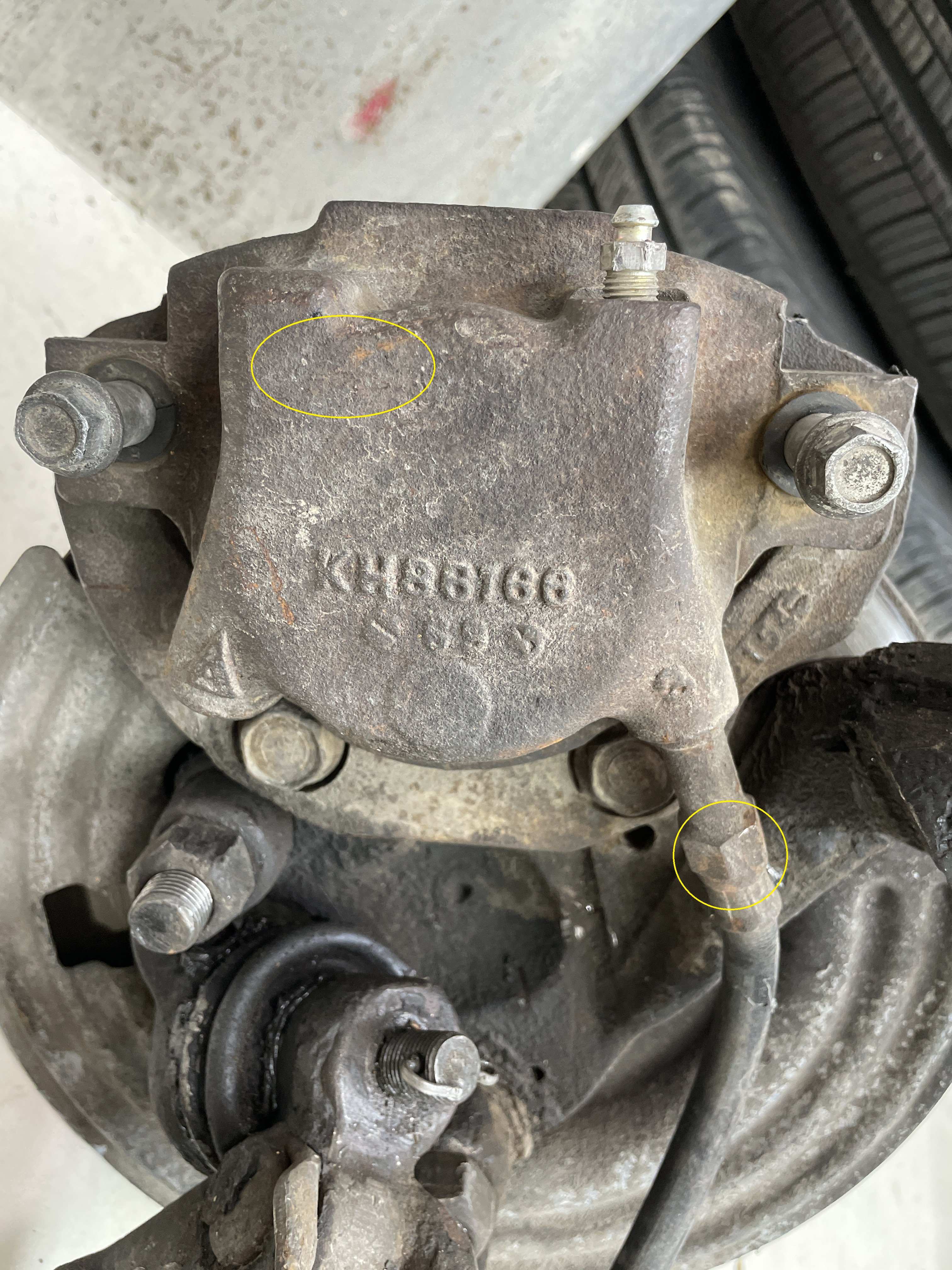

I'm not as familiar with the 1973 Model year as I am with 1970 stuff. With that said, The KH88166 is correct for 1971 and probably later. I added a few yellow circles to your pic showing typical assembly date stamps. The casting date is the 69th day of some year I believe. The aforementioned yellow date stamp format is ddd y (if I recall correctly). Example: 080 2 would be the 80th day of 1972. Your brake hose might have a similar format date stamp as well (location circled in yellow as well).
The caliper mounting bracket appears to have a casting date of 2154 but I'm not 100% sure I'm seeing that correctly? 2154 I believe translates to the 215th day of 1974.
Some of the assembly date stamps can be very faint ... sometimes even a little rust can hide them. If your really curious start with a soft toothbrush or maybe a soft brass brush or 0000 steel wool. Never use sandpaper.

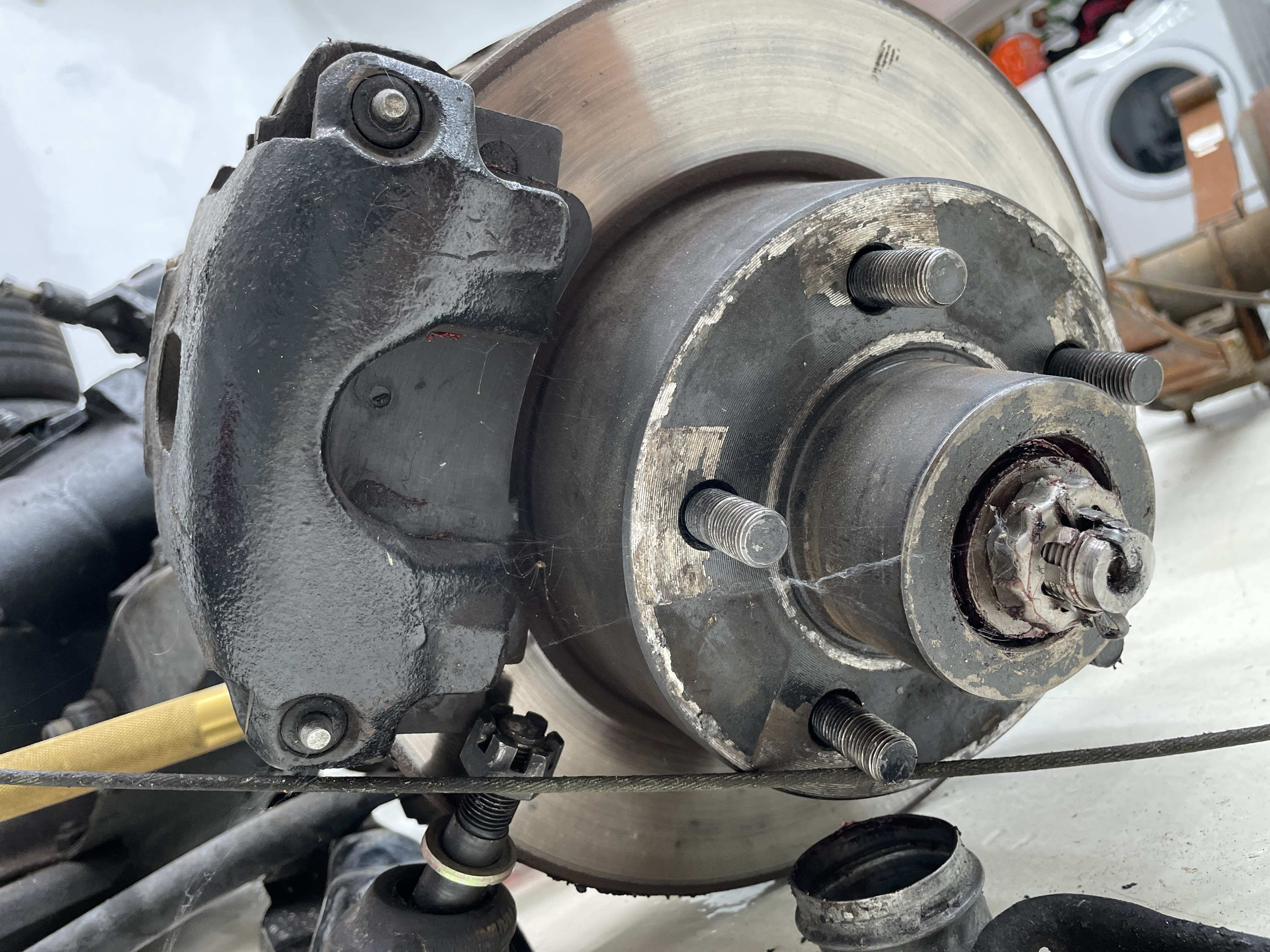

Thank you. Do you know anything about the driver side caliper?
I'm sorry I do not have any knowledge on the other caliper. Regarding my first response, the 1970 E-Bodies also used a Kelsey Hayes caliper however the casting number was 80012 which leads me to believe your KH 88166 might at least be correct casting number for your year car but I don't think we can determine if it's original to your car without an assembly stamp. Hopefully someone more knowledgeable than me can confirm.
Mr Cuda
Jan 26, 2022
320
163
North of Seattle
You did not win todays lottery.
Your cailpers are 71-74 E or 71-2 B.
So it's safe to sell them for whatever the going rate for disc is.
The wavy galvanize splash sheids show them to be 73 up.
The 69 cast in number was confusing the issue.
Gumby
Jun 28, 2022
129
10
Lakeport, CA

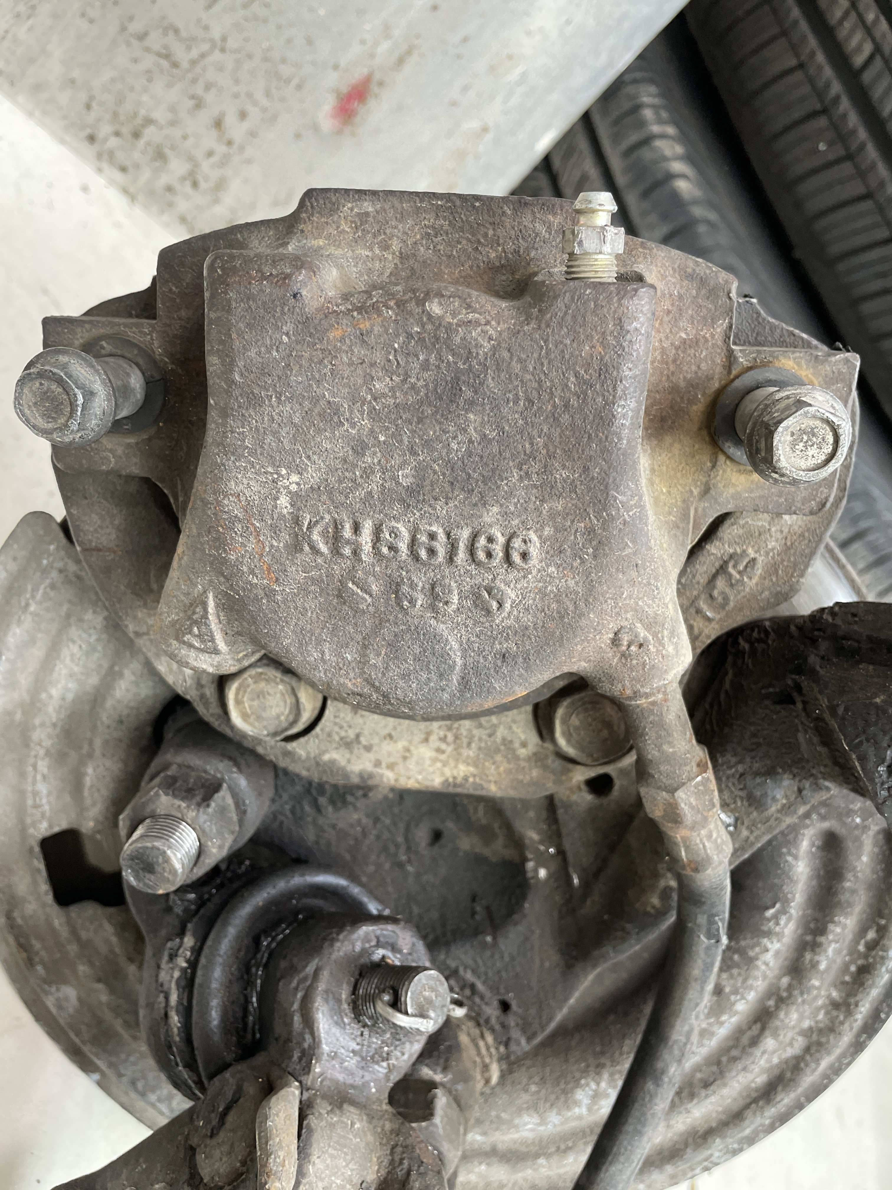

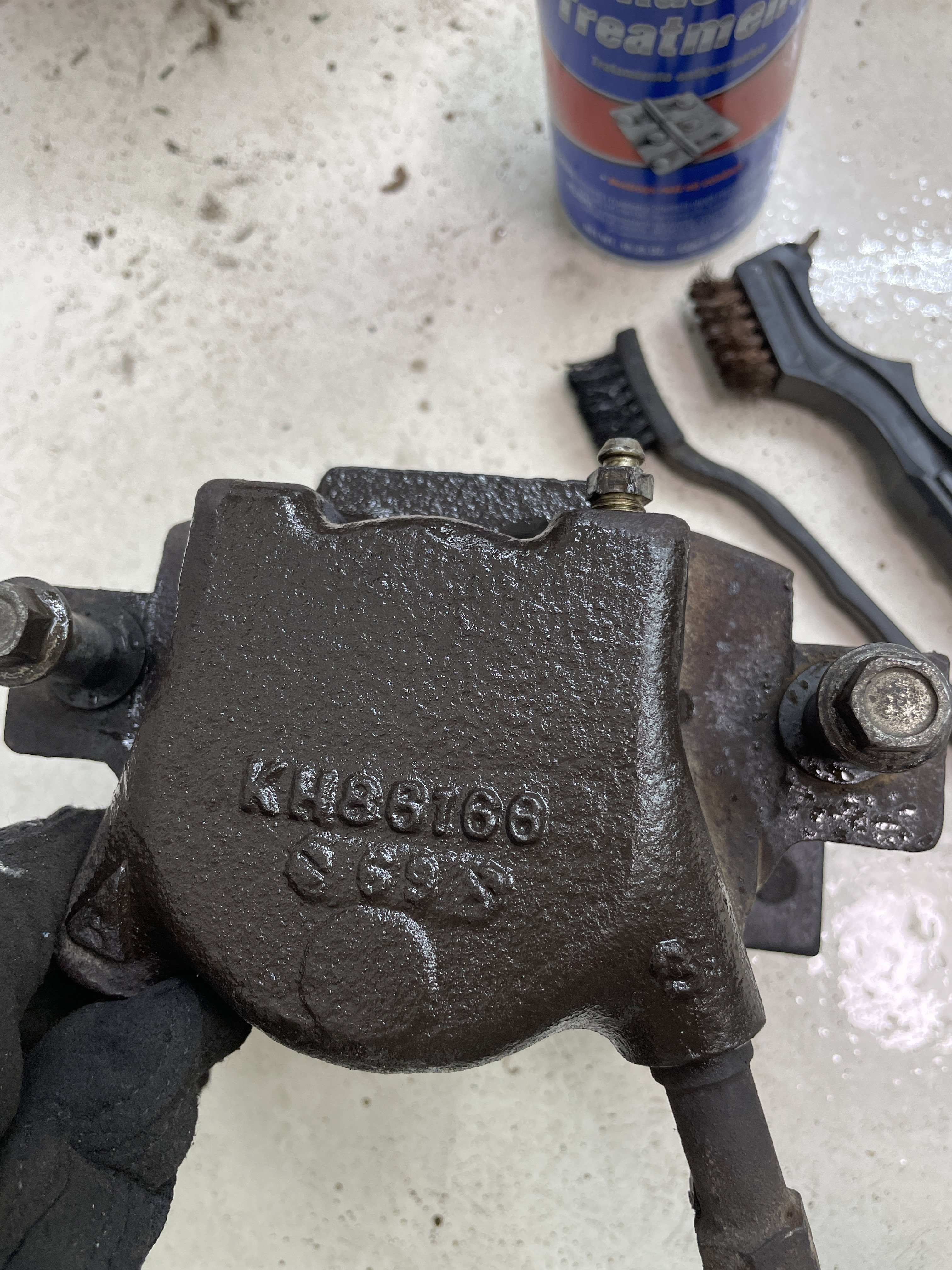

I’m just not seeing any remnant of a stamp in the upper left corner of the caliper face. Do you think that ‘3’ on the bottom right represents the year while the ‘69’ is the day?

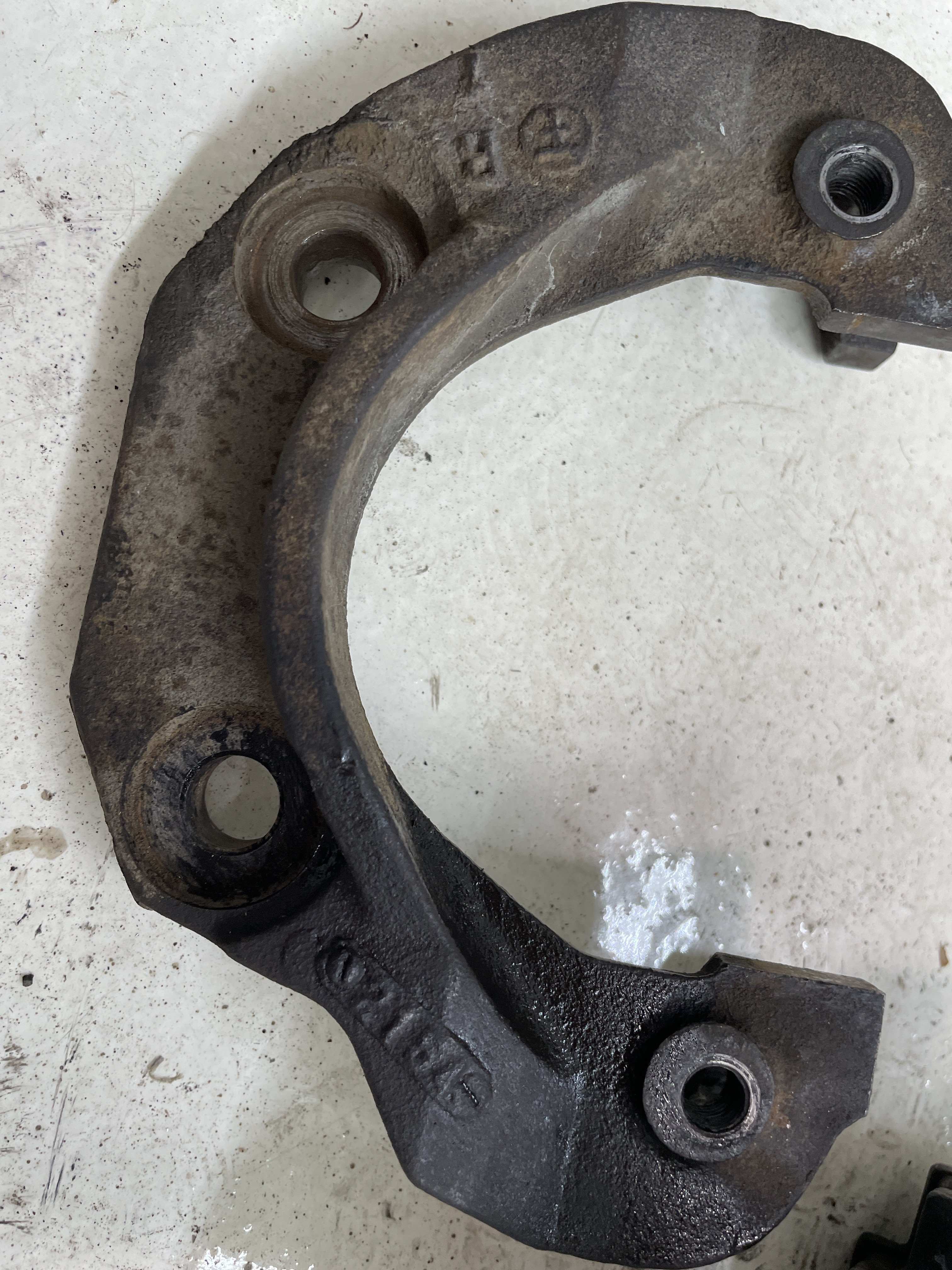

@Gumby
The date stamp on the passenger side mounting bracket is definitely 2154. Are you sure it doesn’t mean the 154th day of 1972?
Gumby
Jun 28, 2022
129
10
Lakeport, CA

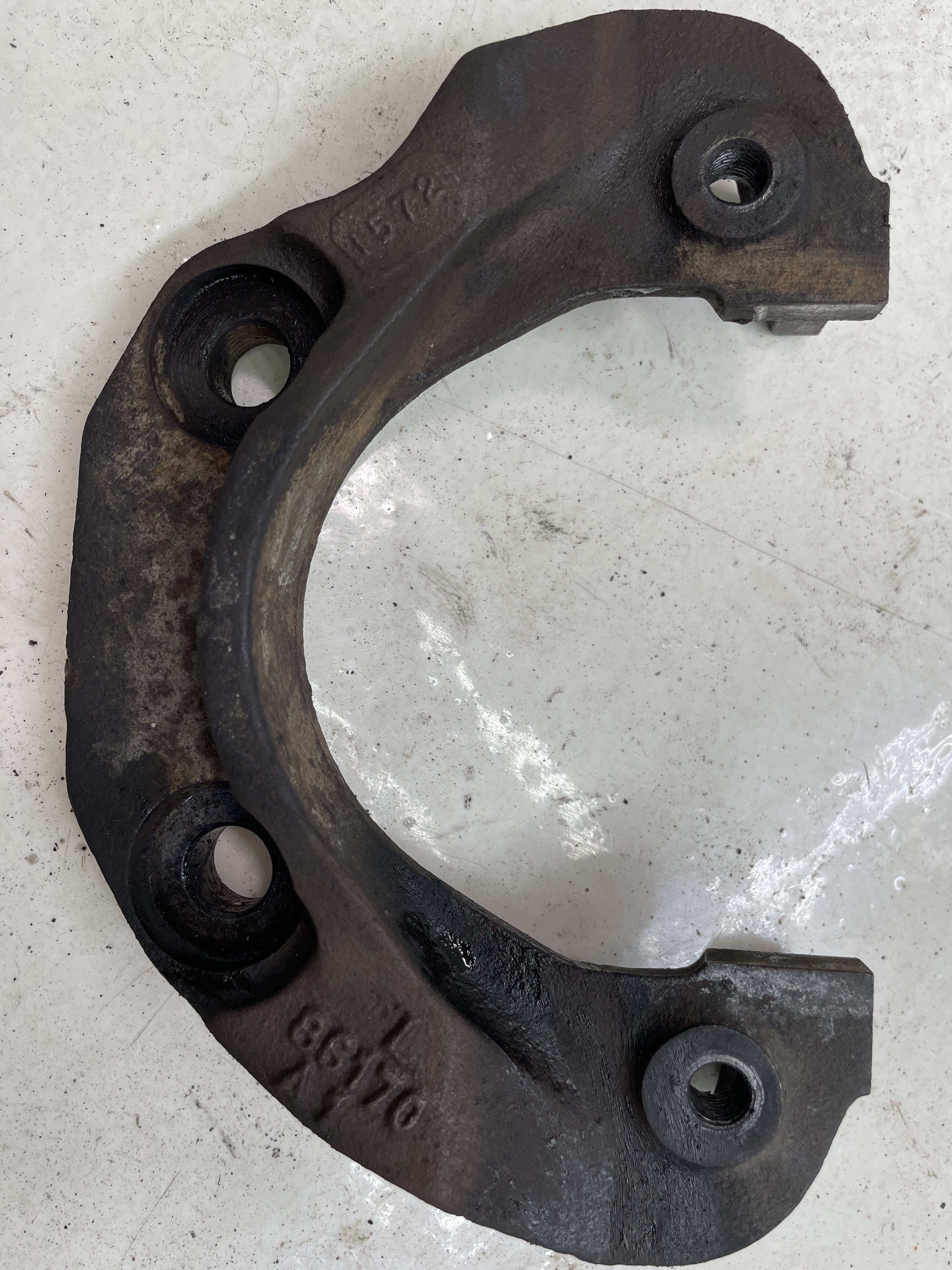

The driver side mounting bracket is stamped 1572 for the date, I believe, and
L
86170
A1
Anyone know what these stamps might mean?
tullm
May 26, 2022
39
7
Herndon VA
"Do you think that ‘3’ on the bottom right represents the year while the ‘69’ is the day?" My best guess is the markings on the left and right have something to do with the foundry where they were cast but you could be correct. Sorry I'm outside my small, narrow zone of knowledge.
"The date stamp on the passenger side mounting bracket is definitely 2154. Are you sure it doesn’t mean the 154th day of 1972?" My assertion regarding the 215th day of 1974 is based on four digit casting dates on other parts but I could easily be wrong. Some parts use a 10,000 day calendar format but 2154 seems way too early for 1972 or 1973 model year.
Hopefully someone can give you better info than I can. @Mr Cuda knows this stuff way better than I do. I tend to search through lots and lots of threads searching for answers and then I forget after a month or so.
tullm
May 26, 2022
39
7
Herndon VA
"The driver side mounting bracket is stamped 1572 for the date, I believe, and
L
86170
A1"
'L' is Left side.
86170 casting number must have been used for a while, I see references to that casting number on some of the Dave Wise reports 1970 E-Bodies. The 1572 means it was cast the 152nd day of 1972
