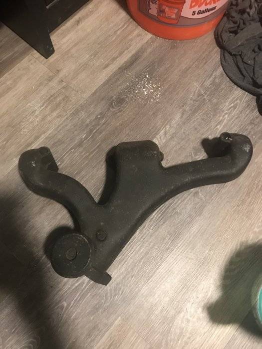

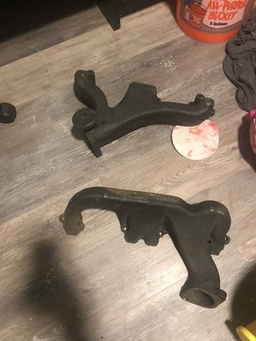

hello I picked up a set of 340 hp manifolds a couple years back. They came with a 6 pack set up that has been verified authentic 340 oem stuff
I can only find casting numbers on the pass side and they are 2863549 with a L1 below that. Does look they were sanded down and painted at some point.
I guess I am looking to verify they are actually hp manifolds. What would they have been on. And what color / paint should they be finished with
tonysrt
Mar 12, 2017
619
194
The lower one looks like a 2863553 which would be the 68-70 340 exhaust manifold as is the other one also.

These are the correct 1970 factory casting numbers for the exhaust manifolds as per Roseville.
340 1970 Challenger / Right 2863549
340 1970 Challenger / Left 2863553
Cudas used the same manifolds in 69-70
The above manifolds were also used in A bodies
Here are the other 340 Mopar casting numbers for the manifolds:
340 1969-70 Dart / Right 2863549
340 1969-70 Dart / Left 3614368
340 1971-72 Right 3148623
340 1971-72 Left 3418621
340 1971-73 Dart / Right 3418623
340 1971-73 Dart / Left 3614395
Your manifolds look correct. Here is a set that Blue Star is selling for a comparison:
