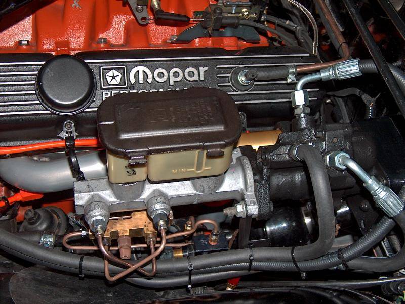

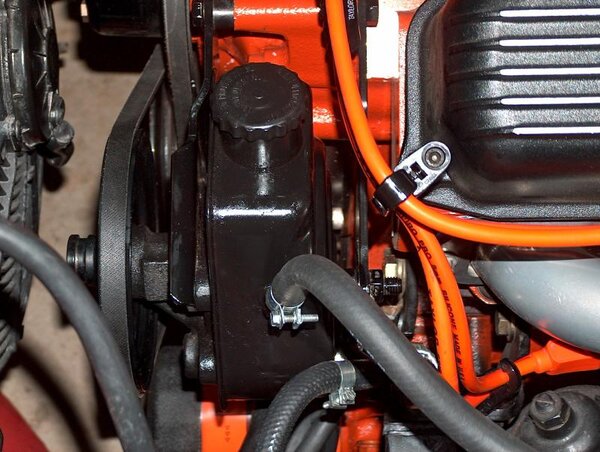

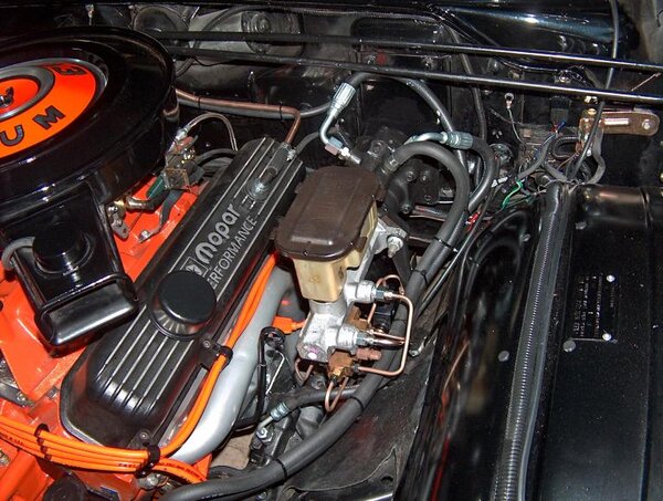

Here's mine. Because it was off a HD diesel pickup it's somewhat larger than a unit off a Saffari or Astro. HPIM3688.jpgHPIM3687.jpgHPIM3686.jpg
