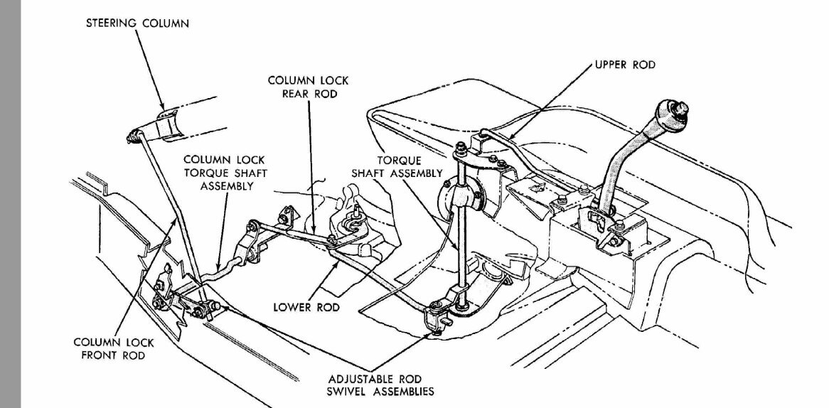

It sounds like the ’70 floor shift lock-out linkage is missing yet still running the ’70 column. Highly recommend either restoring the missing linkage or replacing the lower collar and shift tube with the later (’71 & up) spring loaded lower collar floor shift. The whole point of that system is to allow the steering wheel to lock, key removed, only in park, or reverse for a 4-speed. No linkage, the collar can allow the wheel to lock while in motion should a shutdown be required while driving.
I can lock the wheel after removing the key as usual. Turn it slightly and it locks.
I have the slap stick shifter on mine, having replaced the ball shifter.
The point is, for the 1970 column, you should not be able lock the wheel and/or remove the key in any other gear selection than Park on a floor shift auto or reverse for manual shift. If you can, the linkage is missing, and a potential safety issue exists as per the original design.

Its the steering column lockout assembly. Designed to lock the steering column and prevent the shifter from leaving park when key is removed. A set of linkages will set you back about $250, and be aware they are different for 4 sp vs auto.
