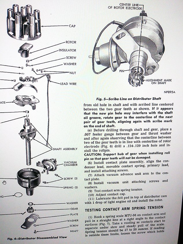

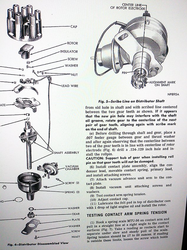

If you remove the distributor and turn it over you will see where you can loosen a bolt to change how much "swing" it has. It may be possible to change this to get you where you want to go.
So if the dist hold down bolt goes through this plate thats a factory limiter. I wonder why they did that???

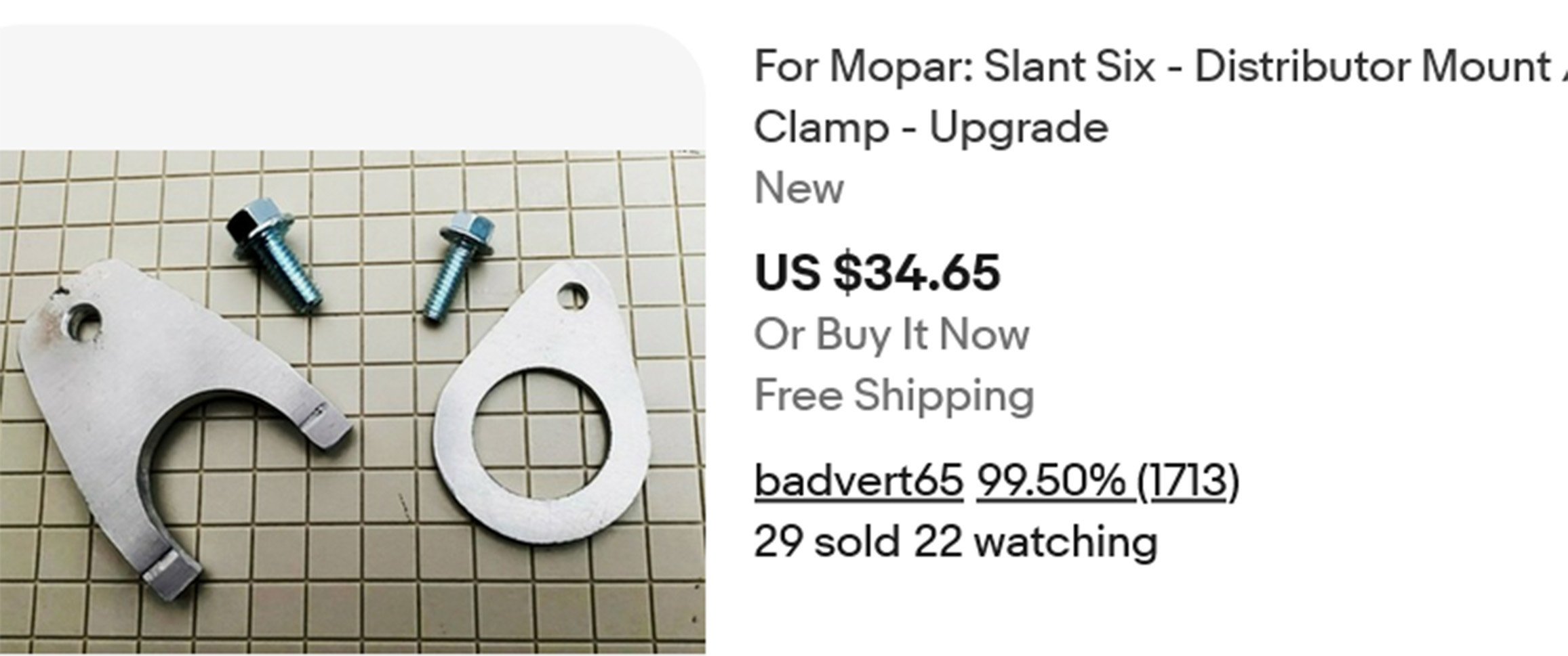

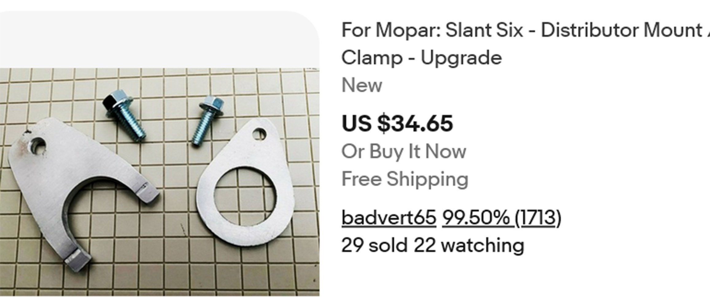

If for some reason its "pegged" out to where more timing isn't possible, I found this on e-bay.
I may be wrong, but seems to me if you cannot adjust the plate for more advance you might simply be able to move the spark plug wires one over and readjust the plate back all the way and start that way. Would certainly be cheaper than buying a "fix" like this. Just a thought. Maybe someone with more /6 experience could chime in.
Depends where that factory plate on it has been set? It could already be maxed out. I wont know till I pull it.
$35 bucks is nothing.....Chump change in this past time/ hobby...lol
